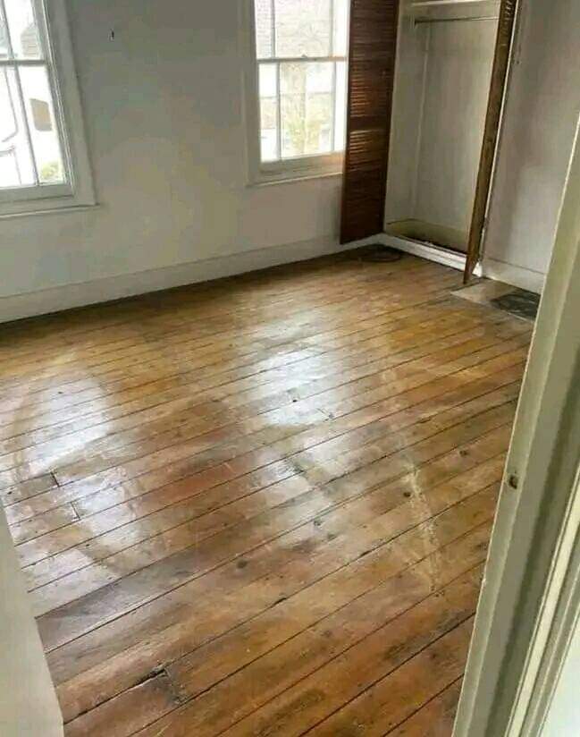

116,016
I got called out to find out why a carpet was refusing to dry, we had to pull it up to get the answer....
