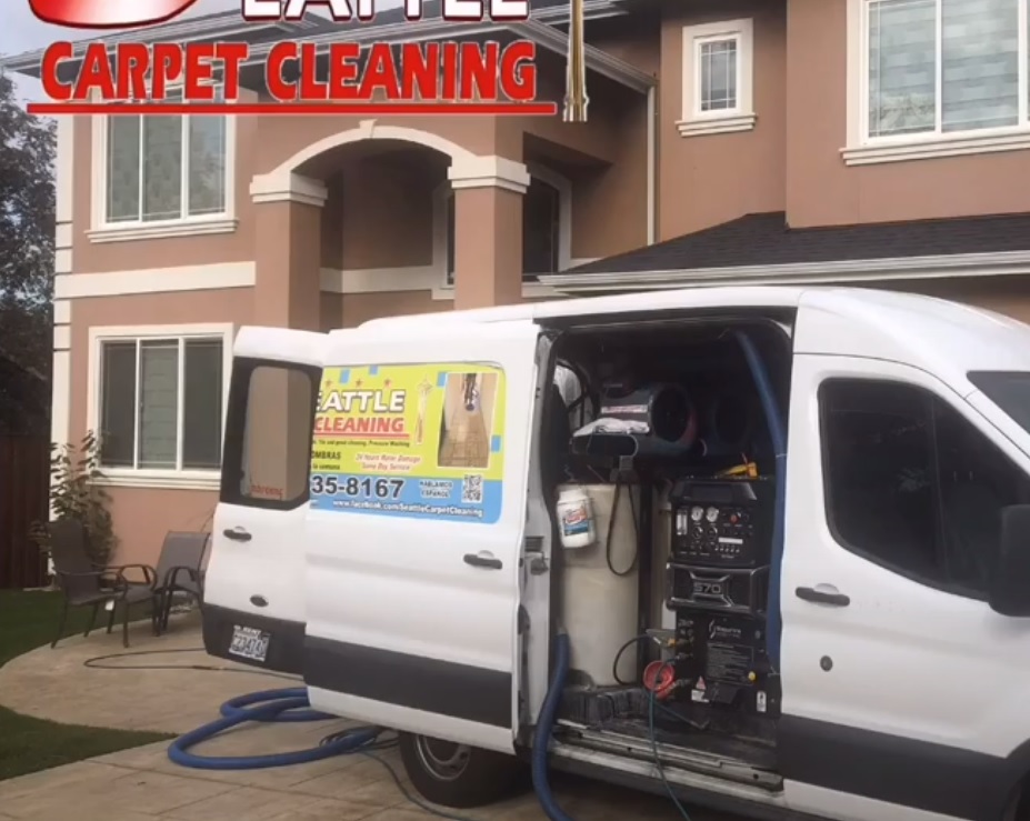

The real deal is a homeowner doesn't need or want to see a sauna. Its carpet cleaners that want to see a steam cloud.
A homeowner not knowing any difference thinks you are using live steam, and is concerned of the potential damage you maybe causing to the carpet, wood floor, drapes, upholstery. Not to mention fogging up all their windows, to the point of sweating.

I didn't see any dry passes, not correctly overlapping the previous wand passes, and thinking that showing the steam in the freezing cold room was worth something. Plus, the picture above with the van shows he's parked about 15-20ft too close to the house (carbon monoxide)
This is one of the dangerous parts of our industry
Since that room is freezing cold, I'm assuming there's no power to turn the fans or heat on to help it dry. That floor is ruined

So many mistakes...where do you start.
The hose maintence alone makes me arrr.
