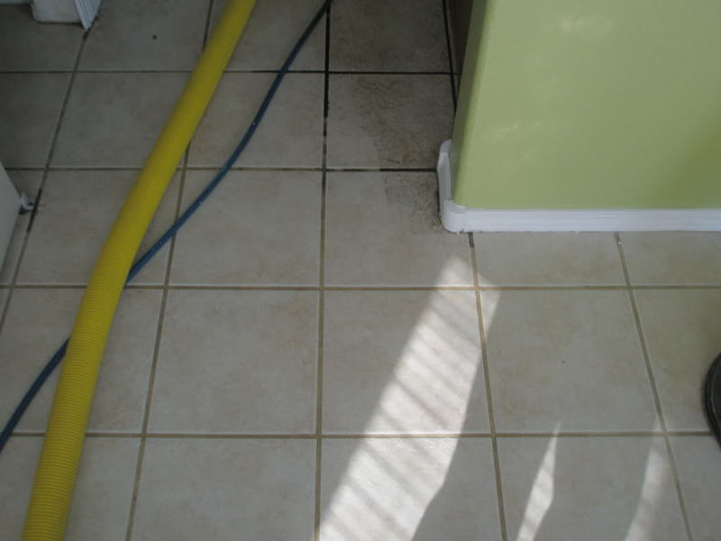

looks great!!
a few questions for ya
do you brush the grout lines?
are you running the brush ring on the tils mach? does the machine have a plastic ring you could?
if so do you prefer the brush ring? if so why?

Wow, that was dirty. Send me some more pics so I can put on my blog......
I have used O2 several times, but my juice of choice is prochem acid mixed appropriate to grout condition with 2-3 oz/gal of citrapure. I used this side by side yesterday with two other combos and it won out easily.
Dave, Mikey sold me on the brush ring about a year ago. I had only used it once and didn't like it. So I kept the teflon ring on it until I did a solid surface and needed to change it. Never changed it back yet. I do like it better. Main thing is you can soak the floor down with juice and it helps pick up the extra liquid. Try it, you'll like it.

Lots of flecking of some sort still in that grout.
Color Seal time.

with the vacuum of a Vortex the tool can be easier to move with the brush ring

no scrubbin on this one and I do like the brush ring never tried the other but for doing stone the brush is better i would hate to scratch a floor.
that floor was 1 yr never sealed

the tool does not have a vac relief valve and slide grove on the handle to help with the vac pressure?
ron do you not usually scrub or was it just on this one? if not is it because the pressure you are cleaning at or the chems you are using?

Most tile jobs i dont scrub just use a good dwell and a well formulated tile cleaner or jj I cleaned that one at 1000psi and the tool has a vac slot
