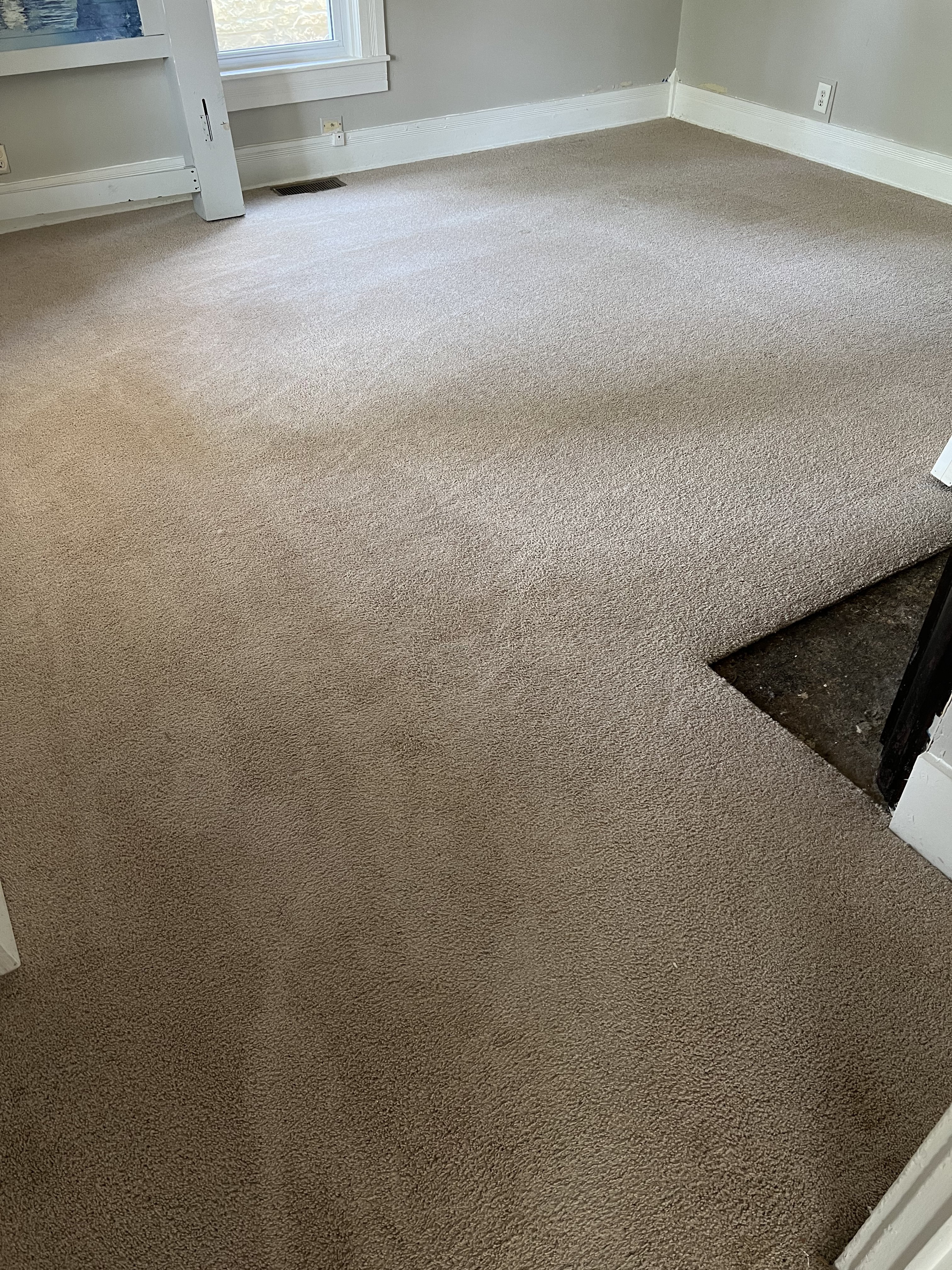

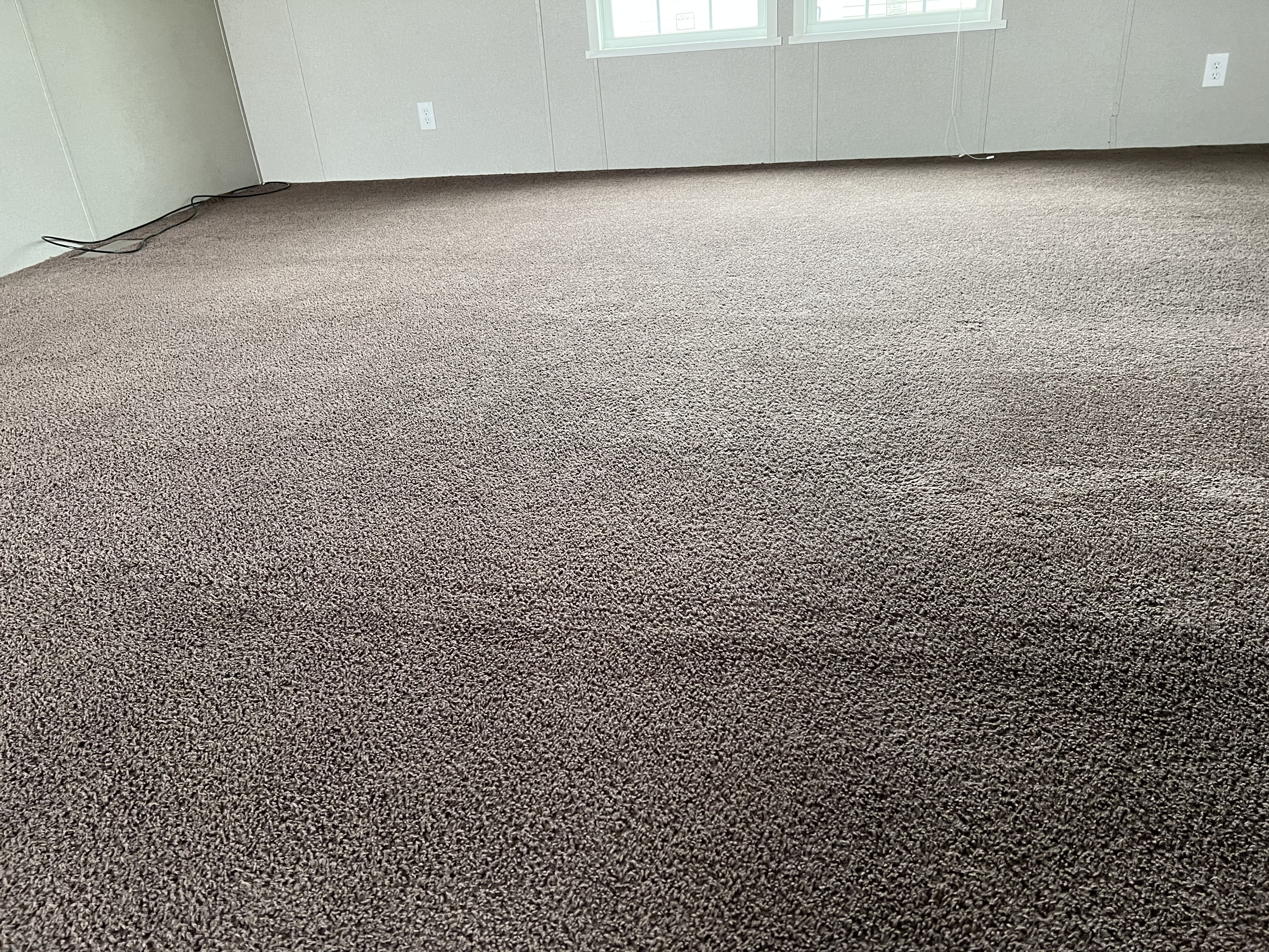

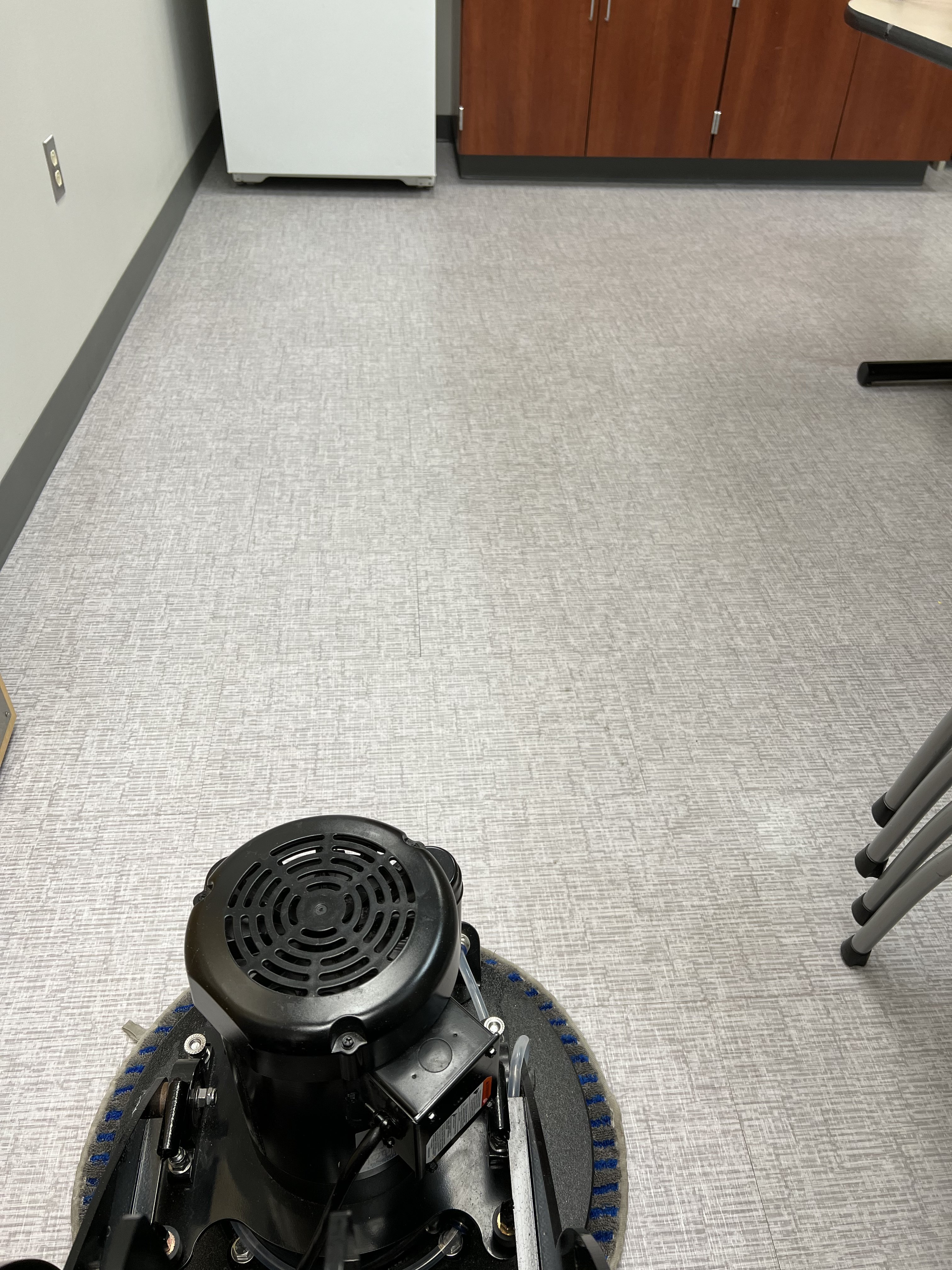

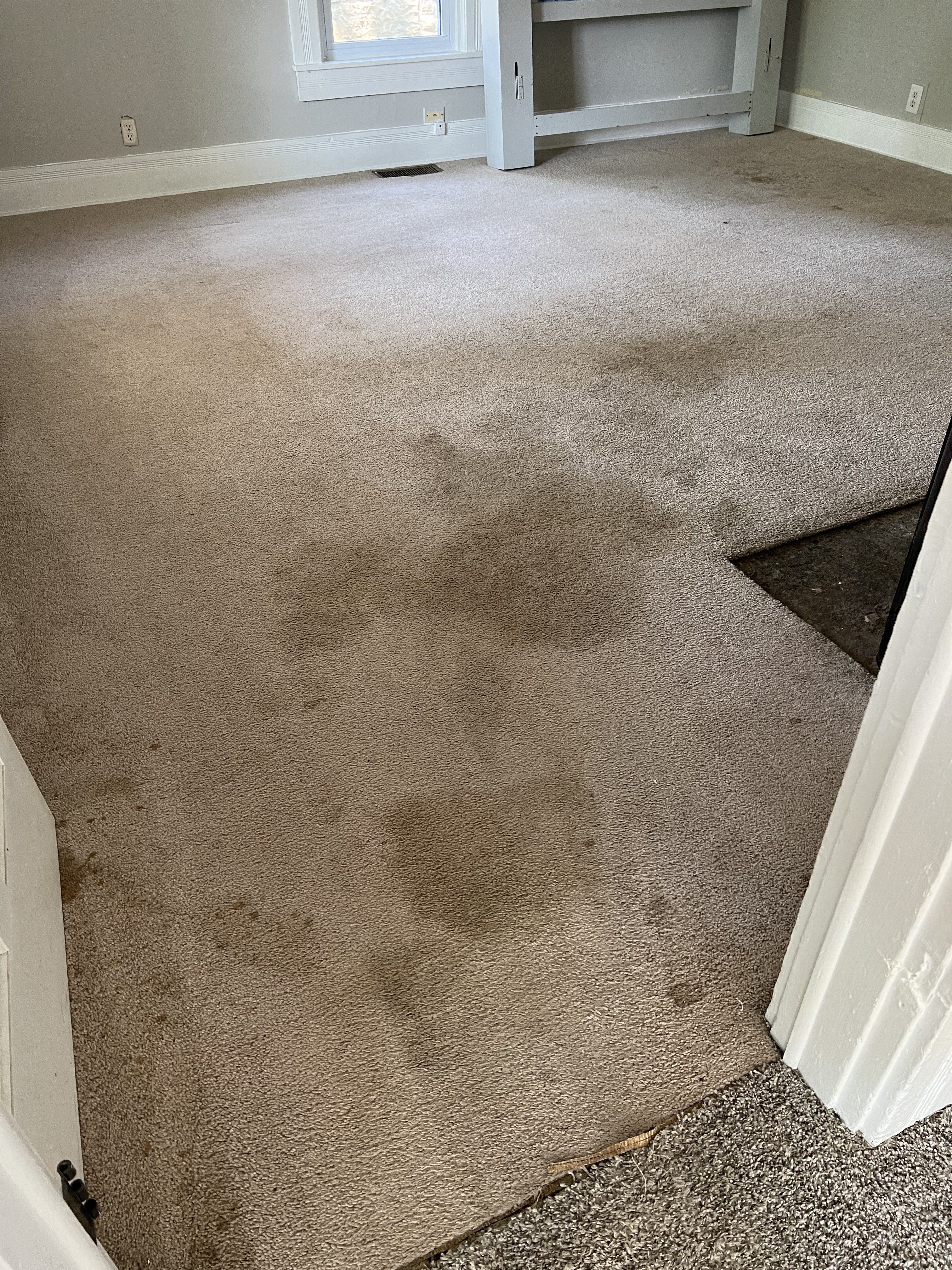

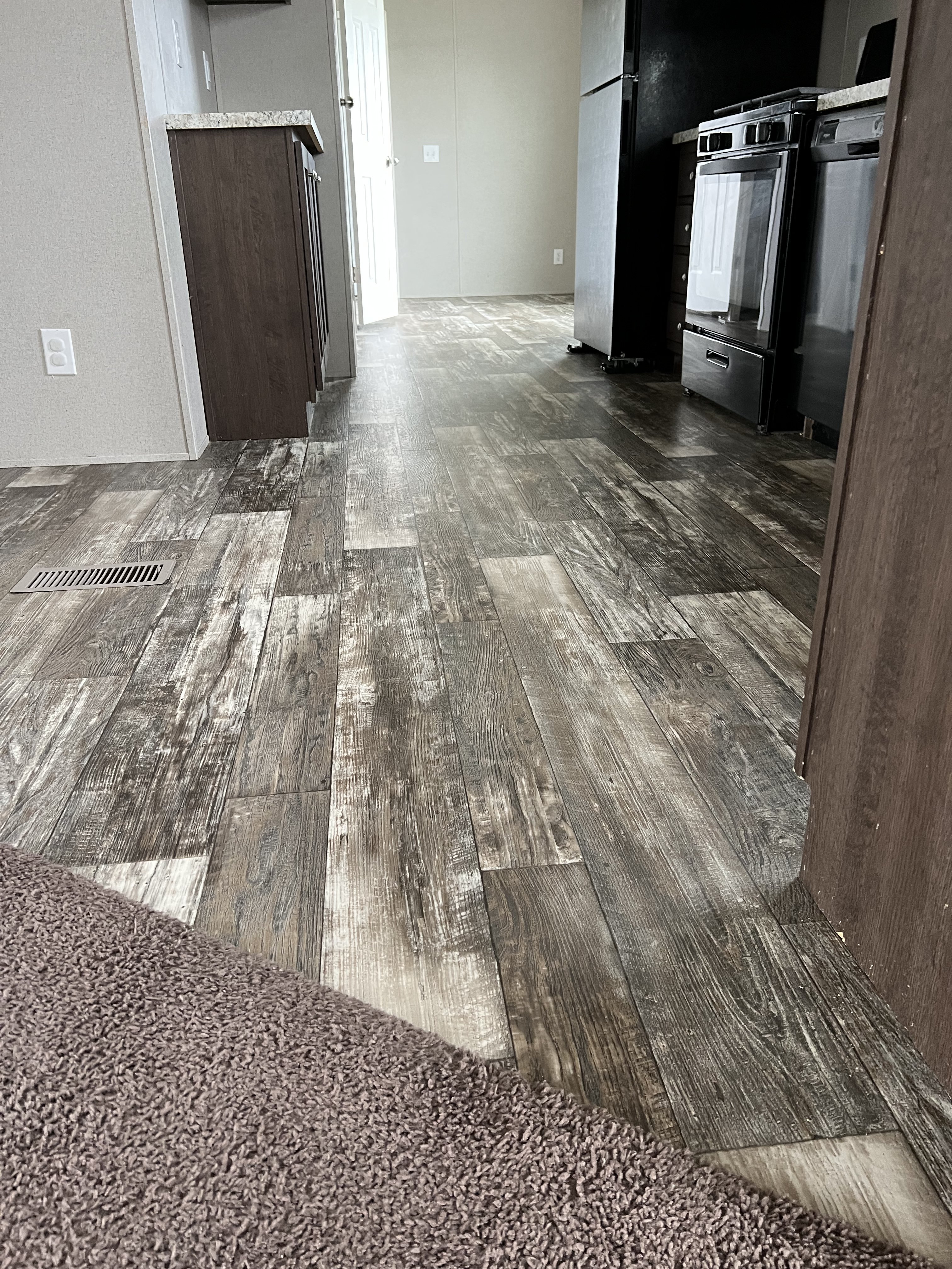

We used the Phoenix and Cimex today in an empty trailer. Cimex on the carpet while I used the Phoenix on the sheet vinyl flooring. Then I went over the carpet with a blue micro under the Phoenix to finish up.
It’s quite versatile. I’m also thinking where this machine truly shines isn’t necessarily carpet, but the LVT/LVP/sheet vinyl floors that have become so popular over the past few years. It chews through that stuff like a buzzsaw. One pass with an appropriate floor pad and a small spray of neutral cleaner every other step, one pass with a micro to pick up the slurry. Finish with a flat mop.
Pics from today, a rental from last week, and some vinyl tile. All using the Phoenix, except for today’s where we incorporated the Cimex on the carpet to save time.
One negative I will mention, I had a carpet that was a shedder and whoa… it was a little concerning, but turned out ok.

Didn’t noticeably shed when I vacuumed it, when I saw the little balls of fuzz everywhere I thought I might have ran into a wool carpet (in a junk rental house…). A quick burn test showed it was synthetic.
We ended up vacuuming afterwards (carpet was dry) and pulled two cans out of about 1100ft2.

Won't the thumping action of a Trinty damage the seems of thin engineered flooring?

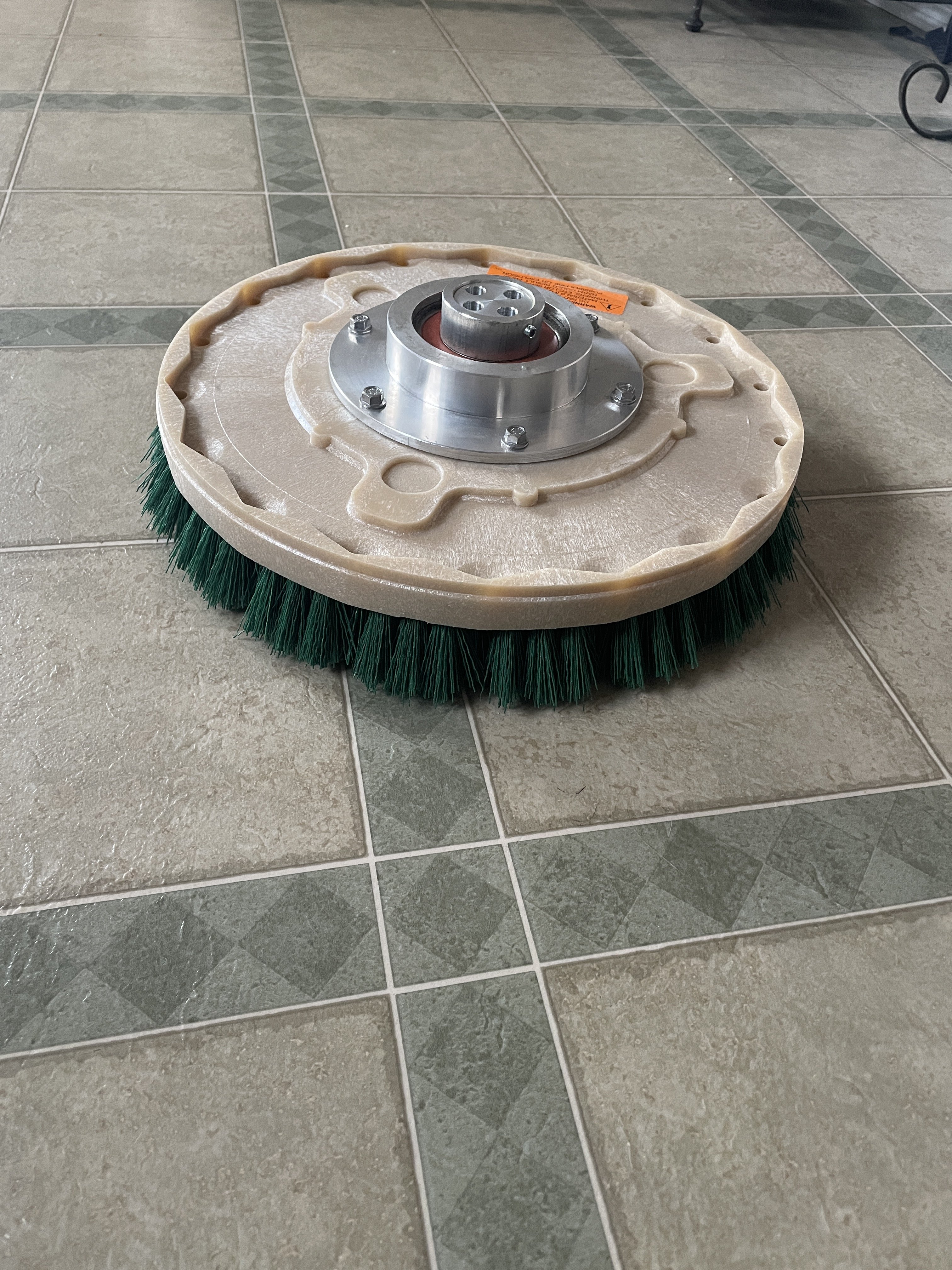

Would this brush attachment be the best for LVT? Or is there better pads that are used with the standard driver for the Odyssey?
