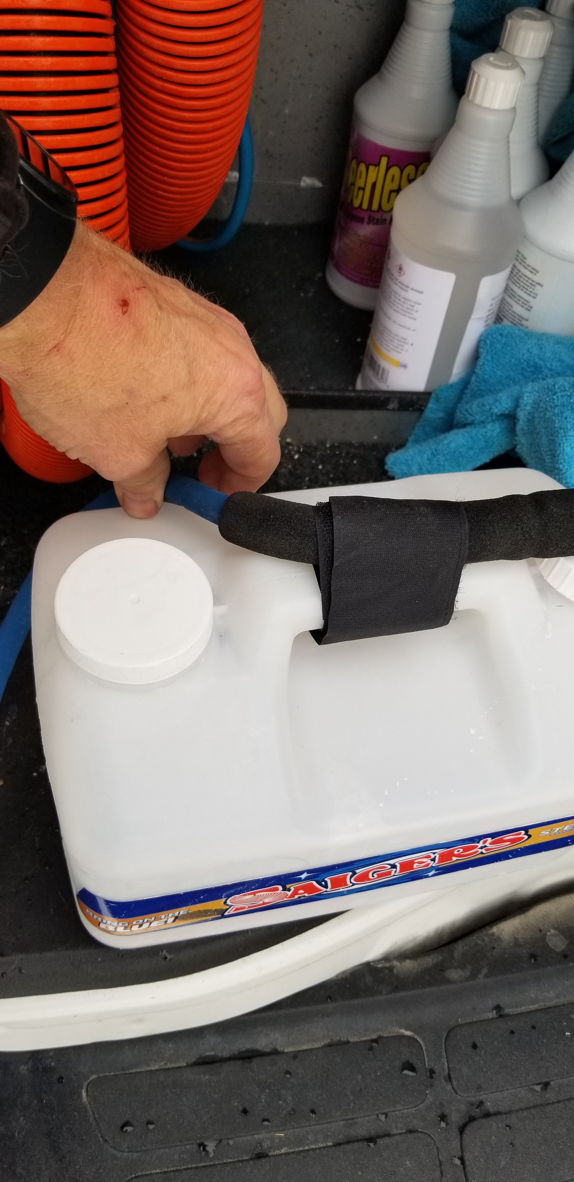

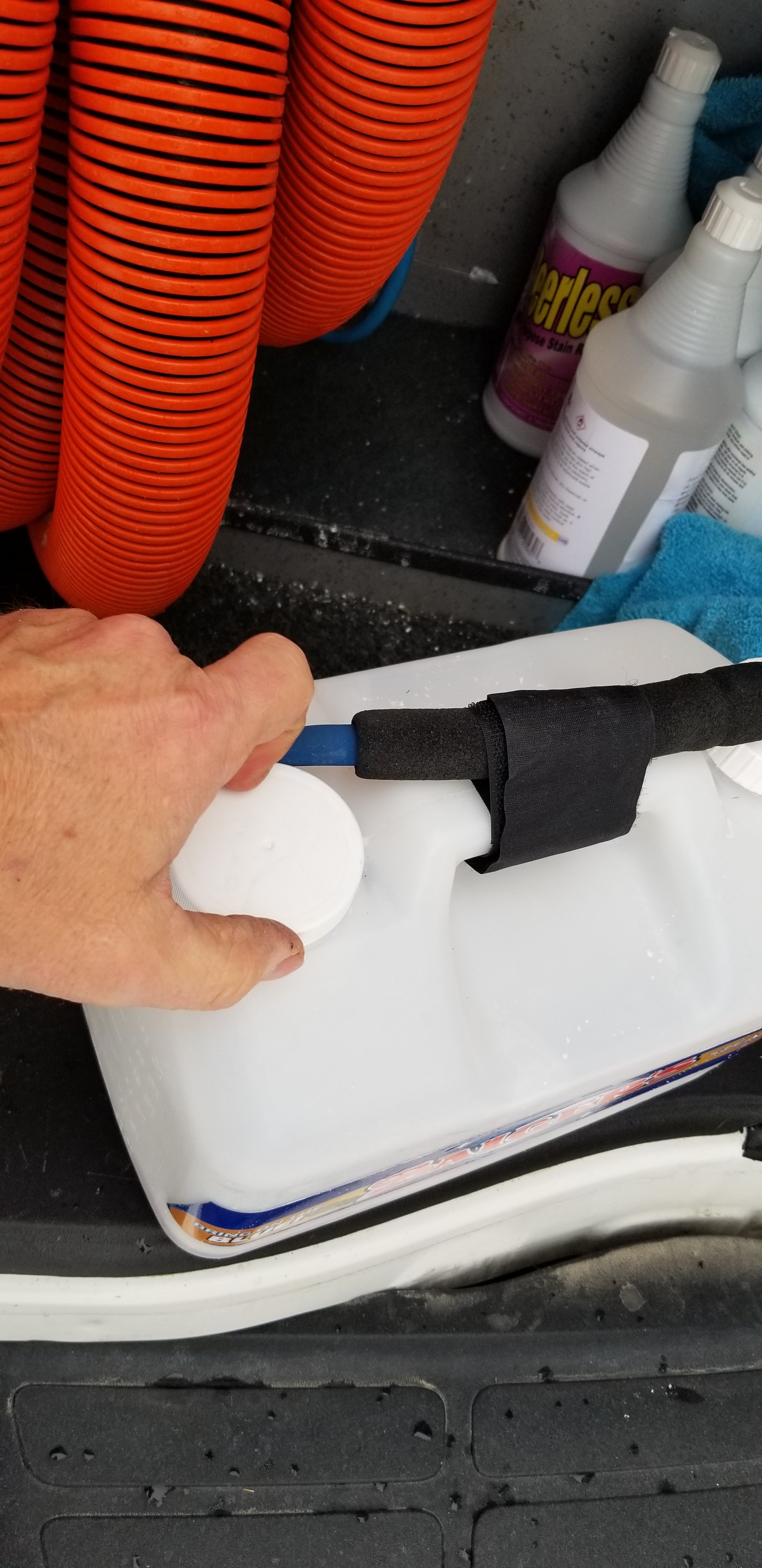

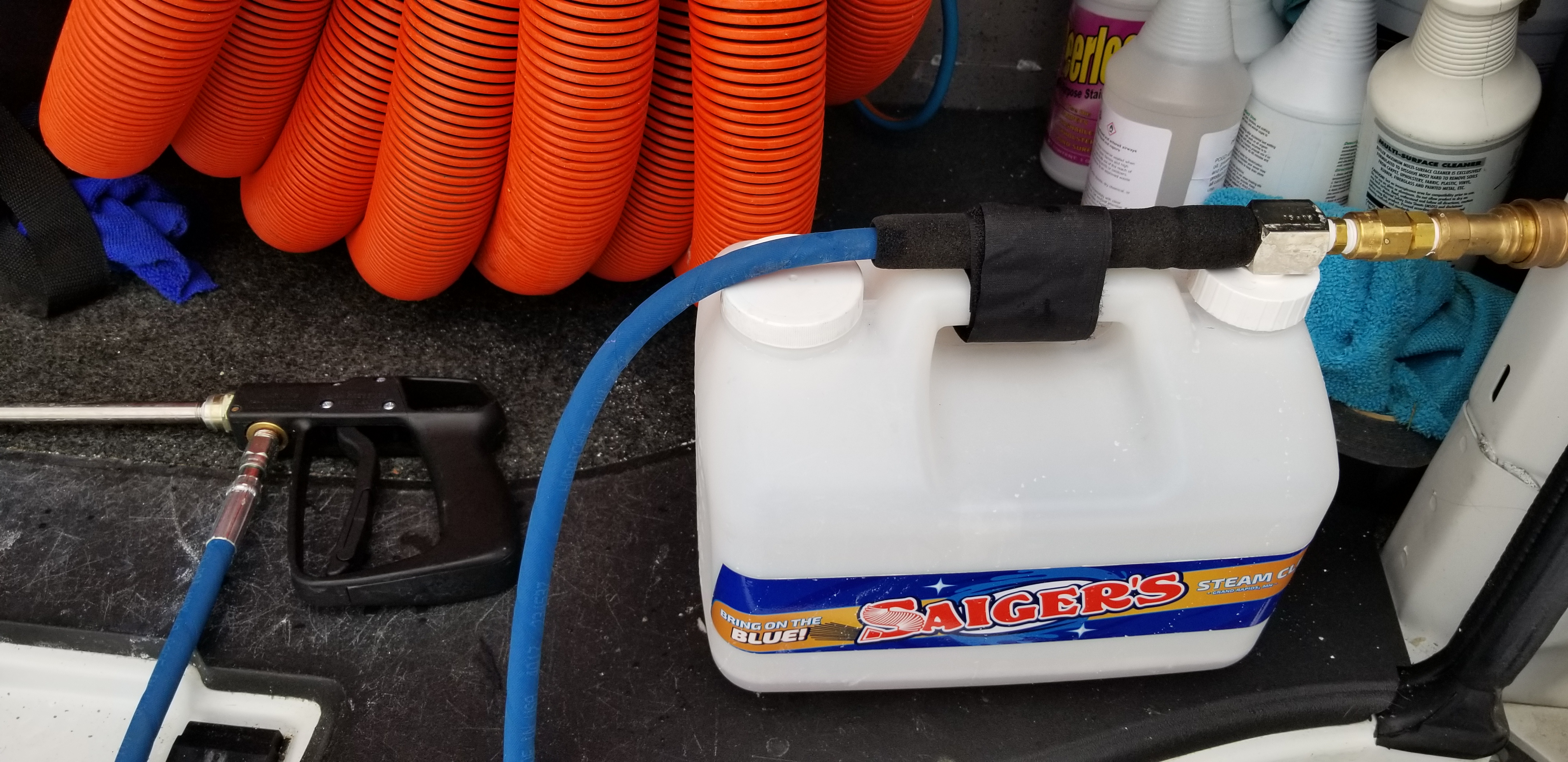

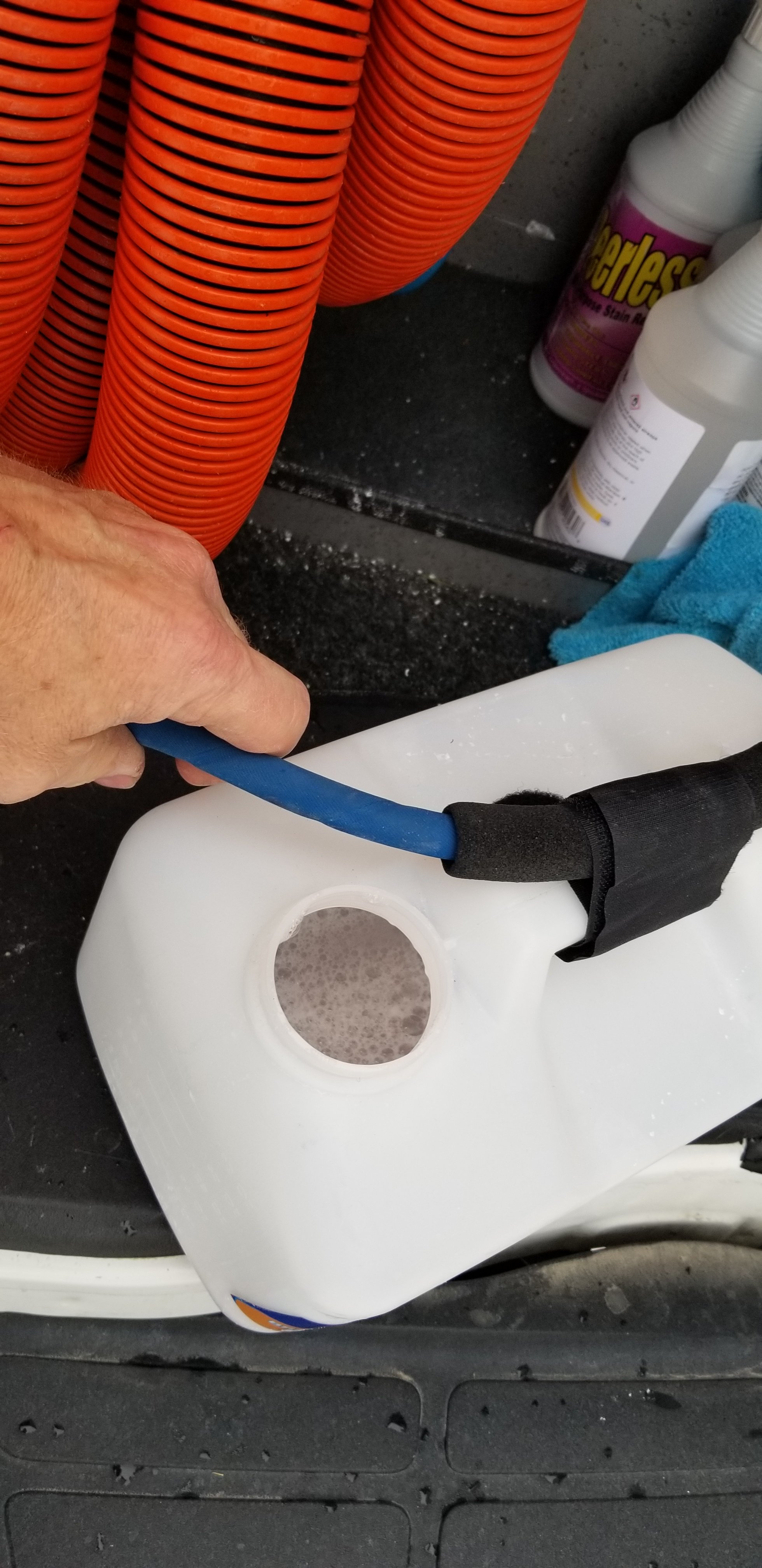

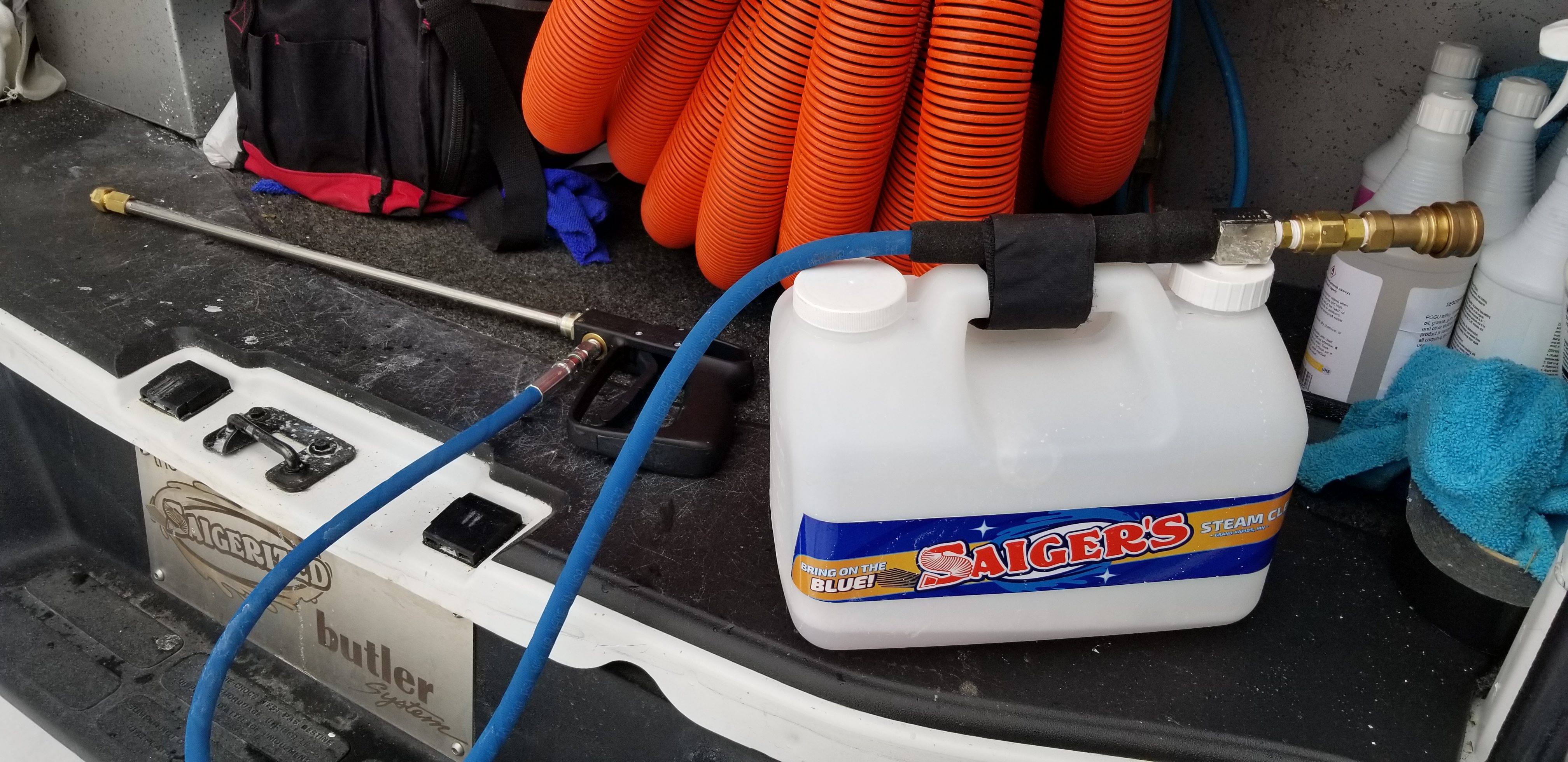

Taking out the hard inline brass tube??? Are you referring to the tube on the handle or some tube inside the dema valve?
Yes...that's what then did on the six quart units. If look in pics, easy to get to the large opening now because the rubber hose will move off to the side.
I get mine from Barker-Hammer in Minneapolis, MN.
They are just down the road from Multi Sprayer and a distributor.
https://www.barker-hammer.com/
You would have to call them if you wanted the six quart....I don't think they advertise much on their website

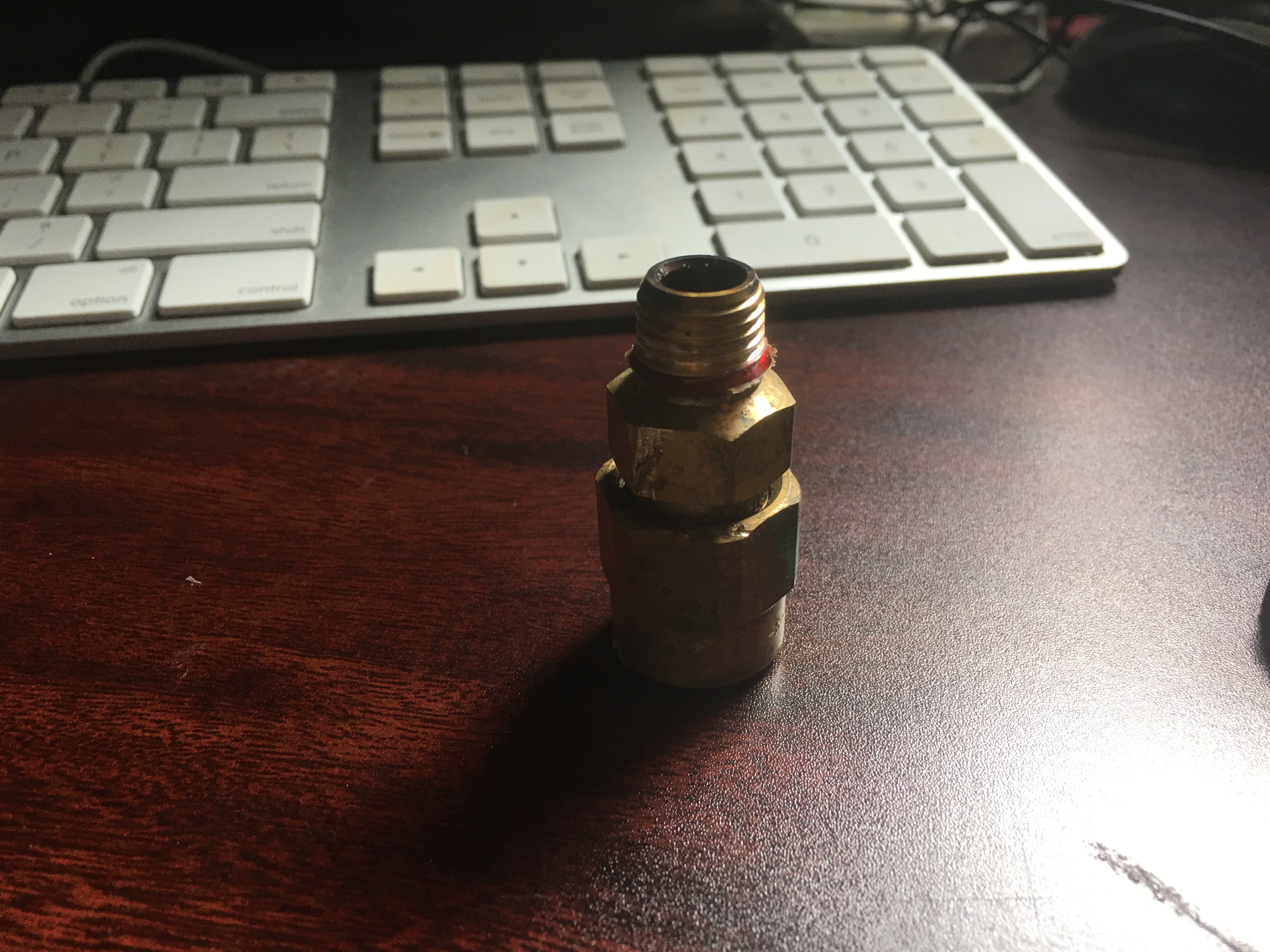

Amazon product
https://www.jondon.com/injector-valve-complete.html
https://interlinksupply.com/index.php?item_num=NA0809A
Can you give me a good reason why there's so much of a price difference? Interlink and Jondon never gives any description of it being made in china or local american. There's a $30- $70 difference, and I've had bad luck with both. I don't mind spending that kind of money. But every 2-4months when they go bad on my end...it gets annoying. Which of the 3 is best?
The cheap one is going to make you angry and make posts about them :biggrin:
The ones from JonDon or Barker-Hammer in MN I know are the Correct good Dema Valves made in St. Louis.
