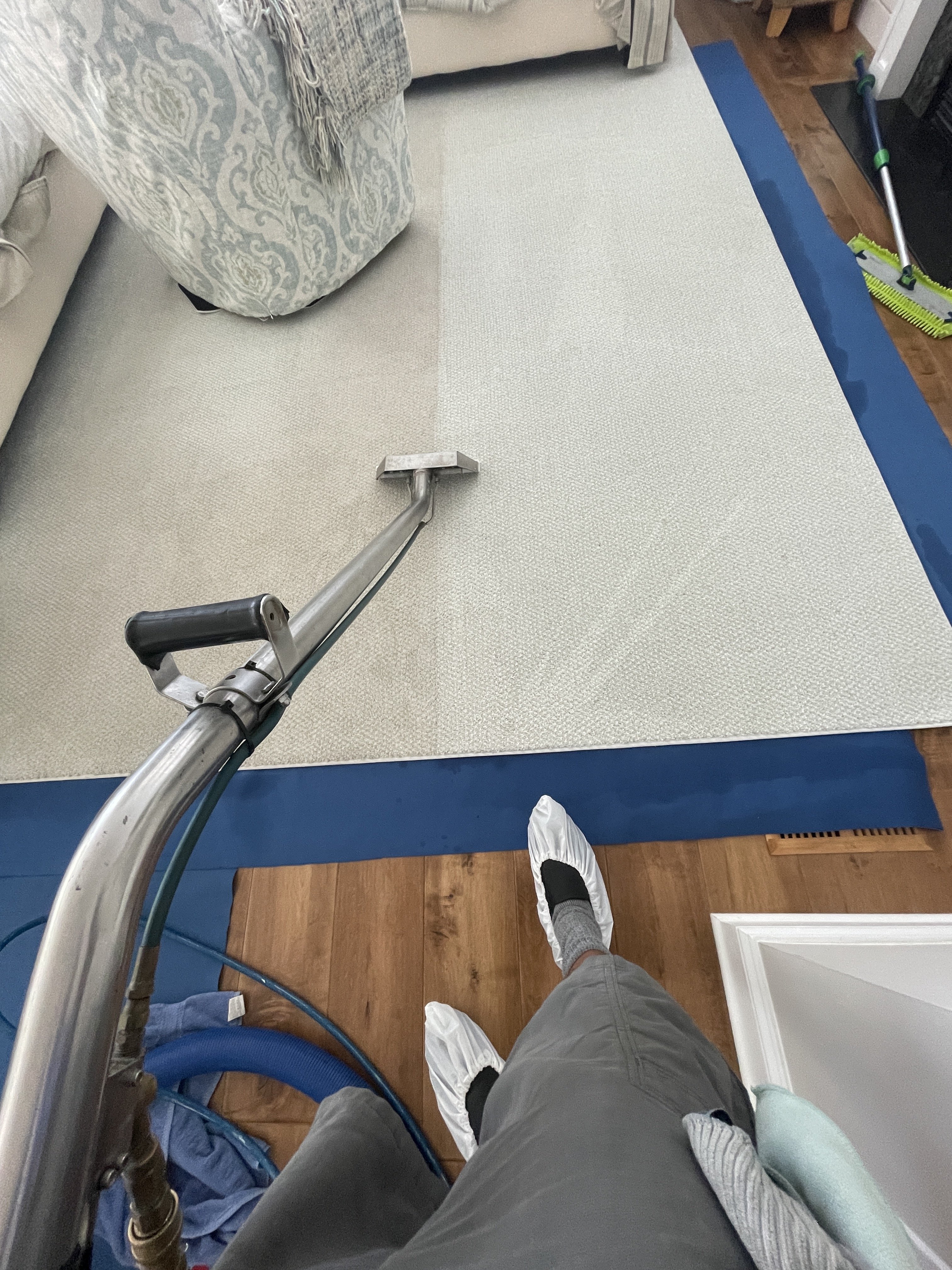

New to VLM, full disclosure, but If mixing 2 (two) oz of Pad Cap Pro into 2 1/2 gallons of water for hundreds, at times a thousand sq ft of carpet, how can that little leave any concerning amount of residue?
And before I VLM, I vacuum "toxic" pre existing residue like no other house cleaner has ever done. Its what we do.
Sure a hack VLM job could end up to be gross with residue, but a hack HWE job can be worse.

how does it do any cleaning?
It just does. Remember, 86% of soil is dry particulate removed by vacuuming. Now that vacuuming is super key. Its not a freebee, you need to wash pads, other 14%.
The machine is not a "175" which I never ran anyway, but most uneducated people think it is. The actions of this Trinity Odyssey are spectacular when it comes to agitation, which I dont get when I straight up HWE.
So definatley through agitation gets it clean. And the way I set it up Pre Vac is impressive if I do say so myself. Results speak for themselves.
