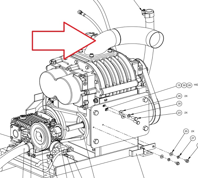

I'm not going to have a nice weekend! I have a 1999 Hydramaster CDS and last year in August I had to replace the blower. It had seized.
So now I have a similar problem, the blower still turns but there is a lot of drag, to the point that it almost shuts off the truck engine. So I abandoned the job I was about to do and scheduled an appointment with LPM, which is the local repair place.
To get a little more information, I disconnected the drive line and took off the belt that powers the blower. The driveline and the pillow blocks turn easily, but the blower is really tight. It can be turned by hand but not easily. It is a Tuthill Competitor Blower Series 21/22/23. I tried to call Hydramaster fo find out what could be the problem , but nobody picks up the phone. According to the manual I have 24 months warranty, but what if something bad got sucked into the blower, would that void the warranty?
I don't understand how blowers work, so I have no idea how the air flows through it and what could possibly get into the intake, to cause the blower to have resistance like that.
I understand lack of lubrication could cause it to seize, that is not the case here. Maybe some metal object in the intake could seize it also but it's not that either. Nothing that might have gotten into the tank even punctured the mesh intake filter.
So what could possibly make it so sluggish that you can barely turn the driveline by hand?
I have an appointment at LPM in Spokane on Monday, but I sure would like to find out a little sooner if I'm looking at a possible second blower replacement or if that is something that could be fixed.
What do you guys think?

The blower is the newer model where the bearings are in oil baths and they don't need to be lubed. The Pillow blocks and the U Joints are the only points that I need to grease, and I did that religiously every 50 hrs. And no, there is no point where the blower rotation sticks it is just very tight all around. I'm just wondering , if I can turn the blower by hand how can that possibly bog down my engine?
Here is a little more information about what actually happened:
I started up the machine with the water pump clutch off and engine idling and then the Machine would come up to about 1200rpm and within 15 seconds the rpms would start dropping quickly to almost standstill, where I thought it might have been the driveline because I also heard a squealing sound coming from the area where the driveline is underneath the cover , not really loud but unfamiliar.
I don't want to open the blower because it might void the warranty and besides I totally don't know what I'm doing there.
I wouldn't open the blower just pop the inlet piping and look in....and give it a spin to see if it spins freely
but based on your last post it almost sounds like there is a vacuum that can't be broken that increases with rpm bogging it down........like something stuck in the inlet system or collapsing (could be on exhaust side too)
but of course if you are uncomfortable or worried about the warranty wait till you can get it to a pro

This may not explain why the blower is hard to turn by hand but if the engine is bogging down you may a restriction on either the suction or discharge side. I had a unit with a blower heat exchanger. The coil inside the exchanger moved and restricted the air flow out of it. This cause the engine to dramatically bog down after it reached a certain rpm. The blower could suck all the air it wanted but was unable to discharge it.
