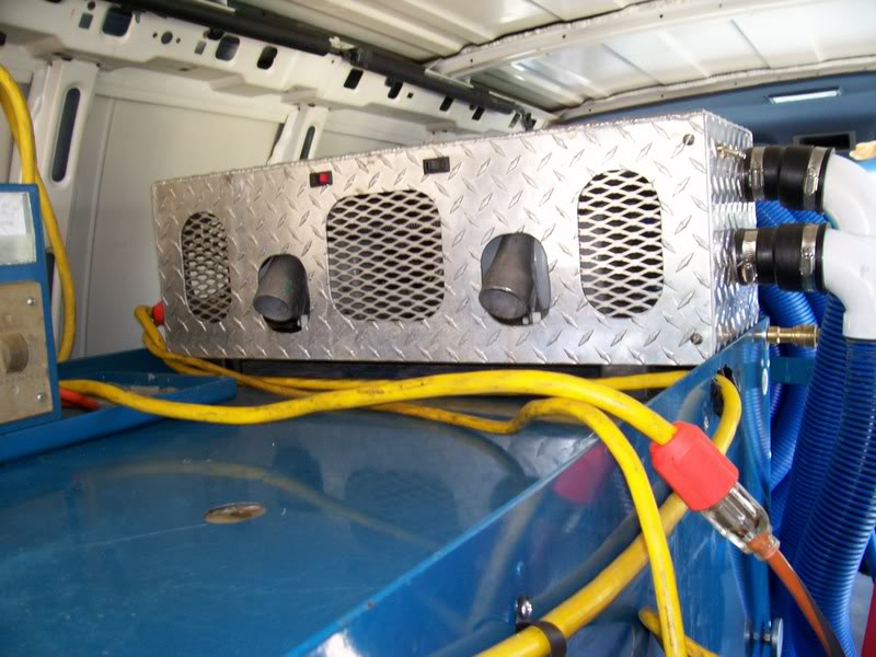

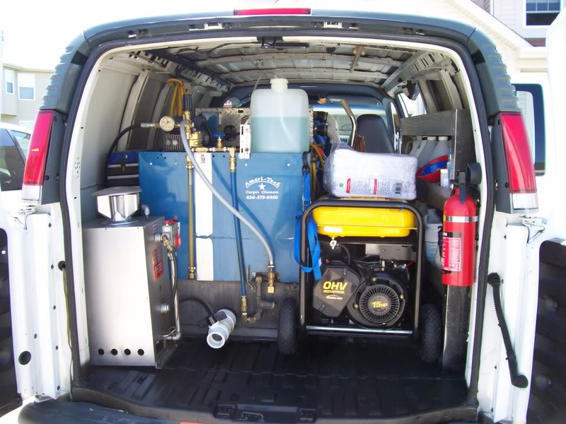

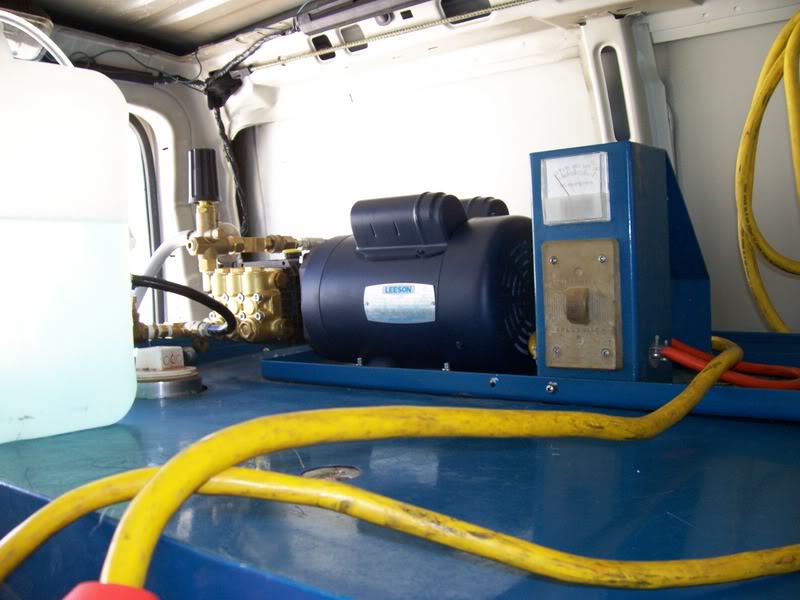

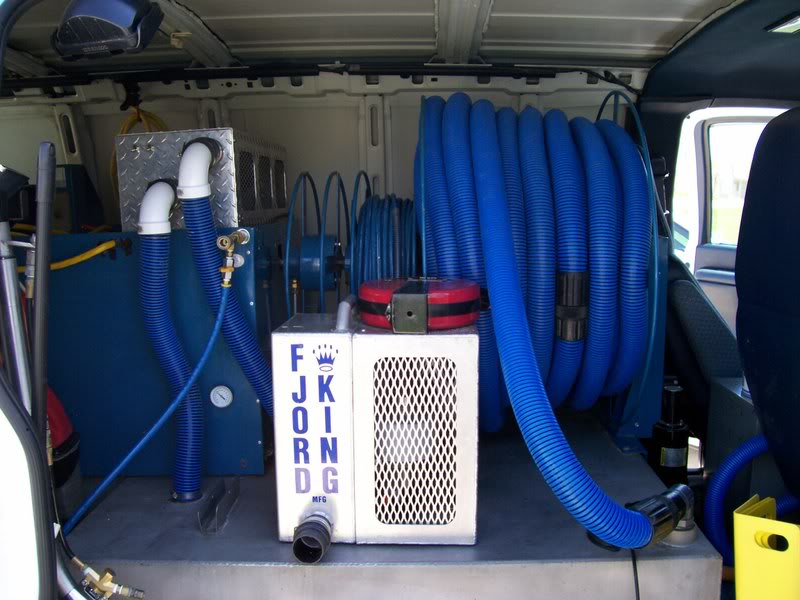

I ran the pimped bane, remember???
Started out using outlets at the customer's house. This became a REAL problem in the summer, not enough breakers and too many things from the house running on the too few breakers. Get the point?
So I'm left with 3 cords, one for the water pump, and 2 for the vac motors. To draw less amperage, I converted the 12 gauge cords to 10 gauge (more cost) and really didn't lower the amperage that much. Breakers still trippin.
In comes the generator, problem here, I couldn't find one big enough to run all 3 cords that I could afford or make cost efficient. So I went with a 5500 watt genny, lasted 18 months. Then to a 13000 watt genny, lasted 2 yrs. Bought the last genny 6 months before I sold the entire unit in Sept. 12.
In theory, electric is great, but still doesn't deliver the power as a gas motor driven blower and water pump provide.
On other note, those thinking of buying a electric TM, bane is the way to go. Just buy the tanks and electric reel setup used and add your own water and vac system. The tanks and reel systems are rock solid and will last a lifetime.
