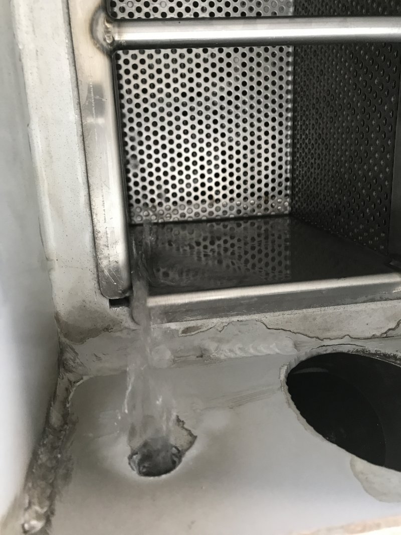

They could route a line into the waste tank to cool it off and then go back into the fresh water tank.
27,863
If you are using a last step chemical injector, you can plumb it to a fitting under the truck and just dump on the ground. It's only hot water, not going to hurt anything.

They dump it into the waste tank because not all setups have fresh water tanks. This dumping action is to protect the equipment and the manufacturer from the operator.
We all work at different speeds and efficiencies as well as different water flows.
The dumping will generally happen when cleaning upholstery or stairs because those tools have lower flow rates; and may also happen if you are off the wand trigger for 5 or more minutes while talking or moving furniture.
If you dont have fresh water tank to reroute the dumping water then you will need to increase your flow rate and or change your wand technique. Basically while cleaning only wet enough area to drain your heat exchanger- thereby filling it up with new unheated water- then do dry strokes.

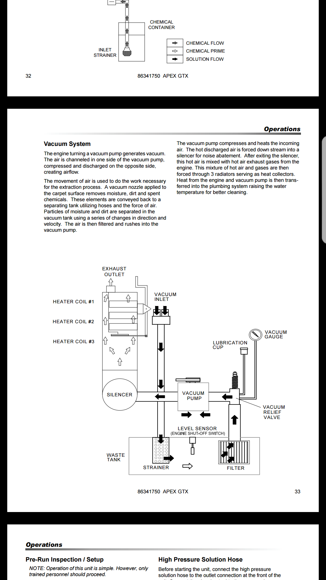

Yeah why not divert the exhaust to stop heating the water when it reaches temp rather than over heating the water which leads to dumping out into the tank
My last mount - the solenoid would open up and dump back into the fresh tank .. good in the winter .. not in summer as it got toooo hot ..
Spurlington
Dec 15, 2012
1,324
On The Board
Spurlino
The pic above isnt telling me too much about diverting. My SS370 has a maual diverter to bypass the heating chamber - but I want it to bypass on its own as it reads selected temps rather than dump the water to bring the temp back down.
