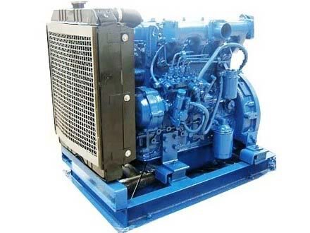

. I was told over a year ago on another board that it would be difficult to build your own tm. They were right although my fist one came out ok I didn’t get to use is but once because it was stolen from the storage unit that assured me that it would be safe there, so I’m at it again trying to put together another unit. I wouldn’t say tm actually because I’m put it on a trailer.
Due to the increasing pressure the EPA is put on waste water we decide to recovery and process almost everything now.
As state above I’m putting another unit and here’s what I’m working with:
1. 65 hp DIESEL ENGINE. <img src=pic's
2. 4909 DUROFLOE BLOWER <img src=pic's
3. 2 30 gal waste tanks <img src=pic's
> ( I have tested these at 18 hg and they work fine)
I will also be purchasing the following:
Greenie says that he is going to have some glides and other fixes for the rotovac. I’m going to purchase a high flow wand 3 inch Knuckle and the. Manifold<img src=pic's
> (2.5) and the y (2.5) from him also. . I will split the 5 inch Npt from the blower to the Greenies Manifold <img src=pic's addy > ( two 2.5 ) to two 30 gals waste tanks . Why because I’m hard headed and I have to do it my way.

Hey Sam, welcome to the board. I'm drawing a blank, did we talk about the machine you are building, it doesn't strike me as familiar.
Now that said, you mentioned capturing all your waste water for processing, I assume you are going to use a big poly tank that will be filled with these little barrel tanks and their pump outs?
Who is doing the heavy engine work on your unit, like coupling that blower to the diesel, and building the frame?
I understand you are going to use your Kero Steam unit for pressure and heat, and that is enough for 4 wands...lol But any reason you went with the engine and blower you have pictured above?
Belt or direct coupled blower?
Are you putting this together just for the occasional big rig carpet and Apt jobs or are you looking at more daily carpet work?
I imagine the mytee units are just fine for interiors.
Do you plan on using the unit for catch and capture recovery from your flat work as well?

You are absolutely on point I have two 550 gallons tanks that will be used for recovery...
I do a lot of industrial work and so I know the shop foreman and just about everybody that deals with plant operations , which brings to the reason I’m using the 4905 blower and the MTD engine. Because that’s what they are using and they have parts on hand to service them. Greenie they used the diesel engine on a generators and to power large pumps and other equipment the supervisor told me that they routinely get 10,000 hrs on the engines. The blower they run at 18 hg 24/7 and don’t use water injecting either. I was told that the blower cost around $3500 dollars; we made a deal to trade out some cleaning for the pump and mounting the equipment...
Yes I will be recovering everything
