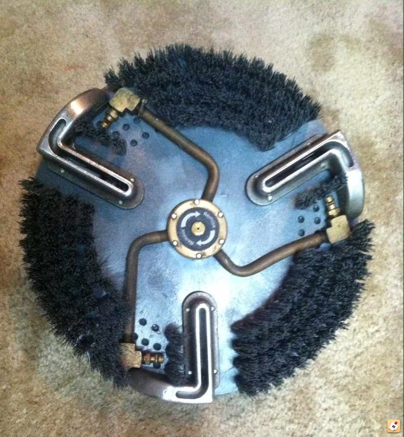

Mikey, I bought that brush on your recommendation in a post I saw a few months ago and I'd consider it one of the most important tools I have. To say using a grandi groom is as good as a brush on a 175 for agitation before cleaning is far from reality.
When looking for an agitation device many things must be took into consideration. Russ has truckmount that generates plenty of heat so a grandy groom would be adequate for the job especialy if he is getting even more agitation via the 360I. I can understand with you running a portable that you must make up for that with added agitation. For me I have found that this Koblenz mini scrubber in conjuction with my truckmount gives us all the agitation necessary on most jobs
http://www.amazon.com/Koblenz-P-180...=UTF8&qid=1381592537&sr=8-15&keywords=koblenz
I have a rx20, several 175's and all sorts of other toys . However now that I actually have a truckmount with some balls I don't need to really so heavily on agitation to get the job done. I especialy like this miniscuber because it weighs like 30 pounds and works great when you need to pre scrub certain areas . I also like it because it works well for my employees , I know they wont be wheeling a heavy 175 across woodfloors and through a house. Its awesome for pre scrubbing tile as well. Some times we get a bathroom and a kitchen to clean t&g and its nice to put the hard surface brushes on and do a quick scrub and be able to scrub in tight areas
