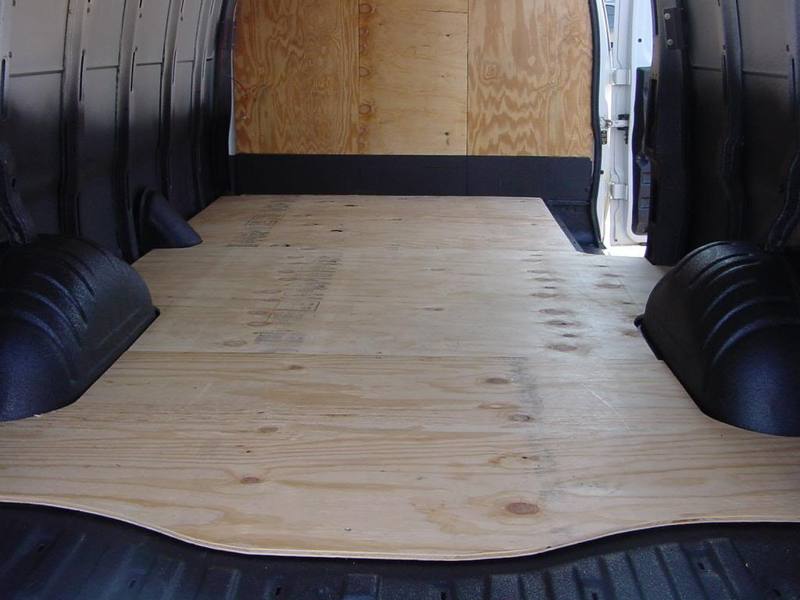

My van(s) came with a 3/4" rubber mat floor cut to fit. You could get the material at a farm service store.Stall matting is what it's called. The stock flooring would hold a lot of moisture over the long run.
We do as Shane does but with blue boat carpet over plywood, it can take the punishment for 3-4 years the we tear it out and do it again. Sand and touch all the paint with enamel paint so everything look purty. :winky:

CRASH set his unit up on hockey pucks......
takes a garden hose in the front and rinses right out the back...

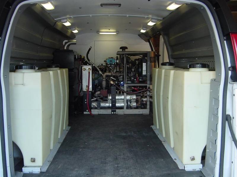

My frame sits flat on the floor.
Would be nice if it had a stainless floor to act as a catch all.
Only problem I have is we run a 9 and a 14 gal solution set up. Love the ability but arranging the tanks so I can see how much is in em suks.
Running out the back is how I roll. Keep a spotter bag for bombing stains. Extras n refills on the shelf.
Front seat is my office and the back doors are my work bench.
Side doors house the cannons and missiles : )

120 gallons, It's a 3500 extended and when completely loaded it is pushing 9600lbs. Rides great with weight on both sides and with 40,000 miles on this set up there have been no issues with brakes, steering or suspension although it could use up-graded front coil springs. I'll see if I can get a pic of it totally loaded.
