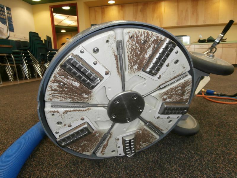

Does not make any since to me....I don't understand why we need a floating head for CGD....
From what I am reading is that they think that the 360i and the Hoss don't work on CGD...and so because there original Trex head was pretty much a copy of the 360i they felt compelled to make one for CGD....so for another thousand bucks you can by a floating CGD head.......????????
although I did not really care for the 360i on carpet with any type of a pile...it did a great job on cgd...it stayed up above the fiber and cleaned it as well as any rotary out there...
same with the Hoss...I use it on CGD all the time ...great recovery...excellent for flushing them out...so who or where ever they are getting there information from...it is far from accurate...or it is just a sales pitch to get the new head out there.......
I have never cleaned with this head so how well it does I can not say...but I do have a few questions...
1..why do we need a thousand dollar floating head...the concrete for CGD is slated....meaning it is very smooth...so even if there is a slight ripple...you will never really notice it...are they installing small speed bumps that I am not aware of....????
2..what is all that dirt and grit going to do to all those moving parts and pistons.......I sits up high off the surface..but anyone who uses an RX knows that it will still collect dirt and grit....I would worry about the damage it is going to do and how in time it would effect its performance......
I am all for cool new things that help up out...but to me this one just does not make since......like the 360i on cgd.....the head that came with the Trex should of been just fine...

This would concern me with all those little moving parts.........

Love to tell you about it , as I have used the flex star for months and have send it to a about 12 other cleaners with T Rex's to use . But I'm not sure if I still have a gag order from Mikey when it comes to talking about anything M###e or J####n.
Mike L you have my number if you want to test run a flex star all you got to do is give me a call.
The need for the floating head came from cleaners asking for it. People wanted shoes that would move over uneven cgd without chattering. Which the flex star does,
But anyway , anyone is welcome to call me and ask any questions or concerns they might have
