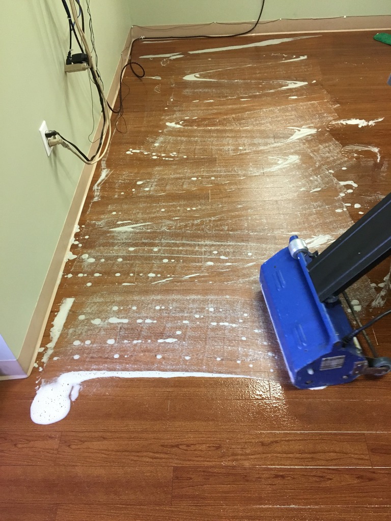

We have done these....the most aggressive agitation we did was with our 10 inch CRB and standard white brushes...
Then went over with hard surface wand extracting....
Came out great actually....

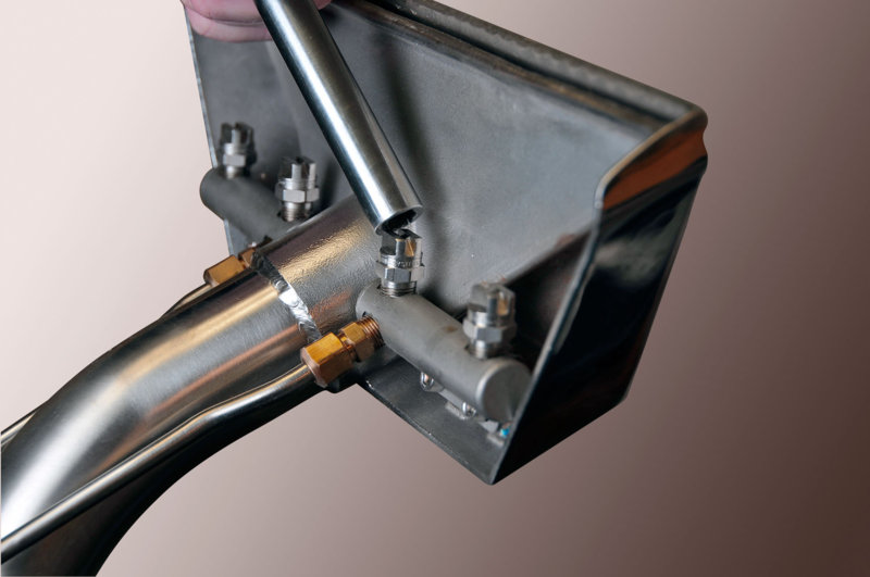

14,080

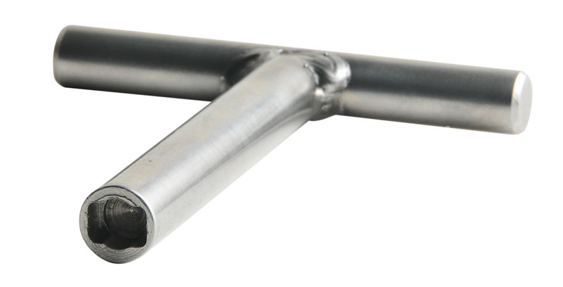

Those jets look like they're hard to access for any service that needs to be done on them. WAs that just a complicated shadow I'm looking at or is it a tight fit for the socket to remove them?

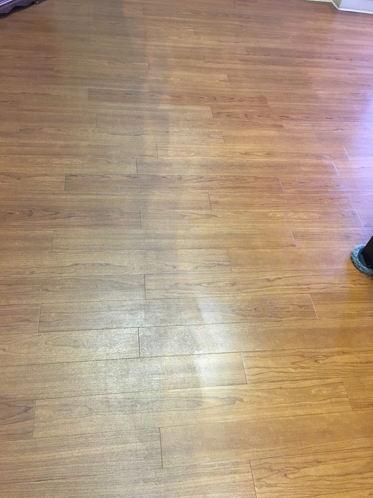

If you have a laminate cleaning procedure, it should work to clean the construction dust.
These photos are from a job where the vinyl had a texture to it. I hope the previous cleanings with a black pad did not ruin it.
We used only flat mops for extraction. A CRB is the right tool for this type of job.

Yep. Looks very similar different color. What did you use for a cleaner? Daily neutral or Bruce?
