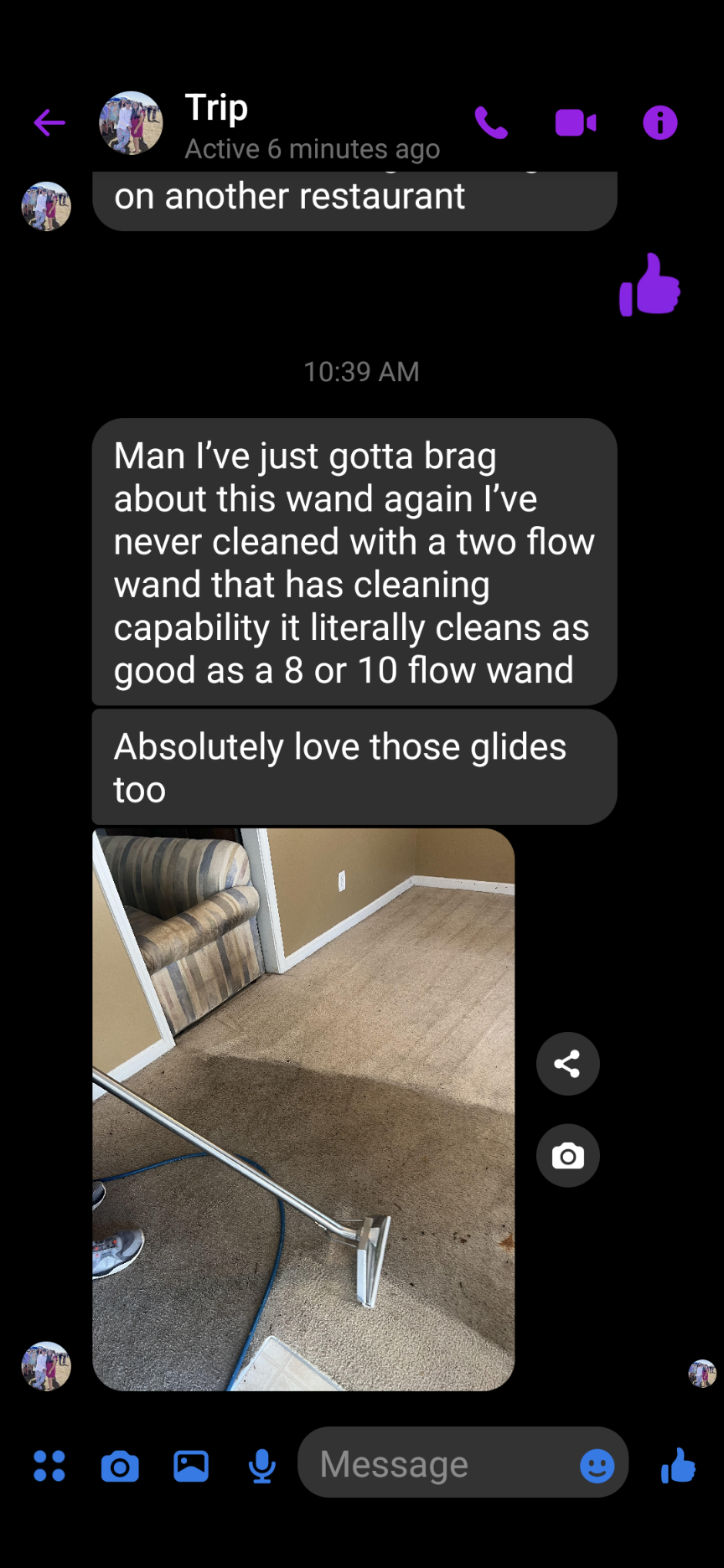

Those usually have two # 2 jets 4 flow.
I have a 6 flow 6 jet prochem to for winter when I'm looking to get better dry times.
So that aw29 has two #1 jets 8001, 9501???
116,027
No, its four flow.
He had a brain fart.
Four flow at 500 psi from two jets, properly angled, works terrific, and dry times are excellent
Assuming you've dry vacuumed, pre-sprayed, and used dwell time and or agitated
11,304
No, its four flow.
That makes more sense.
Yes at 4 flow it's a good little wand
Luky
Jan 19, 2023
327
Chicagoland
Mario
Glide or no glide, there is 3 lbs. weight of difference between the 6 jetter and 2 jets wand. If I'm working myself 10 K sqft. restaurant
( which I usually do😮‍💨) I use 3 tools: 6 jet wand with # 10 flow, 2 jet with #6 flow, and SX-15. The big wand is for a large open area ( about 4000 sqft,, smaller one is for
" dancing " in between the tables (400-person occupancy ) about 5000 sqft. and rest of the cgd is trashed so I need the spinning help of CX-15. It seems like a lot to carry around, but to preserve my strength and maintain steady pace, I have to do just that. I'm going out tonight, I should be back before 2 am tired af.
