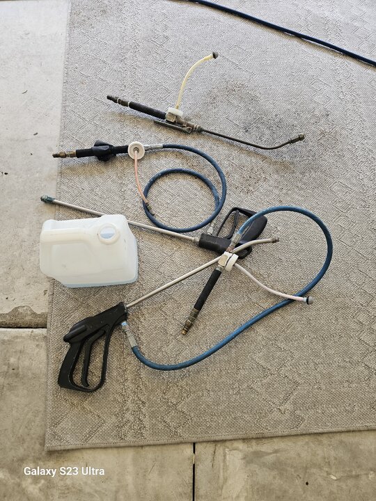

It seems that my Hydroforce sprayer is not really putting out enough chemical.
I went the route of 4 to 1, when I first got it.
I checked the small filter it's clean, and I can see the foam from the prespray on the carpet, it just that I can go a few weeks without refilling the container when I use to fill it every couple days.
I figured something is clogged somewhere.
Can anyone help?
Thanks

You said you checked the small filter?? The hydraforce has 3 by my account. 1 inside the jug at the end of the pickup tube 1 at the quick connect inside the handle and possibly 1 at the spray tip especially if you have a tee jet it'll have a ball check strainer (looks like the one in the handle but has a sping loaded check valve to stop drips) also can have a ball check strainer screwed into the back of a vee jet but i don't think that comes standard from hydraforce so when you said you checked the small filter which one? Do you have a real hydroforce or a cheap Chinese knock off?

That hose that's attached to the barb inside the HF dries and gets stiff, which will start to pull air up in the hose, causing less pull. Put a fresh hose on it and see how it works. If it still doesn't pull any chemicals, just replace the dema

Yeah i need to replace mine again. It starts sucking air at the barb. Ive had to flip mine upside down to get it to draw in the past. Its an easy way to check it.
He could be mixing the prespray to thick also. I only add 3 scoops to a gallon and use soft water. It lasts so much longer now. Ive been trouble free for about 6 or 7 years with this one other than the feed tube drying out and cracking. It only lasts a couple years.

I drilled out the yellow plastic metering valve larger, but still not refilling the jug for weeks. I need to check the o-ring, but I did lightly stretch the spring and the ball moves fine, just not pulling the product. So I just removed the yellow metering valve after my last job, we'll see if that changes things. You told me on my last Hydroforce, to remove the yellow metering valve and use 4 scoops and that produced great results. TY 👍🙂

I disagree, i keep 3 hydroforces on my van and all i do is change the hose and wand(it connects thru hollowed out ¼ quick connects) 2 are for presprays 1 for odor control products. I only use powdered presprays and liquid odor products and they all seem to wear the same. Ive found the biggest problems have beem when using non hydroforce brand dema valves even the wanders stainless ones are problematic (i bought 5 only 3 worked good outa the box and only 2 are still in service. About to test his repair for life policy) so in short hydroforce brand good Chinese knockoffs not so good

That's what i do.i like not having to change jugs all the time. Plus it's nice to have a spare sprayer on the truck. I don't like all the hoses and wands , so what i did was as old 1/4 quick connects went bad i would use a punch and pound the centers outa um then put females on sprayers and males on hose and wand and ill use 2 sprayers but 1 wand and hose. I have another one tucked away in the van for those times i want 2 setups or something breaks on the main one

One other option to try before buying a new one is to run an acid through it. You can use your tile cleaning acid or even descaler. Pull the tube out of the jug, run water through, then stick the tube into a jug or bottle with your acid, squeeze the trigger until you see foam on the ground. Let it sit for an hour and flush it out. If you're lucky, it will be spraying like new.
