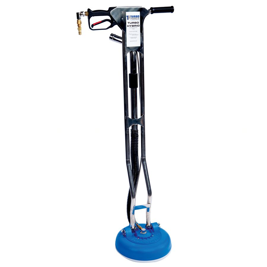

Exactly my remark to them on their youtube video...the brush idea sucks, the vacuum with slots suck (literally), and the "plastic" non-Teflon glide sucks...Not only that it looks bulky and heavy...I mean, why aren't they sending these tools to critique to people who use them every day? Step 1, study a turbo hybrid?
Side Note:
BTW turbo hybrid needs to make the mold for the Teflon boot (notches) that hold it to the tool better quality...

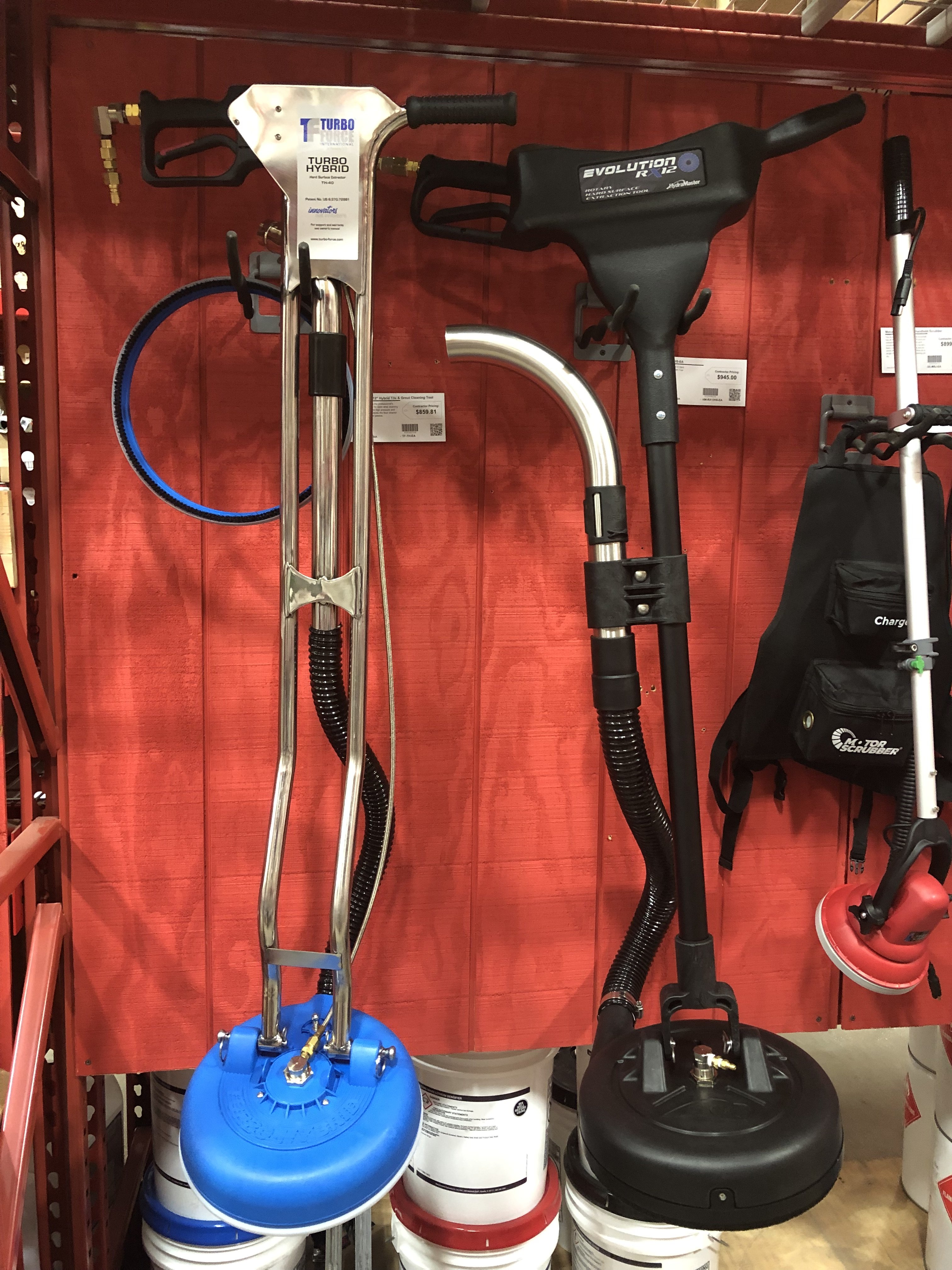

Was in Jon Don today. They had the 2 tools side by side... I grabbed both and I’ve got to say the Revolution felt like like an unruly behemoth compared to the Turbo Force.
91851
CJ-FL
Jan 28, 2018
448
CK-FL
What's that little red tool beside the Rx? Looks like you could use to scrub stairs with an encapsulant.
