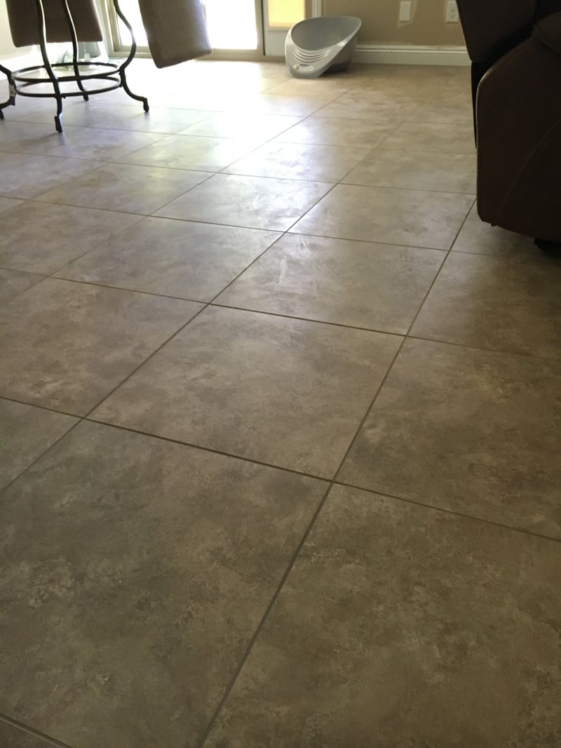

We used HydraBoost CT on this tile the other day. Rinse it well and all looked good when we left. Customer called and said there's a ton of residue and it makes foot prints on the tile when they walk on it. They had movers come in and put in furniture and when I went out today to use a PH neutral floor cleaner and mopped it everything looked fine. To me this just looks like dirty foot prints but when I said that she said how come there weren't foot prints when they came to look and buy the house. I never had this issue with HydraBoost before and her tile wasn't bad at all when we cleaned it. What does this look like to you?

We've loved the product, but yes it leaves residue. Use a spin mop ($30 at Walmart) and go over it twice with lots of rinsing.

How did you rinse it Will?
