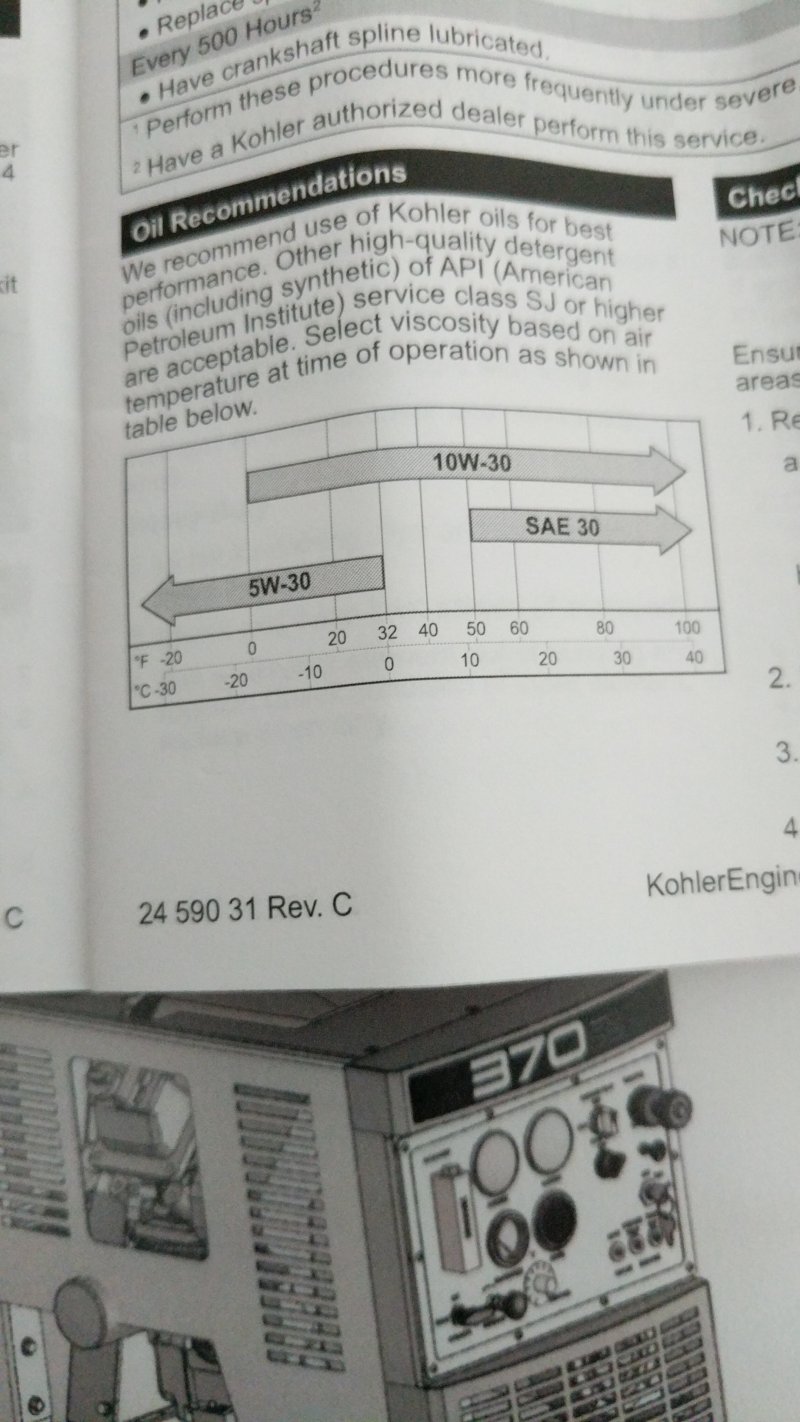

The graph is all it gives me Matt
But I'm not on the coast, I'm on the east side of the Sierra at 4800 ft elevation. My working temps range from 15° to 105° through out the year, and on some occasions, the same day. :eekk:
