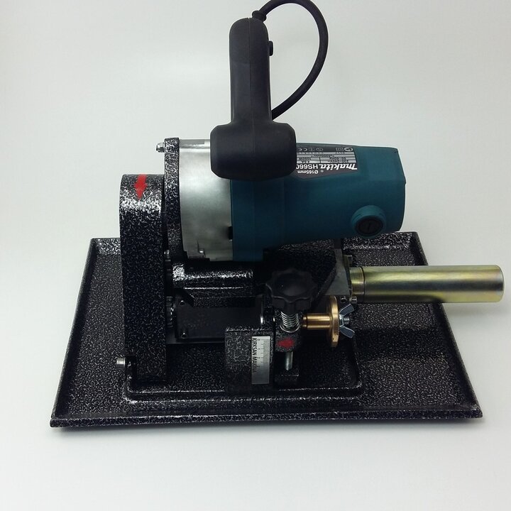

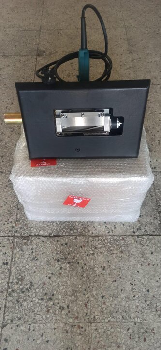

@Sergio I would look at a Turkish supplier for a shearing machine. That is what you use to do this. I have spoken with this gentleman before on Facebook who offers them - search for:
Kirksan Hali Makinaları İmalatı (Carpet Shearing Machine) on Facebook.​
In 202o he quoted $1,250 USD for one.
Kırksan Halı Makineleri İmalatı
Kırksan Carpet Shearing Machine
+905348583286
+905448478133
444215229_10161179138573818_7924182556147925416_n.jpg 83439834_10157782686313818_2456680572727066624_n.jpg

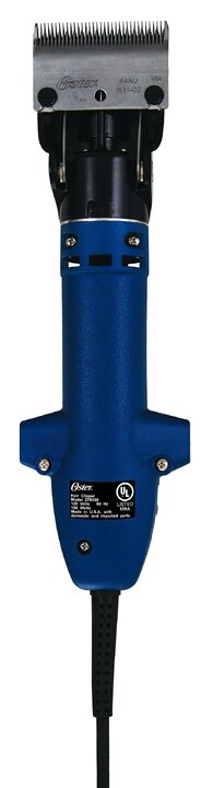

Additionally, for a few hundred dollars you can get something like these Oster Clipmaster shears that are handheld and can accomplish similar effect.
