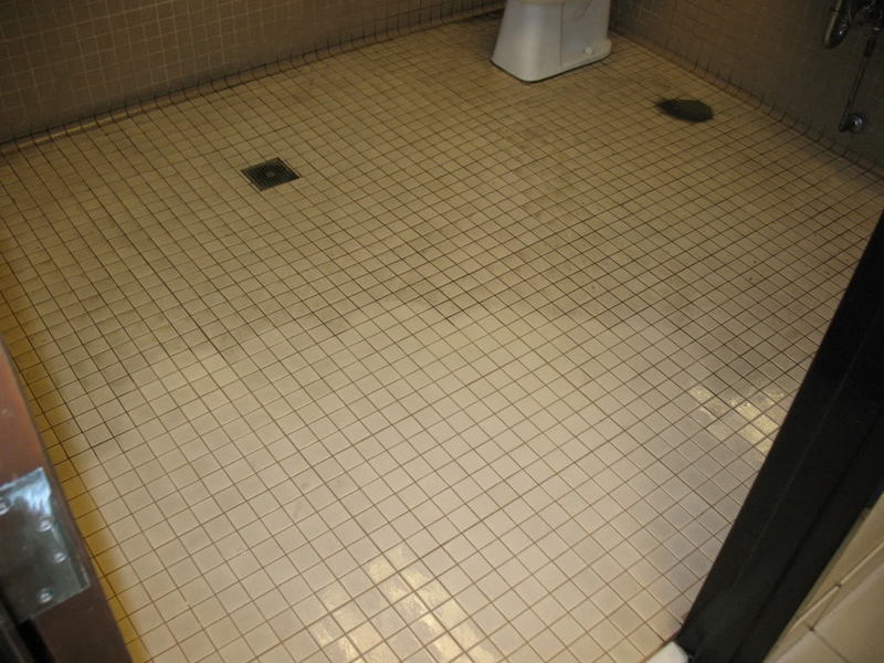

You need to demo side by side, scrubbing then turbo and no scrubbing then turbo. Same chemical mix and ratio. Don't use it too strong or you will have to use that way for the entire job. I just did 4K sq ft car dealer on Friday. It was some of the worst that I have done. I did not demo. I still priced it right, but it was more work than I thought. Wouldn't hurt to do a spot in a bathroom too to see it cleans the same. Normally the bathrooms take 2-3x longer with having to clean edges and walls.

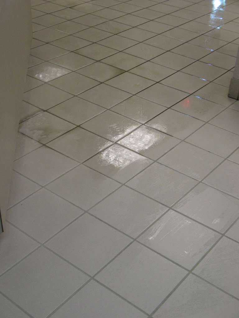

Finished in about 4.5 hours and was not to difficult but was not completely 100% happy with the results. Don't get me wrong the customer loved the end result and is going to get me in to their other buildings but i was not happy citing that i had a different idea of how it was going to turn out. I will post pics as soon as i learn how.

With this job the grout didnt match when dry. But after a close review of the floor i noticed that some kind of repairs had been made to the floor at various times and those repairs were not to professional. There was grout on top of the tiles, there was grout that was even with the tile, and several places that the grout was darker not dirtier but darker than others. Is this were color seal comes into play?
TimP
May 19, 2007
4,055
Sounds like an ideal situation for color seal. Nothing on top and grout that isn't uniform in color.
If the customer is willing to pay for it, it will be worth doing.
