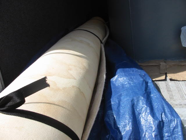

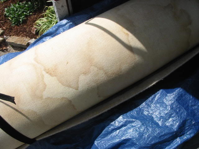

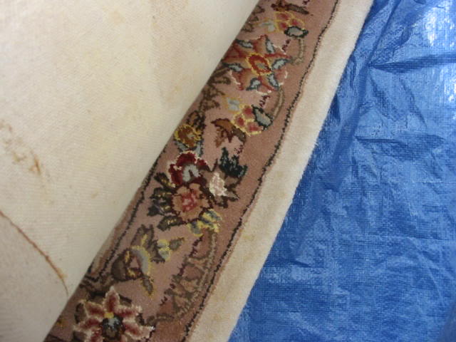

Can this wool/silk be pit washed? If not how can I remove the most urine? Is it worth the time to try?
If it is a waste how do I communicate this to her? She foster's dogs and this rug is disgusting.

What you have there is a either a problem or a cash cow. How much is the rug worth it to them? If you pit it will it run the likely hood of delam.. its possible it could go either way. It may delaminate, it may not. If it delams can you fix it? absolutly for a charge of repair. I would find out your cost and profit to completey decontaminate by pit soak and then the possible repair. If its worth it too them then great, if not then tell them its time for a new rug.

I picked up a rug in just the same condition that someone threw out. It was also a wool and silk combo. I experimented with all the products that I carry plus some that I don't. None of the methods that I would normally use worked. I don't have a way to dunk it and I don't take rugs out so I was looking for a way to handle it directly in the house. I did finally solve the problem and here is what I did. I laid it in my driveway and soaked it with a garden hose. I took a large brush and some shampoo and scrubbed it. I then rinsed it until all the yellow quit coming out. At this point the rug still had a very strong smell of urine. I had already tried a large number of safe products with no luck so I got out the bleach, yes bleach. I mixed 2 cups in 5 gallons and poured it on. I did that until I had gone through the 2 gallon container of bleach that I had. Yes, I am aware of what bleach does to wool but it was free and I was experimenting. I let the bleach set for 30 minutes in the hot Florida sun. I washed and squeegeed it out and the rug looks amazing. I've had the rug in my house over a year now and it looks almost new. Normally I would of returned it with a note to the house I got it from but I really don't want that kind of customer. I'm not suggesting that you try it, unless all else fails. Get a release from the customer. Also my rug didn't have a backing , be careful it might separate.

I have done lots of these, and my treatment method is- with the rug face down, saturate the affected areas with Bac-Out, turn face up, saturate the face with Bac-Out, roll up, leave for 24 hours.
Then clean the back, turn over, clean the face.
Odor gone, urine gone, stains gone- except if there is a dye from medicines in the urine, which needs some peroxide or similar product.
