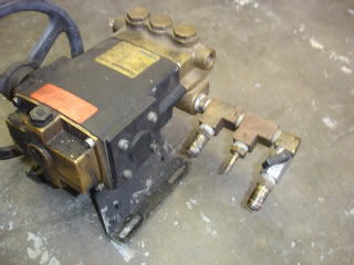

is that on the inlet side???
and whats the valve for??? just a crack and it draws or what
Mikey P said:
Lookie what Les set me up with.
Fool proof chem draw system.
you'd think a TM that costs a million bukz would already have a RELIABLE chem feed.... :roll:
BuTlEr is the other one
of the dudes that advocate clear water rinse only, my contention has always been...they never had a RELIABLE chem feed system and got fed up with those quirky junk chem pumps...
you have to starve the pump a little somewhere upstream of the draw tube or it won't draw

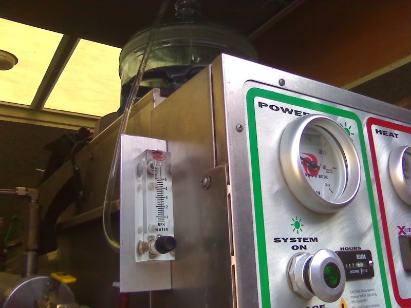

its really simple. install a t fitting inline of your fresh water inlet run a hose to the top side of the dwyer flowmeter, then a hose from the bottom side of the flowmeter to a jug. I would put a screen fitting on the line to your jug. You also need a valve on the fresh water inlet side in order to restrict flow. once you start restricting water inflow to the pump then it will start sucking from the flowmeter/chemjug. If you use a flowmeter with the little black knob then you can pull a little higher number like 5 or 6 then dial it down to 2 or 3 etc.
If you dont have a freshwater tank and hook up to a spigot then u need a watts regulator and a check/footvalve on the jug side of the flowmeter. That way u can restrict the water pressure coming in and the check/footvalve will keep water from back flowing through the flowmeter into your chem jug.
my last step works great. cant imagine going back to a siphon system.

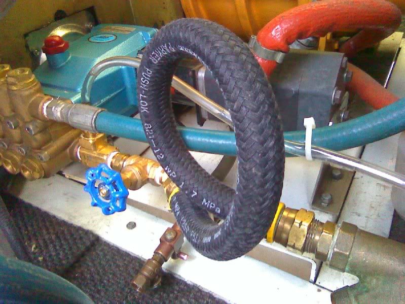

I like Mike's a little more, but this is the set up I had when I cleaned (before having access to Les's wisdom), in fact the pump still ran fine the day i removed it, if someone needs a pump cheap ready to go, just PM me.
As you can see, I had the starve set with a ball valve barely closed, and the regulator bypass came in close to the pump head, and the dwyer fed in between....foolproof, always worked.
I can think of another reason to Stay with a simple siphon, you don't have to worry about blowing diaphrams and bypassing your chem system just because you are running high pressure, 800 psi is brutal on diaphram pumps.

I have been studying this and talking with a lot of pressure wash guys and they tell me the best way for me to go that is worry free is to take the one in the third picture and put it in line with the cat pump.......
branch it off to my adjustable Dwyer meter..and from there to my 3 way valve ( left tank ..right tank..off )
that way I have full control over it on which tank I want to use plus I can shut it off if needed.....
and of course a foot/one way valve in each jug
