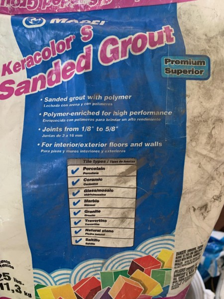

and you sure that isn't epoxy grout haze/residue?
or a sealer they applied?
*I'd expect it to end darker.........and not be so even...but

an acid like epoxy grout haze remover?
Does water stain it? Or does it just become trapped under whatever is left there?
She used Grout Haze remover, not Epoxy Grout Haze remover.
most every consumer tub and tile cleaner and maintainer is on the acid side.
