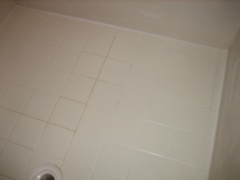

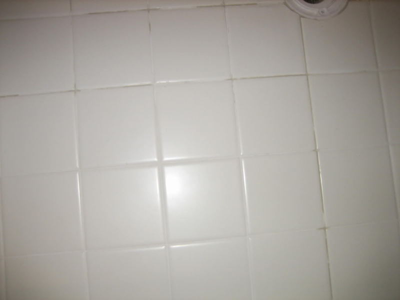

What am I dealing with here?
Customer emailed me some pics of tile that was regrouted two weeks ago and no water has been turned on. She says it is grout bleed back. Can I just apply some color seal over this or does it need something else?

Assuming the grout and caulk were in terrible condition when you did the restoration, there is moisture in the pan that is wicking through.
Were I in your shoes I would color seal it and sleep soundly that night. Its funny though, acrylic showers always end up coming back to bite me in the ass in one way or the other, so much so that I am going to start excluding them from any shower advertising we do.
115,978
Unsanded grout :!:
Color seal wont stick and even if it were sanded the last thing you want to do it trap moisture underneath with colorseal.
It'll peel off in less than a year.
Put a air mover in there for a few days to a week to dry it out than put the priciest solvent sealer you can find
Dry Treat preferably.

Mikey P said:
Unsanded grout :!:
Better advice

This is exactly what I was going to say. Un-sanded grout will not hold the color seal. On shower pans with un-sanded grout we re-grout all the pan. Shower pans suck!

I like the drying plate idea.
Who's to pay for all this extra work nonsense? Likely you Daniel.
The grout will probably be discolored from the fetid water underneath. If you're going to throw a fan (hope you get a rental fee....) in there you might as well pull the grout out first.
I have personally done ~300-400 shower restorations in the past 5 years and a large percentage of them have been unsanded white 4x4 installs. In defense, most of the pans are usually plastic/acrylic. Color seal will stick to unsanded. I do use Grout Perfect if anyone asks.....

I'd rip out the caulking and put a small LGR dehu like the Evolution in there to dry it out, just an air mover may work but baking it out would work a lot faster, and ensure better drying.

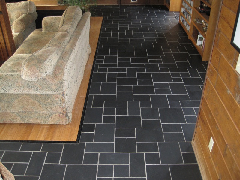

That one was stripped, acid washed, and enhanced. If I recall the slate was pretty smooth and the grout lines were the right depth for CS but she didn't like the combo price so we just went au naturale ;)
I would have colored first. I find the enhancer will tend to eat up light amounts of color seal haze.
You acid washed natural slate?
I did a slate floor in a restaurant that had been mopped with an acid cleaner that caused etching in areas.

Test first obviously. I have never encountered an acid sensitive slate in my neck of the woods.
