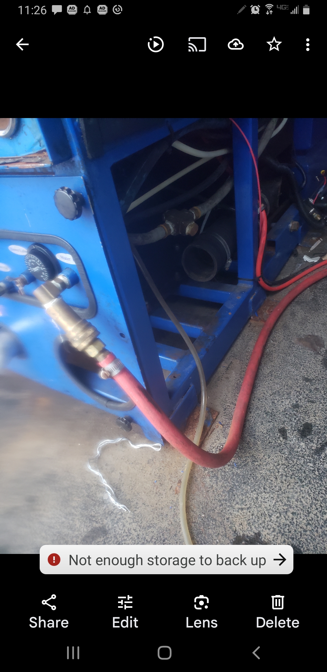

Hey Everyone, I'm new to the group. Can anyone help me find a new heat exchanger for my Power Clean TMT 3000 truck mount? I bought this used and noticed that the heat exchanger is totally missing. Not sure how to add a picture in group. Really appreciate any help. 513-549-1556 Jason

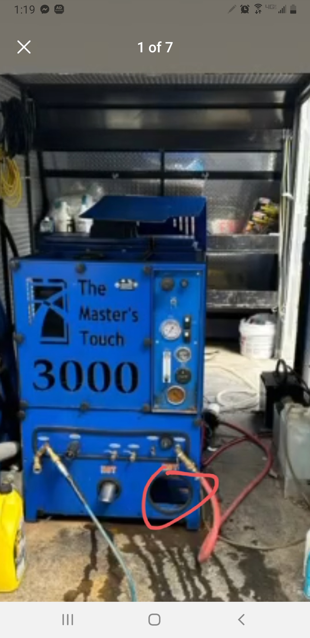

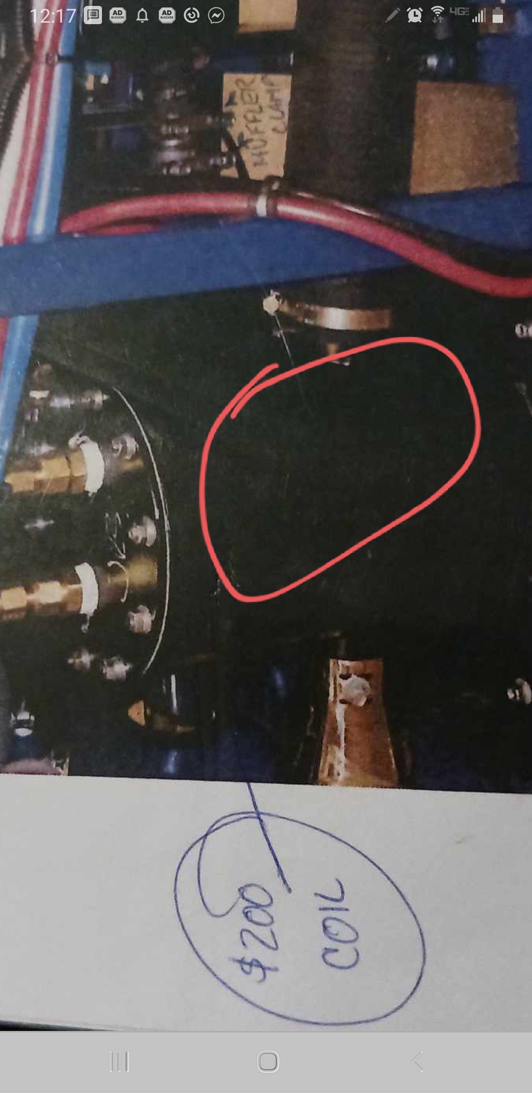

See photos of unit. Thank you

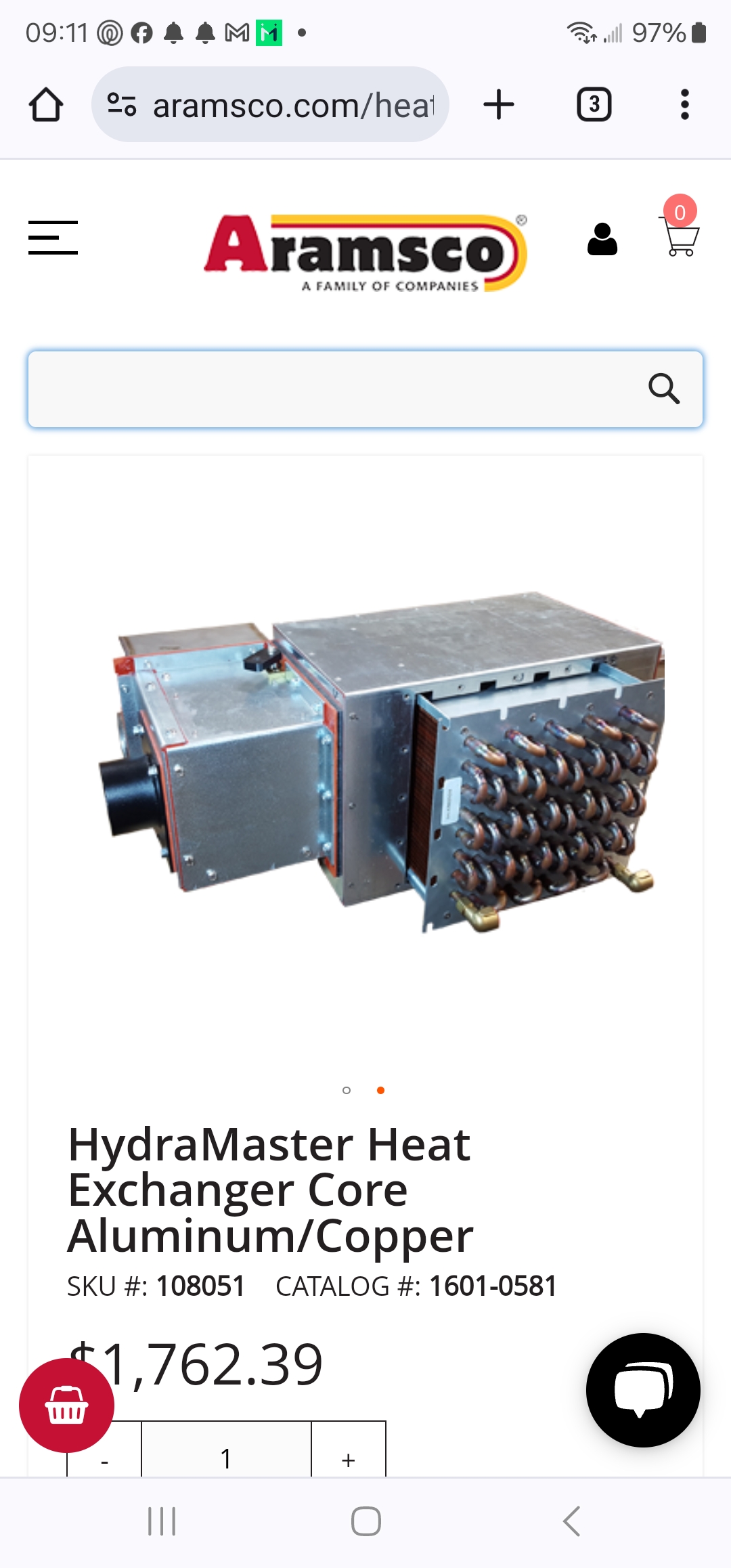

Blue baron may have something but it seems to be the exchanger on the right side of the unit. I'm not sure the HM version will fit the old Power Clean version.

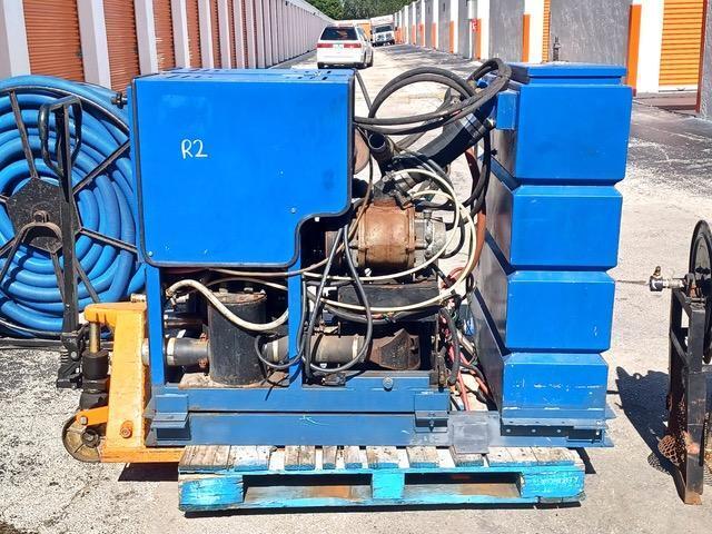

May end up having something built or finding an old TMT or CFI 3000 parts machine. I assume the same exchanger was used on one (freedom XT I think) or several powerclean models but I don't know which ones
Reactions: Living The Dream
It looks like there is a bit of room to mount a different model heat exchanger between the silencer outlet and the front of the machine so I would probably search "blower heat exchanger" models and look for something with a short straight through setup

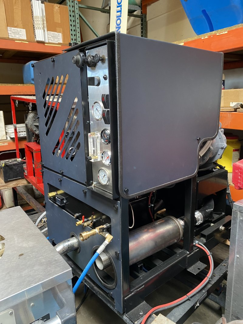

Not the same but you can get an idea from this freedomxt rebuild which replaced the exchanger with a muffler and added a little giant heater
alternatively you could do the same and keep the other? exchangers
