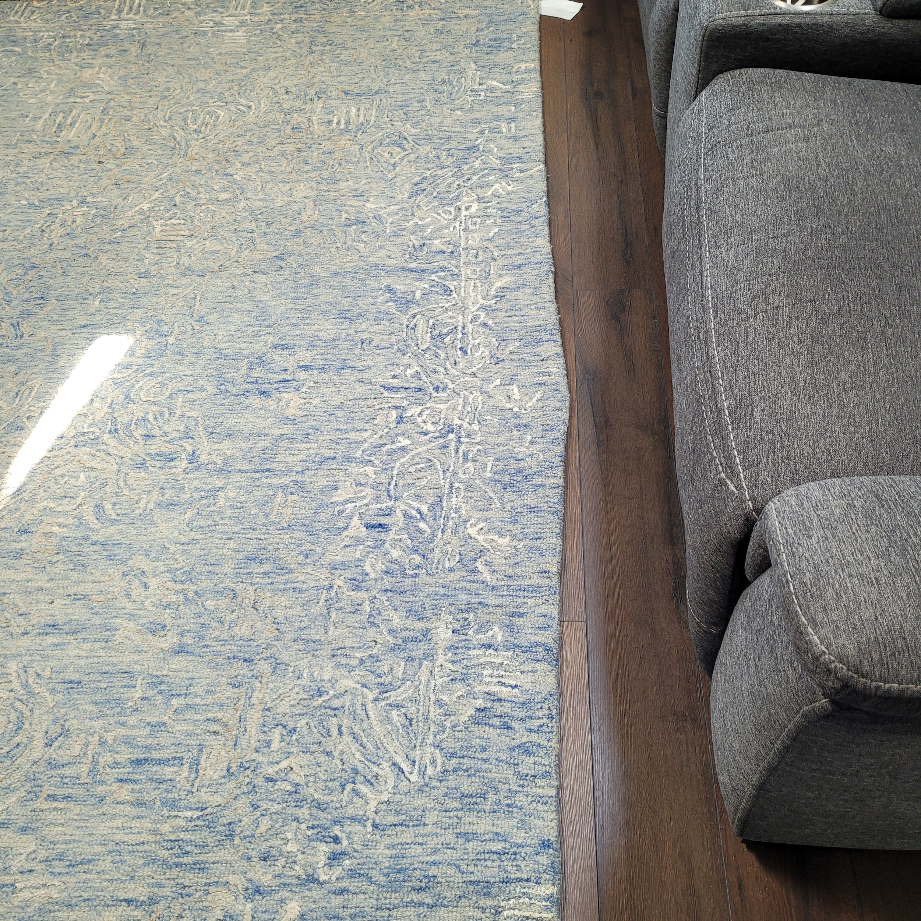

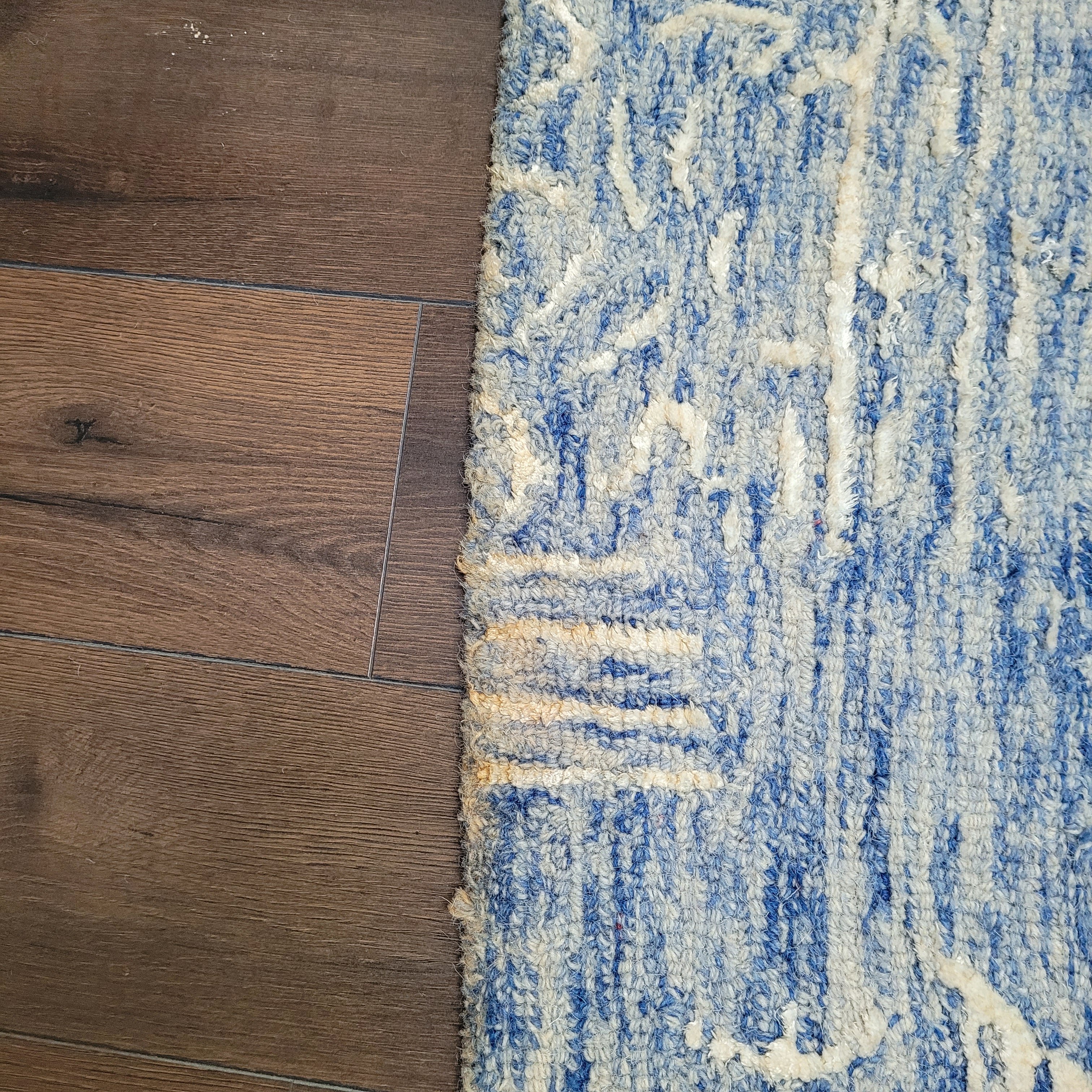

Have you ever used the services of your competitors?
I have a rug 11x8 wool/viscose, I cleaned it twice since purchase, but I wasn't satisfied with the outcome, even though I use shampoo for delicate fabric and black brush( for a delicate fabric) with Oreck. I ended up with a soft, plush feel, with minimum browning. I knew that one of my competitors has a rug plant in his warehouse, so I decided to visit him and drop off a rug for a good wash pit
" spa treatment " The results were less than impressive. Browning, parts of viscose disintegrated in certain areas from raised pattern to turned and flat, and irregular shape were the major reason for dissatisfaction ( my wife was outraged ).
From all the signs I concluded what happened, but I would appreciate, it if you could comment on the process of cleaning ( hint - no centrifuge or wringer on-premises) I'll withhold the name of the company to protect their privacy and their reputation. I'd appreciate it if the rug plant operators -owners can chirp in so we can learn from them about what went wrong.
I give you later my conclusion and plans to resolve the issue. The cost of cleaning the rug was $220, drop off /pickup was done by me.

Viscose cleaning is a bit of a specialty. Chemax makes a rayon rug shampoo that really makes a difference. You never acid rinse a viscose rug. A neutral to slightly alkaline rinse is best. If they don't have a centrifuge, they really need to spend extra time extracting it. Quick drying helps to minimize browning. Part of the problem could be residues left in the rug from your cleaning attempts.

I think you handled it properly. As for needing to take this specific rug to be washed, I don't see a need for that. It could've been cleaned directly on site with just a wand after treating it with a neutral ph product. All of the fancy buffing/op on natural fibers is a waste of time.
My reason: natural fibers aBsorb all chemicals and oils. Meaning it takes time and more water to flush it out. A simple shampooing and buffing isn't going to do what a good flushing if a carpet wand will do.
Synthetic fiber aDsorb oils and chemicals. Meaning all foreign material just sticks to the exterior of the fibers. That is where you'll see better results if you think buffing is the best method for the environment, because the pad will collect more of the funk and treatment.
As for the stretching and browning, yes the idiot rug shop should have left it flat when drying so it would've dried evenly without browning and you do deserve a refund and maybe a check for what the value of the rug is since they damaged it.
Just my thoughts, water is good to clean with. The only thing I feel is necessary in deciding whether to clean on site or in rug shop is does the dye bleed? Organic or synthetic dye? I bled a rug once in my career and it was a good lesson learned

Thank you for your input. I wasn't thinking to get reimbursed for the value of the rug( I didn't like the rug anyway ) I'd love to calm down the whole situation and from now on avoid viscose in the rug at all costs.
