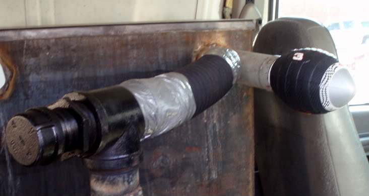

Mine is partially homemade,thats because engineers dont do the maintanence.
