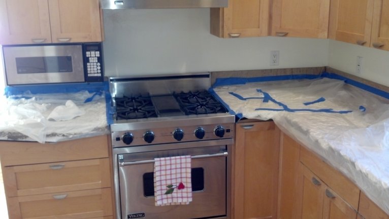

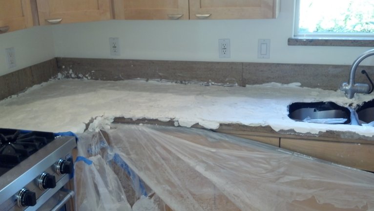

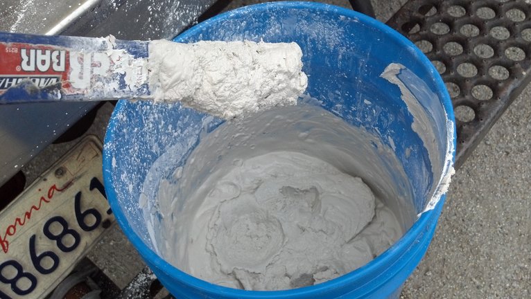

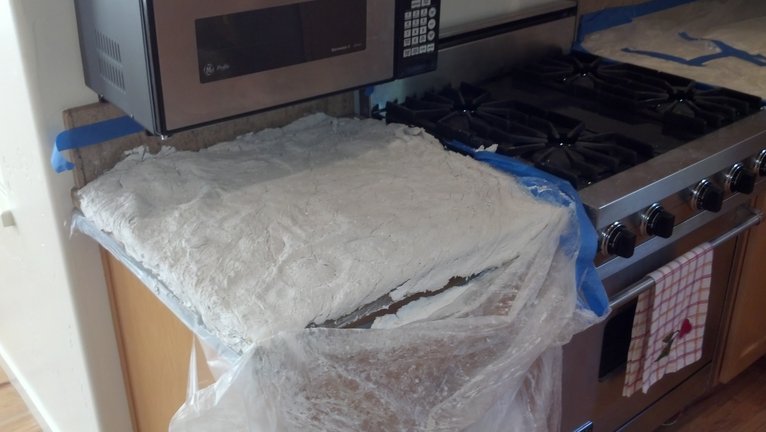

I wondered why it took you so long to weigh in on this one. :-) I don't use that much acetone in a decade. Yes a bit hazardous to evaporate that much in a confined place.
Blame the people who have almost banned fire-safe 1,1,1 trike!

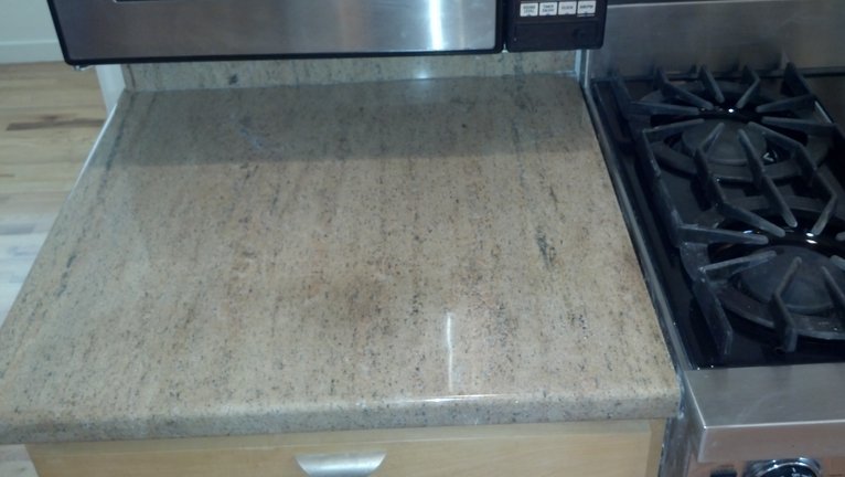

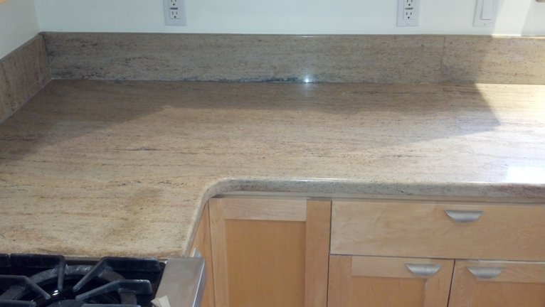

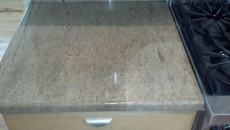

Nice work!!
I hate to say it but you may just be another 1-2 lbs away from pulling those last 2-3 dark areas out.

I really pity you today, Mike.
116,981
I told her that but she is done spending money on this project is just a rental after all
