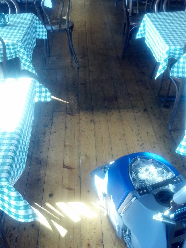

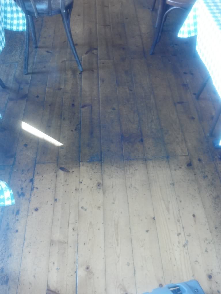

Did a free test at a popular sammich shop today.
night and day.
The mop water residue was so bad it was like they were mopping with brown wood stain.
The Dirt Dragon got some off but I had to whip out the 175 the break it all loose and then rinse/dry with the DD.
The Basic chems work great just not sure how cost effective they are @ a 4 to 1 ratio.
I'ts maxing how well the machine rinses and how quickly it drys the floor. Very little chance of over wetting.

Mikey P said:
well its a clean ******* pine tree now and they are going to pay me a buck a foot to clean and apply a one coat sealer.
Thats a lot of sandwiches!
cool....you'll bank some jack cleaning and putting a semi-shine on some uglyazz spruce
on a serious note, doesn't the water and water based finishes raise the grain on the wood?
not that it matters on that crappy barn floor
