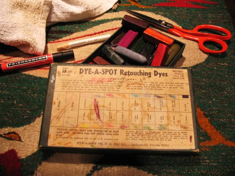

Had an opportunity to use these today. The kit is from the fifties.
Greenie
6,820
Any reason you would not neutralize the bleach first?
I have visions of steaming over it with the wand, removing some of the crayon, and activating the non-neutralized bleach, spreading it.
harryhides
4,429
Canada
Tony
Interesting vision there Jeff.
You should try cleaning with one of those glide thingys so that you do not flood the carpet as you clean plus tweaking your tm properly will result in a dry carpet in seconds flat with no time for any bleach to spread. :p
What I do know because I've tested is that a properly heat set crayon stain cannot be removed even a little with straight bleach.
I don't think that you can "spread a bleach stain" by adding more water through steam-cleaning but have not tested this out.
What I do know is that a bleach stain that is not completely neutralized ( and there is no way to know ) can fade the liquid dyes used to repair the faded carpet fibers without any water being added. Just some moisture from a humid day. I know this because I've had to re-re-dye a couple of dye jobs that I had done over the years..
Final point is that the crayoned areas tend to be much more water resistant than the surrounding areas because of the thin layer of wax.
