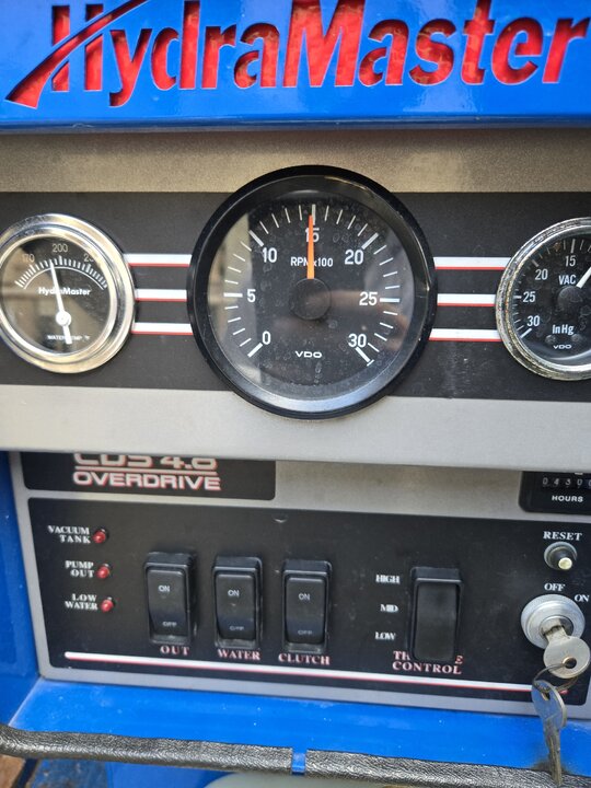

Gauge goes crazy
Dwain Ray
Jul 22, 2020
389
That's some serious reading material there Dwain! Oh man, I don't know. I feel like I need to do some soul searching and see if I am ready and willing to get that deep into vehicle repair. Thanks for the reality check and offer to help Dwain.
Maybe today I'll get some MAF cleaner, do the vacuum test you described going up hill with the heat blasting, and if that doesn't reveal the issue I'll see how much the 02 sensors cost. I can rent a fuel pressure gauge and test the fuel system (maybe I should just buy one), I read that a bad fuel pump, filter, or regulator can cause this issue too. If after looking into and addressing all those things it doesn't improve then I'll pass it off to a professional mechanic.
Thanks for the tips Dwain, seriously. I'll keep you posted how the diagnosis and repairs go brother.

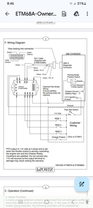

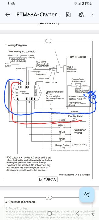

Interesting. Is your machine a pto style with a throttle controller? I'd of spent a lot of money this past month having things fixed if I didn't do it all myself. Parts alone were like $1500. I imagine the labor would have been much more. Learning as I go.
I discovered a broken ground wire to the throttle controller this morning and fixed it before we got on the road. The machine ran fine for a few hours this morning with zero interruptions, hopefully it is good for now. I'll see on Monday when we have our next jobs. If we get through each of them without a shut down then I'll consider it fixed 🙏. Maybe then I'll get at least a few weeks of solid use before the next trial 😄

Was the wire connected to a dedicated body ground or just screwed into the sheet metal? If it was did you connect up to a proper ground?
I read you say that before and sure enough it was connected to sheet metal. I had little time before we hit the road so I just reconnected it where it already was for now. Not sure where proper ground is and was going to read about it tonight. I suppose any factory accessory ground wire would run back to proper vehicle ground, so maybe I can just look for one of those and follow it.
Curious though, I've seen some factory ground wires running off the battery directly to the sheet metal in the engine compartment. If the sheet metal is bare, why wouldn't it make proper ground?
Dwain Ray
Jul 22, 2020
389
If you remove the side plastic panel along side your park brake pedal youll find a proper body ground. Theres probably several more under the dashboard but i know where that one is. What your looking for when looking for a proper body ground is manufacturers wires already grounded to a bolt not a screw most likely 10mm socket required
The sheet metal can and will make a good ground if done properly. Heavy emphasis on properly sheet metal screw doesn't qualify . When you find a manufacturer ground youll find a threded bolt not a screw and will have a nut welded on the backing so the ground gets a good solid connection sheet metal screws are notorious for vibrating loose and causing interrupted connection and possible damage to sensitive Electronics ( like a throttle controller ) heres another thought. Now that youve found and positively identified a problem with the controllers wiring, is your old controller really defective?
Great tips Dwain. It helps me to understand why something should be done. Knowing the sheet metal just doesn't hold typical screws very well over time with vibration makes a lot of sense. I'll do it right.

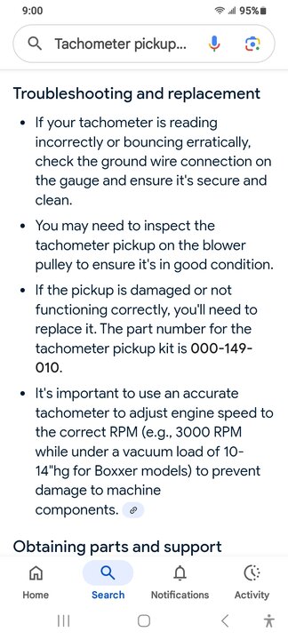

Yea good question about the old controller. It was behaving different, only 1 rpm mode would work, but then at the end nothing worked as this new one now did. Also even at the end it would rev up to 1100 rpm at first then slowly fall down to van idle at 600rpm. So I don't know, maybe it was fine. But it had some weird issus. The previous owner also told me he couldn't figure out how to get low, medium, and high settings to work. For the last year of its use it would only run on high.
