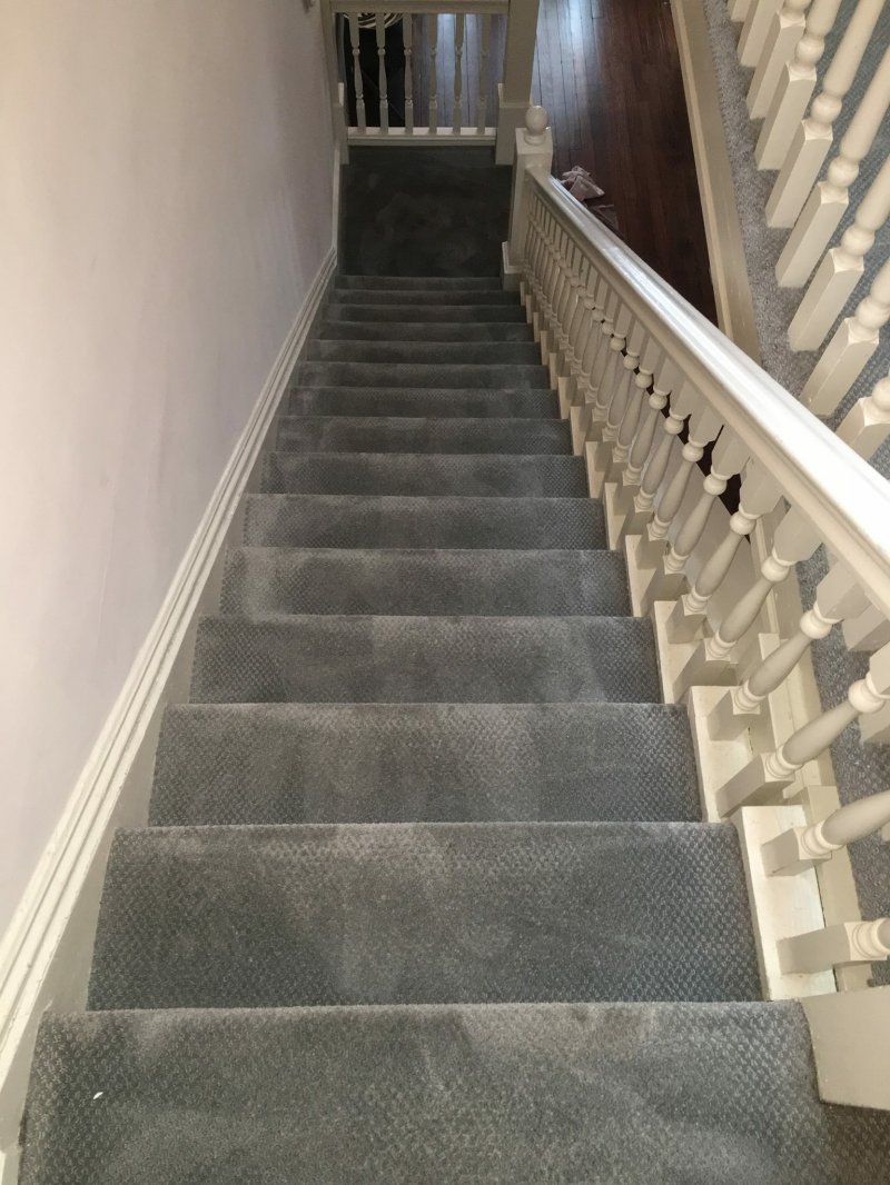

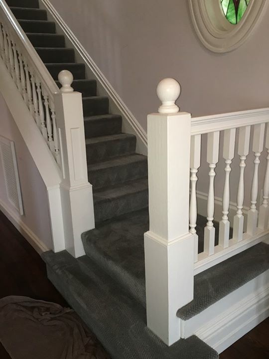

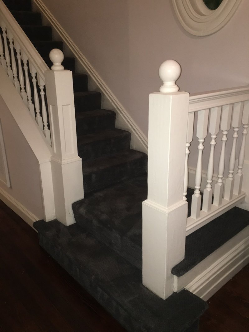

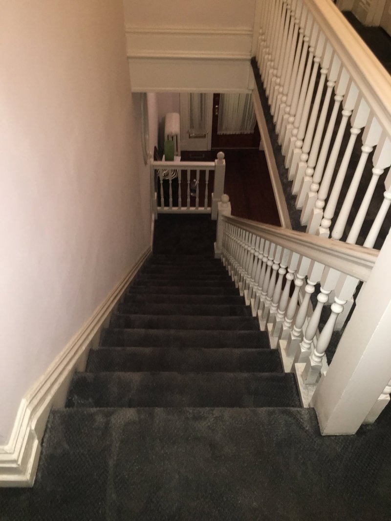

Nice job my technician completed today while I'm conducting a training in New Hampshire. Complete color change throughout a house. He took a light gray and changed it to a darker gray.
Dyes are guaranteed permanent and colorfast for the life of the carpet. Carpet maybe walked on 30 seconds after dyes have been applied.
Carpet dyeing saves you up to 80% as compared to the cost of new carpet replacement.

Hey Chris. What do you guys spray with and do you have to protect the walls? How the heck did he do that so quick with those stairs involved?
It does look better not quite as dated. I think if I were moving out I'd dye it to help sell it. If I were moving in I'd replace it.
It looks better but its still not new. New house, I'd want new carpet.

Kevin, we use a dye wand for apply the dye for jobs like this. Here's a video that will illustrate how we do it.
We use a dye shield to keep the dyes off of the walls. Having said that, the dyes will usually wipe off of the walls with a rag very easily.

I could see this as a great selling aid to a homeowner. Chris, does the dye even out light and dark areas, or do they remain relatively different?

Thanks, Coastie. The dye evens out just fine. You really don't see the TrueColor until the carpet is fully dry. This particular carpet had quite a bit of shading, depending on the direction the pile was laying.

Do you use a spray shield along the baseboards, or tape and mask? Would an airless spray gun be appropriate, or would it over-atomize the dye? Videos all mke me think the end result tends to be a bit blotchy.

Actually, we almost always use a spray shield. I'd say about 1 out of every 500 carpets that we dye turn out splotchy. This is nearly always a result of HEAPS of detergent residues that were left behind from previous improper cleanings.

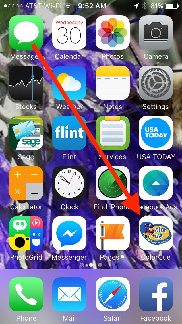

We no longer use Palettes. It was far too cumbersome and had features that made it very confusing. We are now exclusively using the ColorCue app which automatically calculates all of the colors for you. It permits you to simply take a picture of the carpet or rug and will then automatically measure all of the colors and show you exactly which colors are needed in the precise amounts. No more guesswork.
