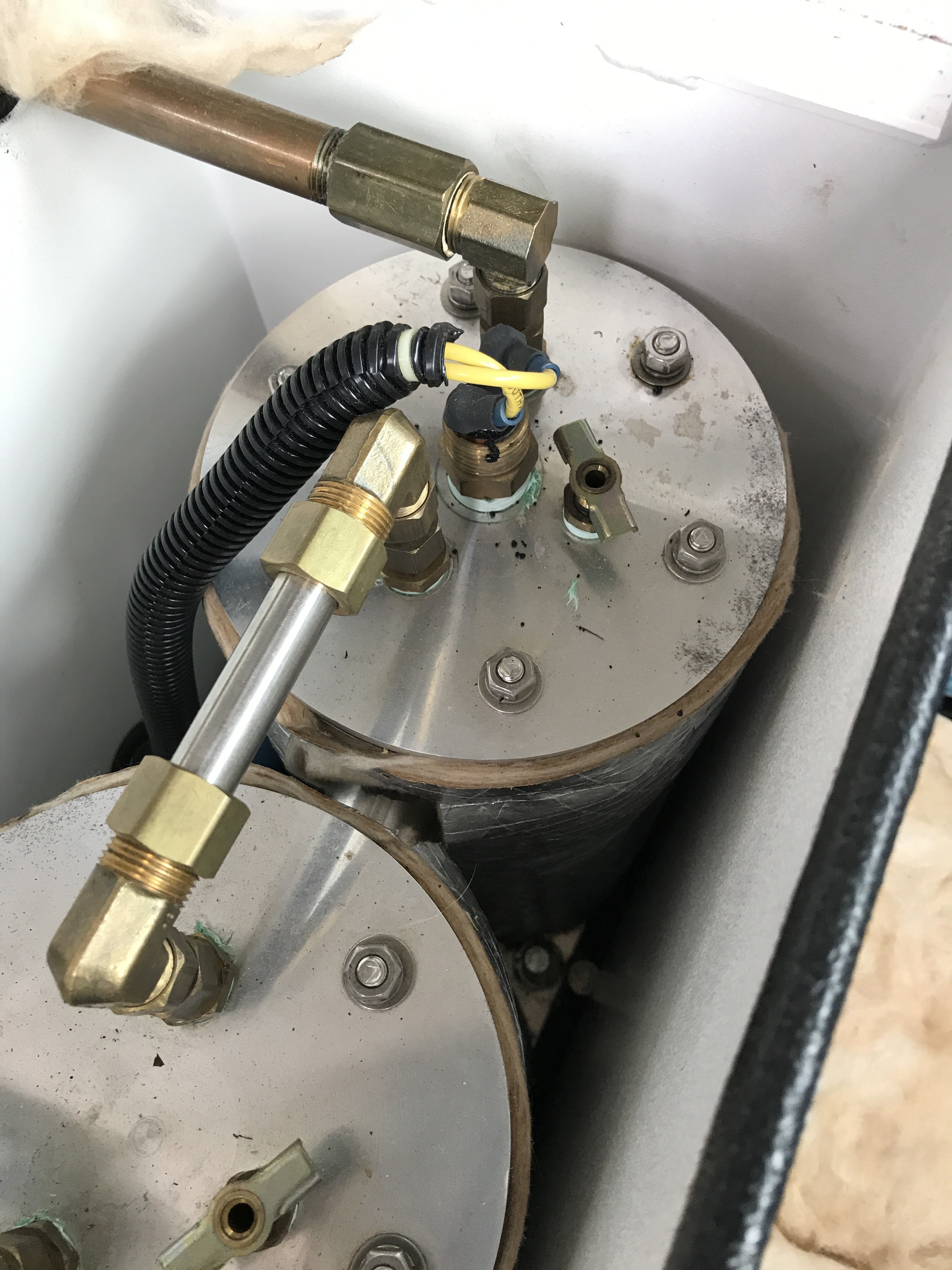

I’m trying to bleed the air out of my heat exchangers
So far, it’s required the use of a Phillips screwdriver, a flat head screwdriver and a pair of pliers.
And I’ve been looking at it for 30 minutes
Can you park your van on an incline with the heat exchanger lower than usual to assist the air coming out? Butler has us do that on the high heat models because the heat exchanger is higher on those. Works for us. Just open your petcock and accelerate your engine a bit.

Rob Grady
Cleaning Professional
Jan 31, 2016
637
Rob Grady
Check these out Marty. Simple solution to a common problem. Getting prepped for this winter's project build.

Maybe bleed them when the TM is semi Hot to speed up the process? I bleed mine nearly everyday and only takes seconds.
