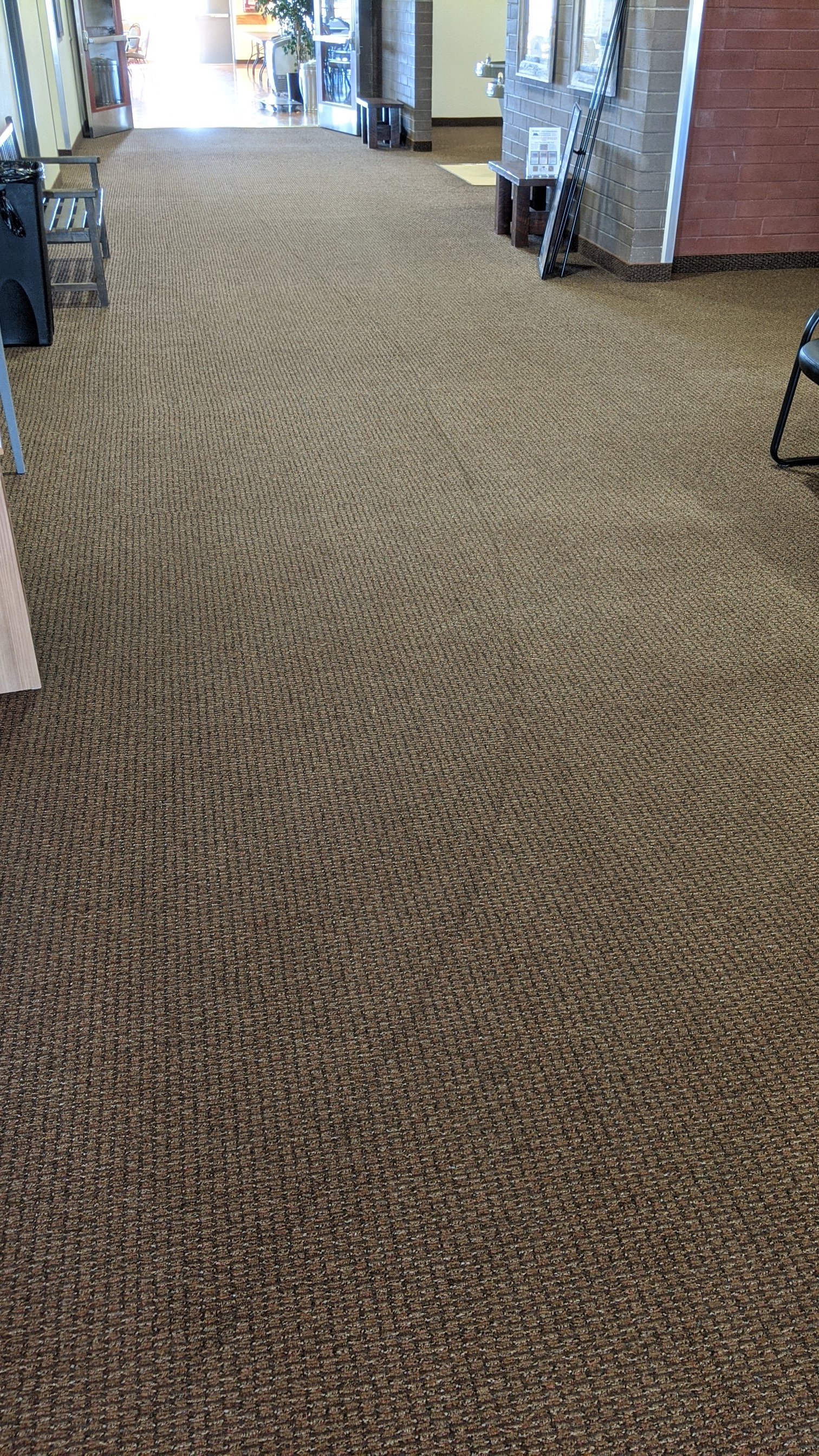

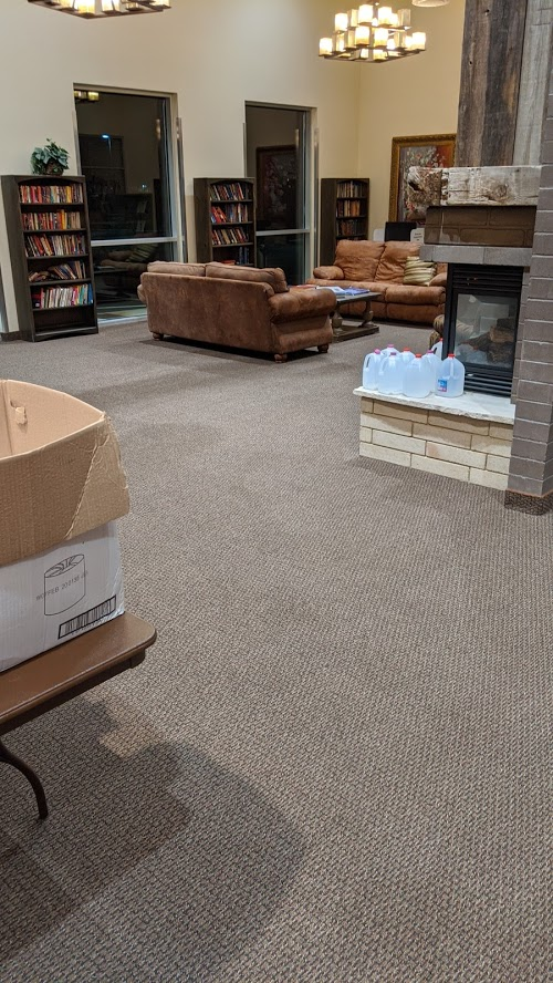

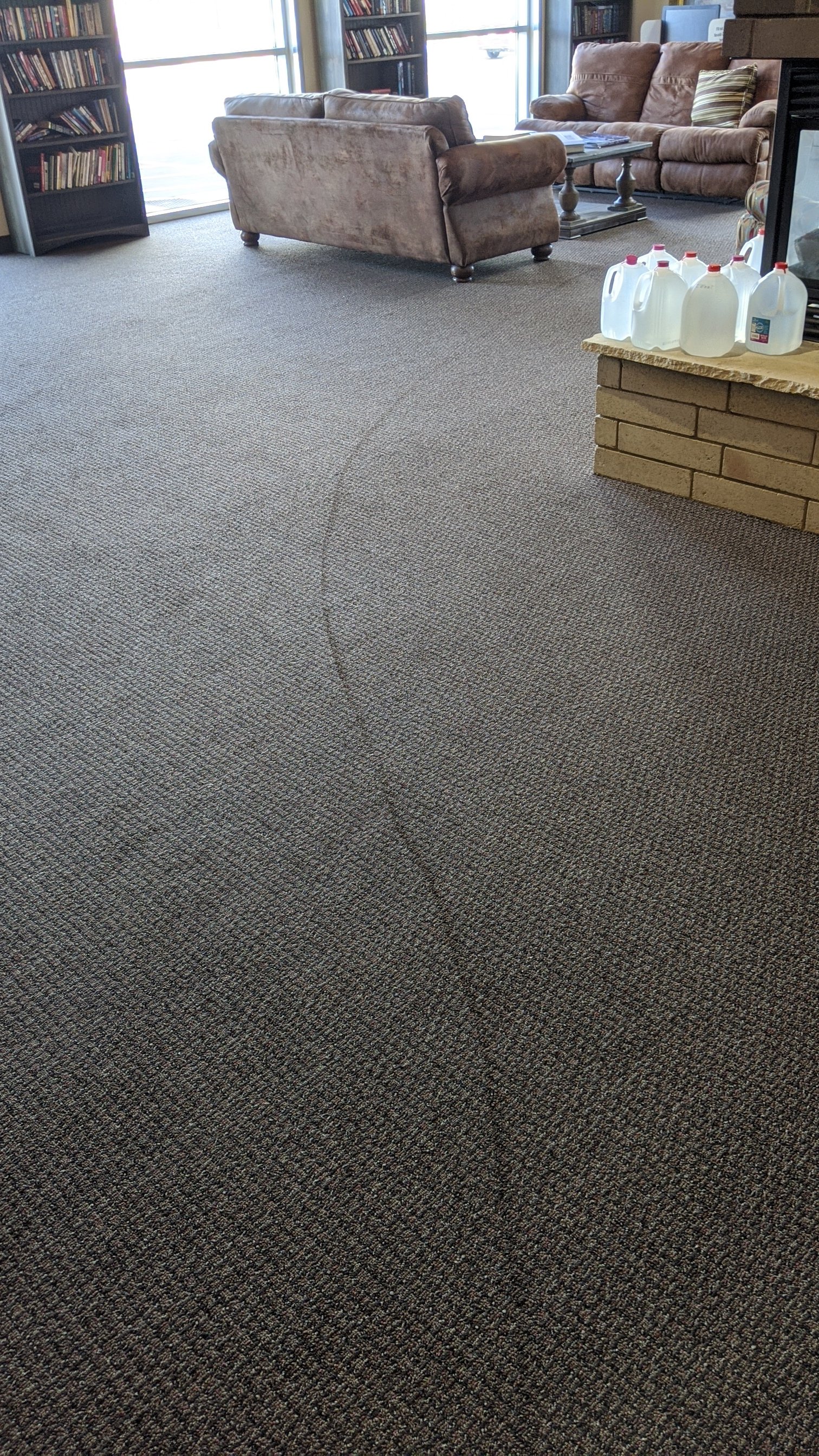

How long did you work on those friction burns? I've come across a lot of those in apt and condo hallways. Seems with the right equipment, you can make quite the difference.
117,345
Upon serious deep introverted thought and a preponderance of calculation, I would speculate that I dallied for 30 to 40 exasperating minutes on this effort, my verbose compadre to the north..

I don;t think it was a friction burn(melted fibers), probably a dragged garbage bag. Only one line, no way to drag a couch that far on one leg. Sorry to burst your hero status today........
117,345
You fn people...
You think I can't tell a friction burn from a drink drip?
Maybe I'll go tell the guys who caused it and confessed that the sofa must have "leaked"...
SMFFH...

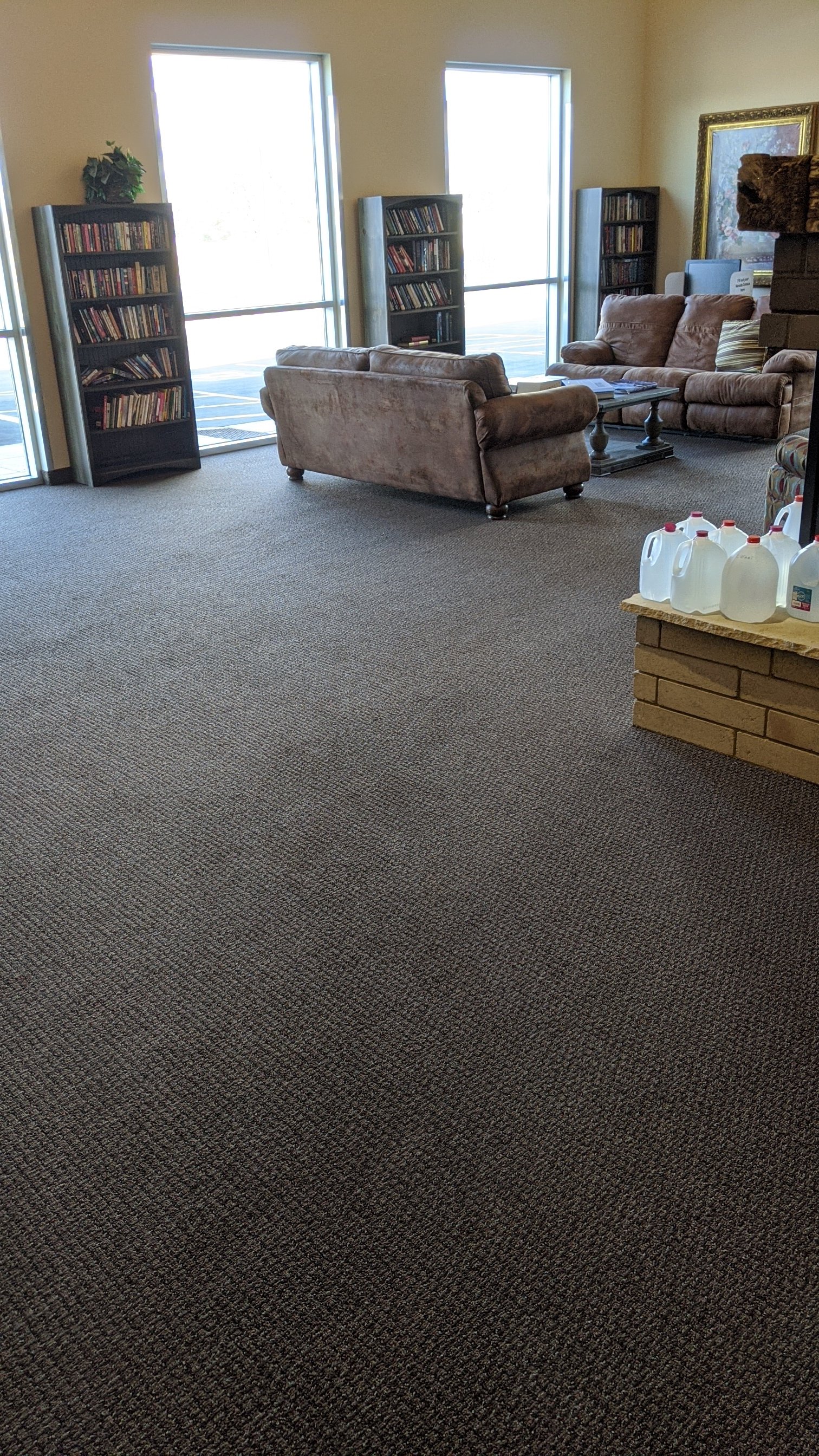

Got it looking fine and they’ll never know. Saved the carpet and the janitor’s bacon.

Personally, I still cannot see melted plastic fibers being restored, and the pile being raised to hide the friction burn marks.
Just my honest opinion.
