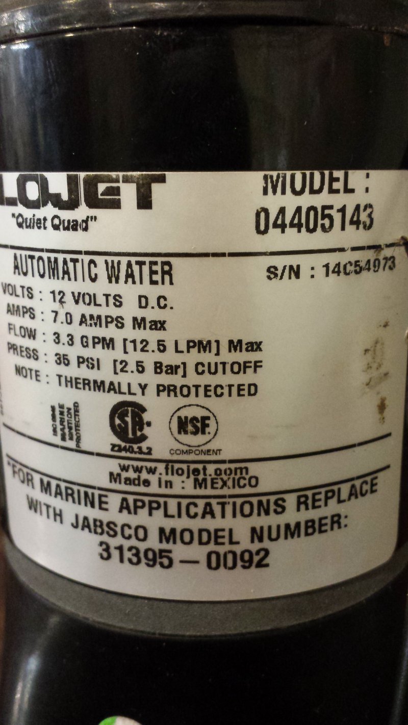

I have been having problems with my pump over heating it says:
So I took out my accumulator tank and it still over heats.. Is it just the wrong pump for the prochem water box or what is going on here? It's OK for a while but it I have bigger jobs it shuts off due to high temps..

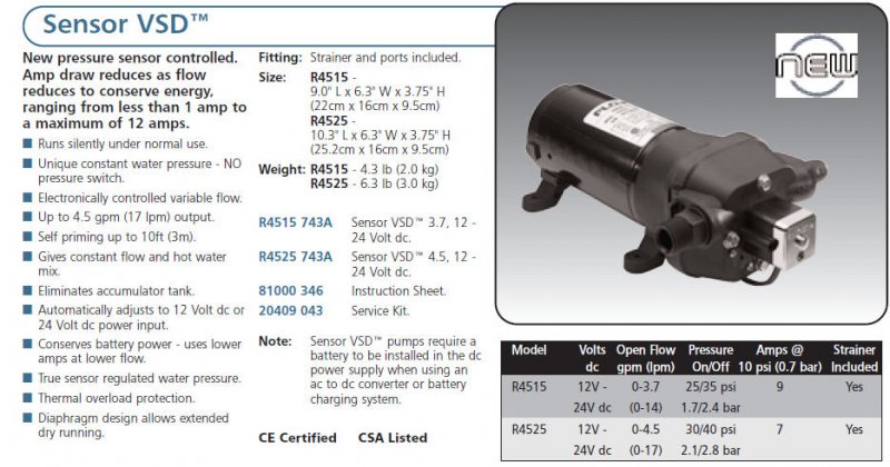

I imagine your water box valve cycles the pump often enough to overheat it on long jobs. The pressure switch is rated for only so many cycles as well. You might consider one of the newer VSD pumps. They use a pressure sensor and variable speed instead of a pressure switch. The Flojet R4515 743A is a good match to your specs:
http://www.rvautoparts.com/Flojet-Water-Pump-37-gpm-Sensor-VSD-R4515-743A_p_13760.html
So would you still need the tank?

I never had pump problems before this.. I think I just bought the wrong pump.
I agree with you Gene, I think it has to due to the toilet type valve that leaks when you use any water... It needs to shut off and have some time before it starts up again. I think it runs non stop when we are cleaning. .

It's the chattering that happens when the water starts to shut off. It needs to be a hard stop of water to prevent it. The floats being used are for a garden hose not a demand pump. The chattering is hard on switches and causes heat build up. The halwin switch has a 6" swing and only turns on when the tank is 3" from empty and stays on until it's 2" from the top. The pump never cycles or chatters again. I would direct feed it if the water box was on the bottom. I'll be back in the pump buying business with the 870. I'm not gonna pop a hole in the stainless box. Wouldn't work anyway. Can't wait to try out the new style pump. Thanks Dan didn't know that pump existed.
Gene
