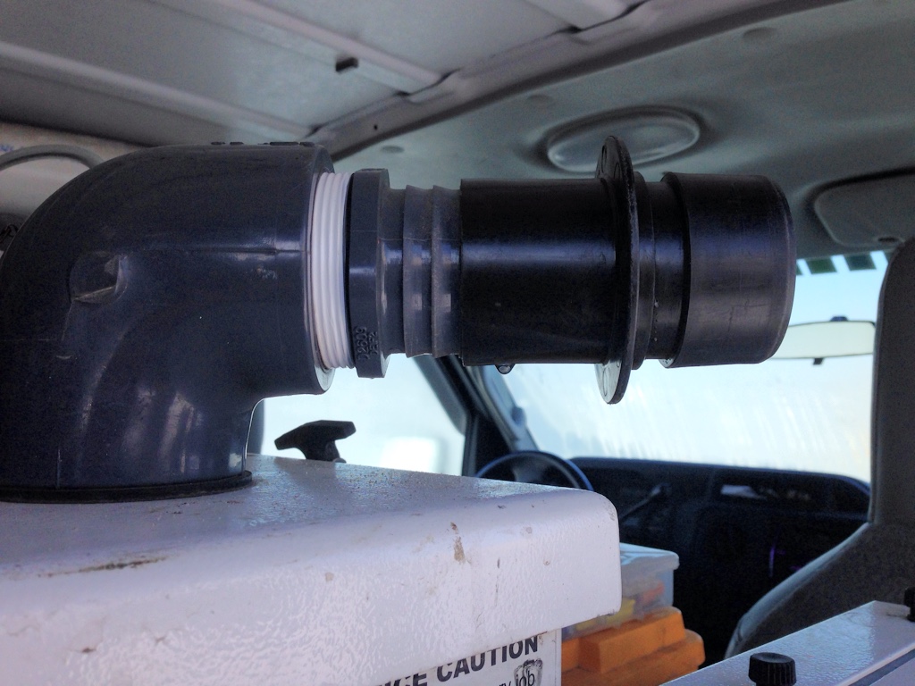

Anyone have a better solution than this stupidity?
Do I just take the barb out?
Thanks!

Have been using a regular cuff to my Devastator but it's COLD and the D freezes up and restricts airflow.

I imagine it's because many TM's have a plain tube for the vac connection - so the slip-on adaptor would be used. A lot of portys have or are modified to accept threaded barbs....

I'm not saying that this will definitely fix your problem, but it sounds like you have a leak somewhere.. The only time I have a freezing issue and I never cancel a job because it's too cold(WI) is if I either have a leak or, I put the hose outside sucking cold air. I don't use a filter so it could just be the water sits in there too long.

Not sure what you're saying. Do you use an inline filter?
The D does fine, even in the 20's maybe even colder but it's just been too cold here the last couple days.
I am usually hooked up to the vac hose so not sucking super cold air.
I work alone so it sometimes takes me a bit longer while prespraying and moving furniture...and hacking with a homeowner.
I ran with the D all last Winter and there were several times where it was an issue and killed my suck, usually did okay. I'm just thinking about switching it up.
As much as I truly love what I do in the nicer months, I'm beginning to question my sanity in these Iowa winters! Just trying to get better.

If it's negative 10 degrees and I have a air leak I will freeze up inside the hose around the connection.. Get yourself a helper, and your problem will go away and you will make MORE money no matter how you roll.
I don't use any filters(I'll call it free flow LOL), though I have a Devastator..

I'll check the connections to & from the D. I know they are not perfectly air tight but didn't think that was the issue...maybe it is.
I know I need a helper. Last Winter we barely made it through alive though and I'm not sure I can bear the additional draw on our funds.
Hiring help is proving to be one of the hardest things for me to do. Not the act of hiring, but letting go of this owner/op life. I have loved working alone for a lot of years.
That and my fear of cold selling are the things I've GOT to get a handle on, if we will ever reach our potential.

What connections do you use to and from the D? I know I'll never be totally air tight with Flash cuffs.
I've got a male Cool cuff (I think) on the machine side of the D. That one is better but not air tight either.

Someone suggested last year wrapping a towel around the cuffs. Going to need it today!
Going without the D today. Kind of a PITA when it's cold IMO. No fault of the D probably should have set it up differently.
