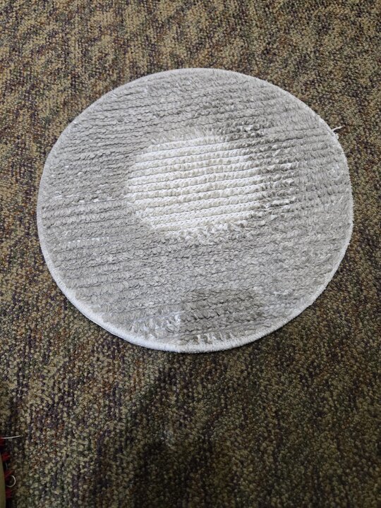

Sometimes you just have to flush the soil out. Like the Walmart entrance.
Emcap only works when you can push the soil down out of sight.
Thats why vacuuming is the first step. You have to make room for what the pads can't pick up.
