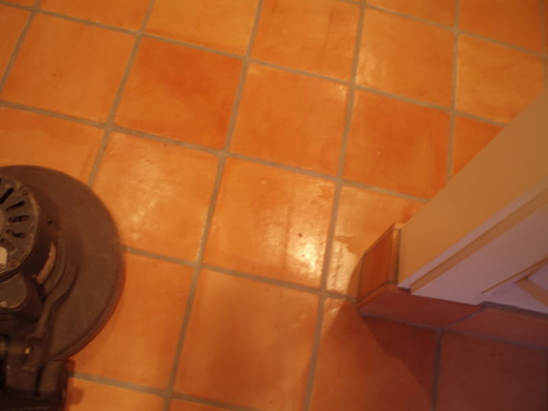

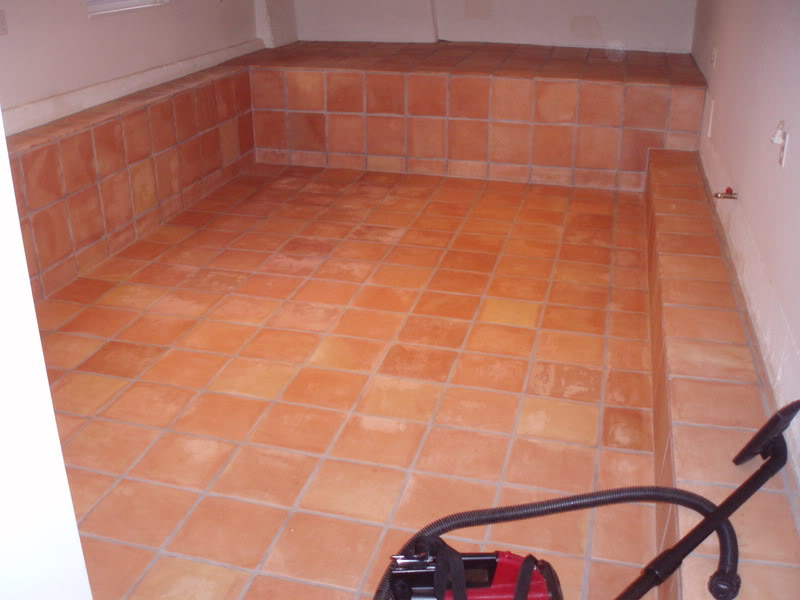

Nice even install with only one coat of some jive acrylic.
700 sq ft.

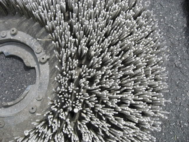

We were able to remove 85% of the sealer with just the dry Nylagrit brush I got recently from Jon Don.

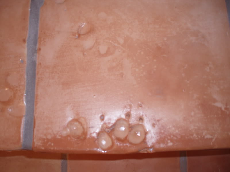

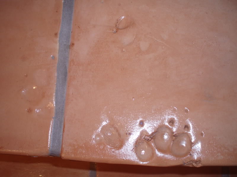

Notice the peel seal near the base board
Gone!

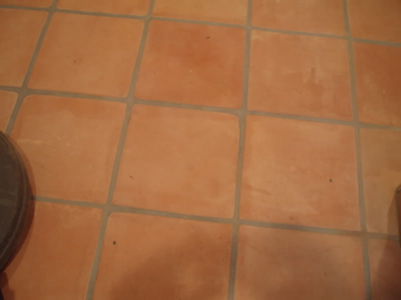

Shiny...
Not shiny

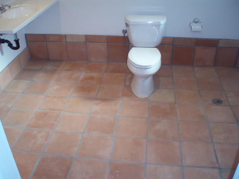

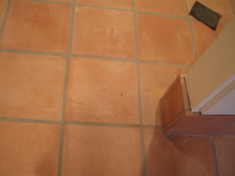

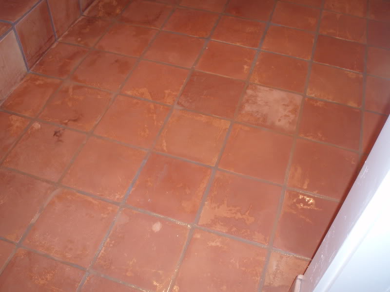

Taking it off the walls

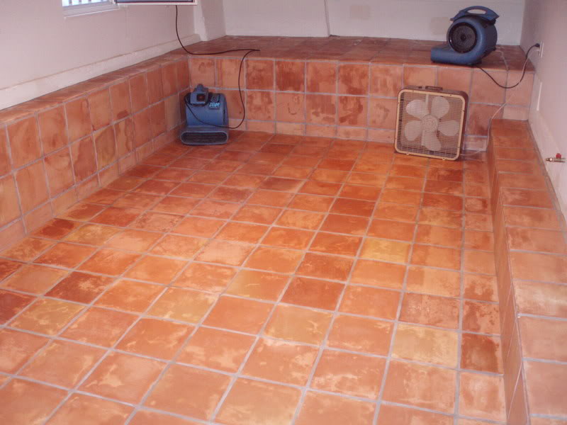

Stripped and drying
I'm going back tomorrow to seal her up.

Have you guys used those on any other hard surface for scrubbing?
These cimex brushes I just got, suck. Looking to go with a little nylo grit action for these dirty commercial joints.
115,991
Concrete, brick and maybe the Lucky Dragon that's gone for 12 years w/o cleaning are the only things I would think that thing is safe on.

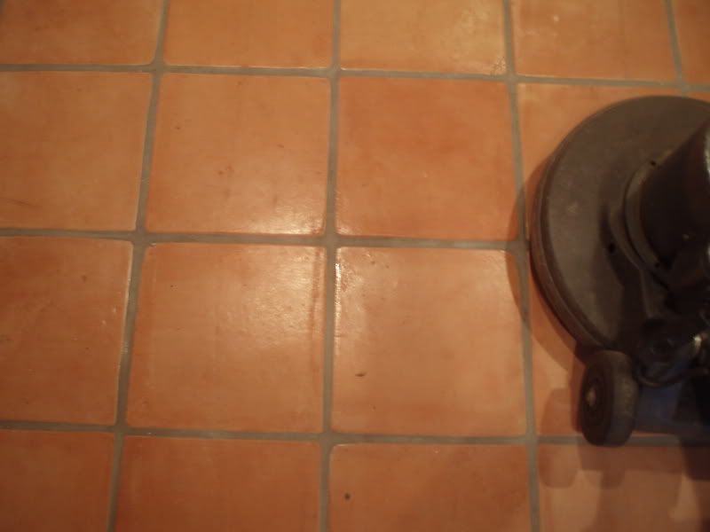

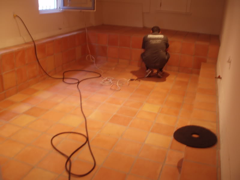

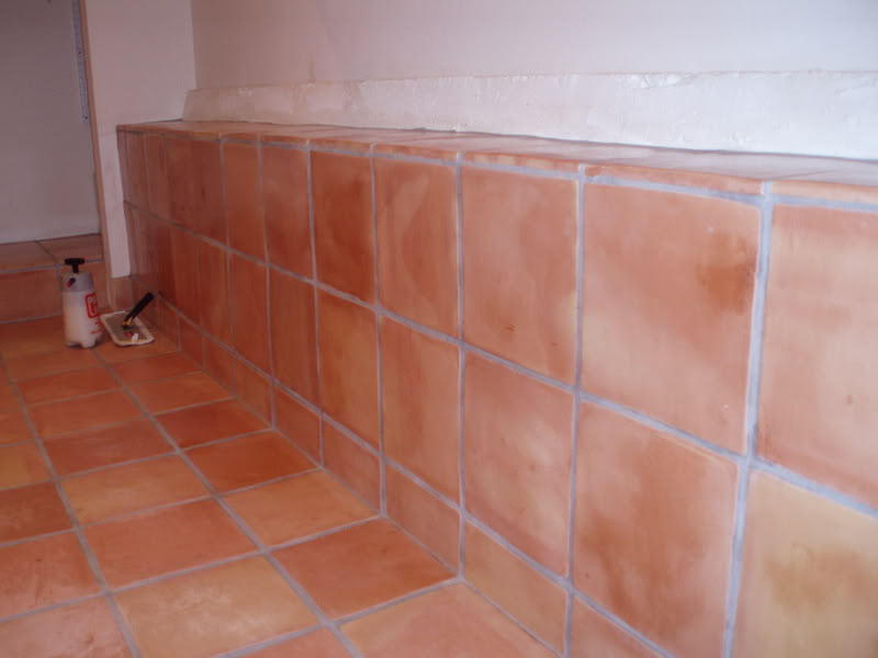

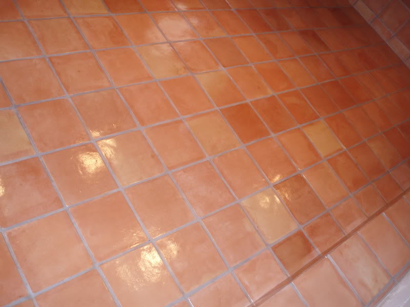

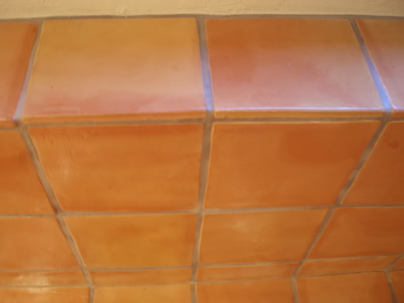

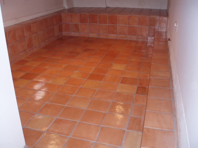

Went back today to find it nice and dry and ready to be sealed up.
After one coat of a Pre Sealer..

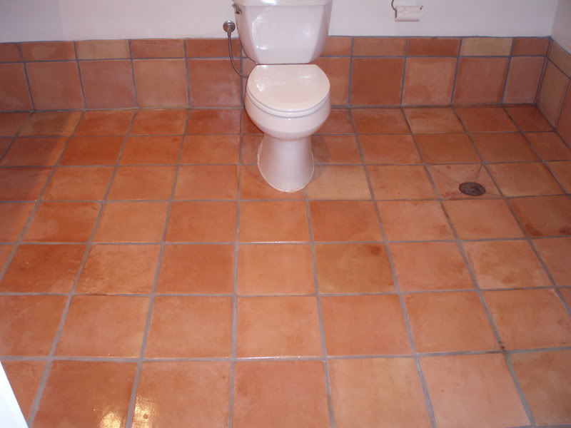

and after 3 coats of wax
Look ma, no drips!
Looking good!

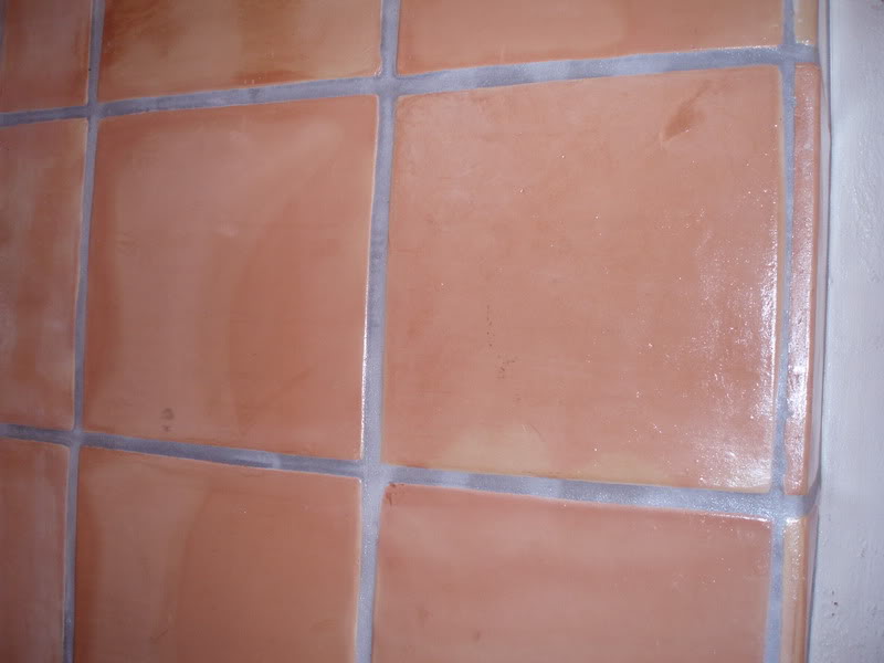

I looked at one today, tile looked great, finish still shiny, no flaking, no scuffs BUT the grout looked darker in traffic areas and kitchen. Question is can you do anything to the grout without messing up the finish? I would assume the grout was waxed too before the grout got dirty. Do you have to strip EVERYthing to get the grout clean? :?

The tile had no dirt in the finish, just the grout looked challenged. I told the client that the tile was fine just dirty grout. I did'nt touch it yet. And i am very reluctant cuz the size and area is approx. 1000+sq ft and a lot of stuff to move.

If you'd had sprayed the grout with some tile cleaner , scrubbed and toweled it off you would not be asking these questions right now.
115,991
If you decide to clean it only, use a neutral pH cleaner, a soft brush, warm water only and keep your pressure under 700 or you'll damage the top coat in one way of the other.
