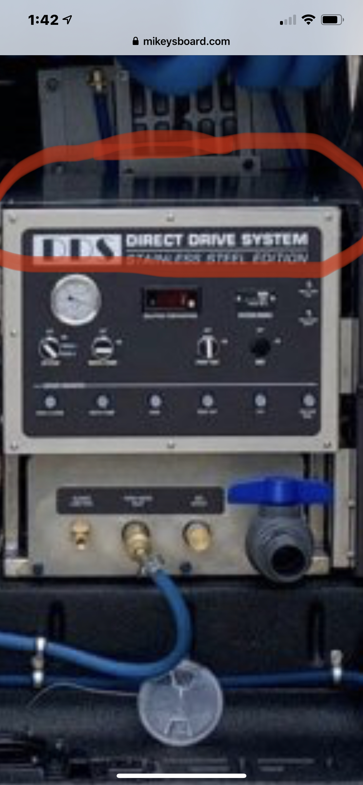

Was there going to be a big reveal? Thought these were made for zerorez or some other franchise
Could we get a small reveal then, slightly bigger than the first few pictures and maybe some additional specs? I’m not concerned who the machine is made for, I’d just like to know more about it.
Dave Rampage
Mar 24, 2010
190
That answers the question; it's a DDS!
PTO is generic - any power take off. DDS is generic - any direct drive system. So I guess we'll have to wait to find out what mechanism AT is using.
CDS (clutch drive system) is trademarked by Hydramaster, so while copying the unit is fair game, the copies have to be called something else.
It has a larger more robust clutch than the cds and butler

Jay Wags
Yes larger clutch
They try to eliminate some of the *weak points of the cds from Hydramaster
More cfm due to the clutch being able to handle more stress and the franchise they originally designed these for have given them great feedback
Also I was told will be priced same as other cds machines

There is no reason the others can't also use a more robust drive system. Pitt, Ogura, and others make higher torque clutches. Going from 6 rib to 8 rib serpentine belts and other tweaks are easy as well.

Doesn't Matter
Exclusively sold through Jon-Don. They have sold over 100 units since 2016 to a customer of JON-DON's. This has given them a chance to tweek any bugs out of it.
