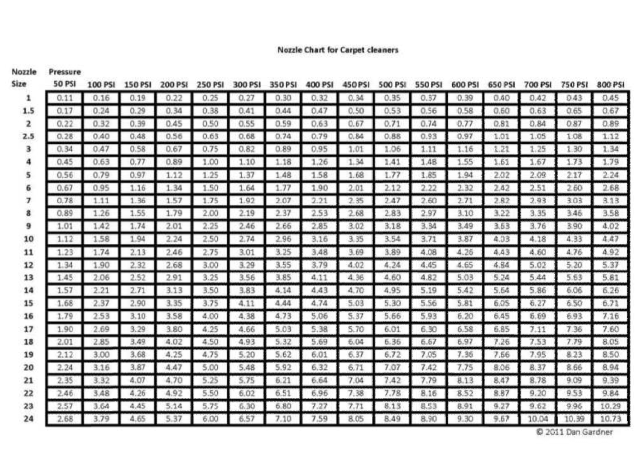

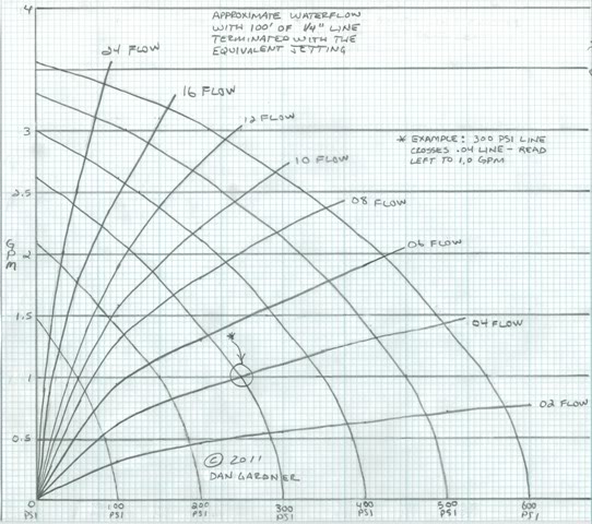

Fred a long time ago we discussed how Vee and Tee jets are "flow rated"..
You would think a 6 flow jet or combination of jets would produce 6 gallons per minute at a set/base PSI...
but no.
Most wands create about a gallon and a half at 6/500
