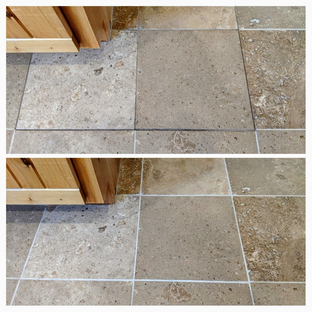

handyman replace these two tiles and match the new grout that dirty old grout well guess what happened after I clean the floor...
SGA to the rescue again

so paper towel as a backer rod?
IMHO over complicated the missing grout repair. just use prism grout- done

My question is why do you it's necessary to use SGA for that situation? Does it break frequently?
115,924
more complicated?
customer has grout in garage.
I have SGA in van.
done.
TP to plug holes so all the SGA doesnt fall into the Bermuda triangle
Prism is a matsa cracker compared to SGA

What do you charge to remove and replace grout , I have roughly 125 sf to do soon, that amount is new challenge.
Tell me more about Prizm and it's strengths and weaknesses.

charge to remove 125 ft? linear ft? charge your hourly rate. a lot of variables, one being how hard the grout is and how delicate the tile edge is. in most situations i would not even be interested.
with prism grout- no grout shading, cures fast, 1/16-1/2 wide.
negs: will scratch polisheds stone, cost more,

And replacing with just grout or sga? Watched a video that only took 1/16 off and put epoxy grout on top. Wasn't sure what ya was gonna do.
