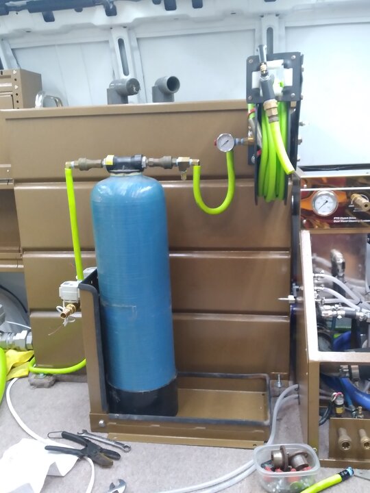

Hey y'all. I'm thinking about incorporating a water softener in my setup. There is a lot of hard water in my area. I want to remove variables and improve my efficiency and results on the job.
What is the lowest/easiest maintenance water softener that has a small footprint you have found? Does it restrict the flow rate of fresh water coming directly from a home?

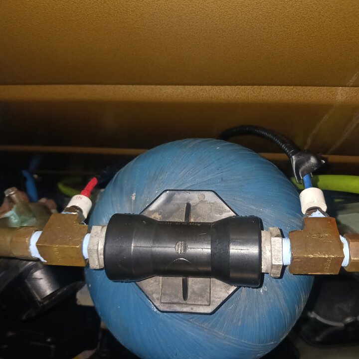

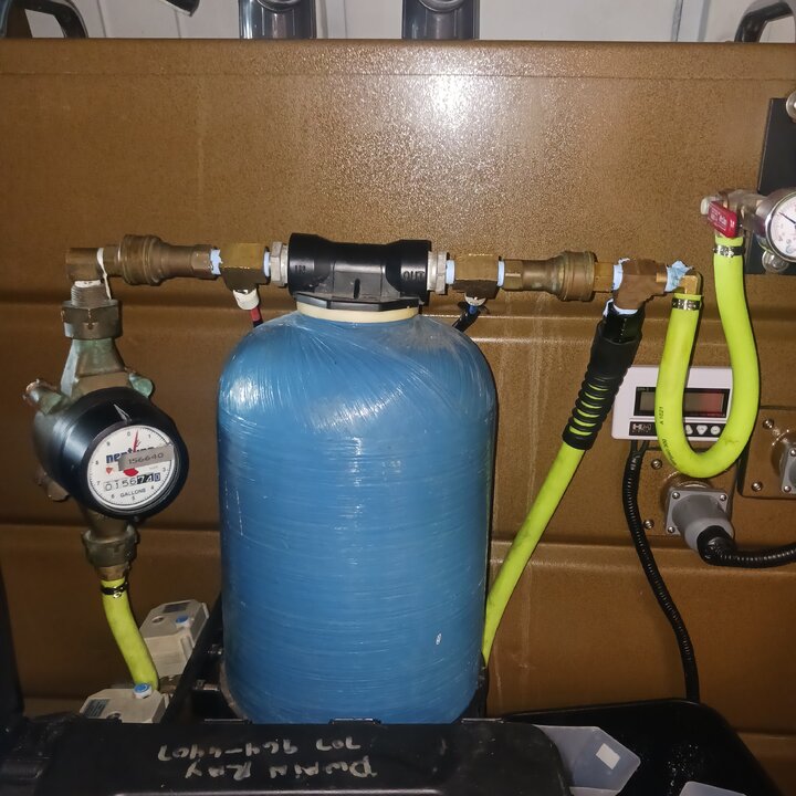

I still use the old prochem softeners.(1 cubic foot) I hear some guys use a little one that they get from Costco. But the amount of time between recharge is (or at least if properly done) a lot shorter ( i also have a flow meter and "kinda hardness meter" installed) you can find them pretty cheap they recharge with a dema valve( like a hydroforce). If you get a used one i recommend replacing the resin. It's supposed to be done every 7 or so years

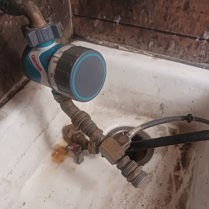

I just had a water softener (Flint and Walling) at my shop and filled my onboard 210 gallon water tanks. Fed the house and shop and had it set to regenerate every 1000 gallons. It has been trouble free for 30+ years except for one timer and installed at 2 different locations.

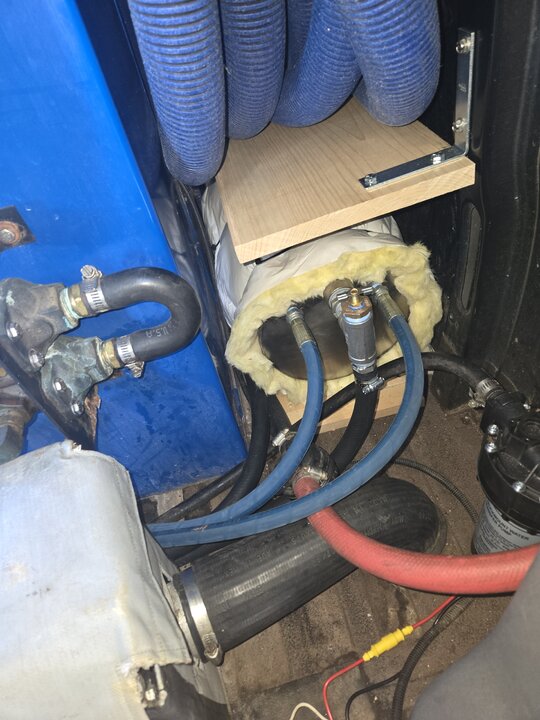

Bleeder valve, water heater insulation, and a shelf so I can still throw extra hose and things back there. All stainless fittings with stainless steel teflon tape, hopefully it doesn't need any attention for 5 to 10 years :]

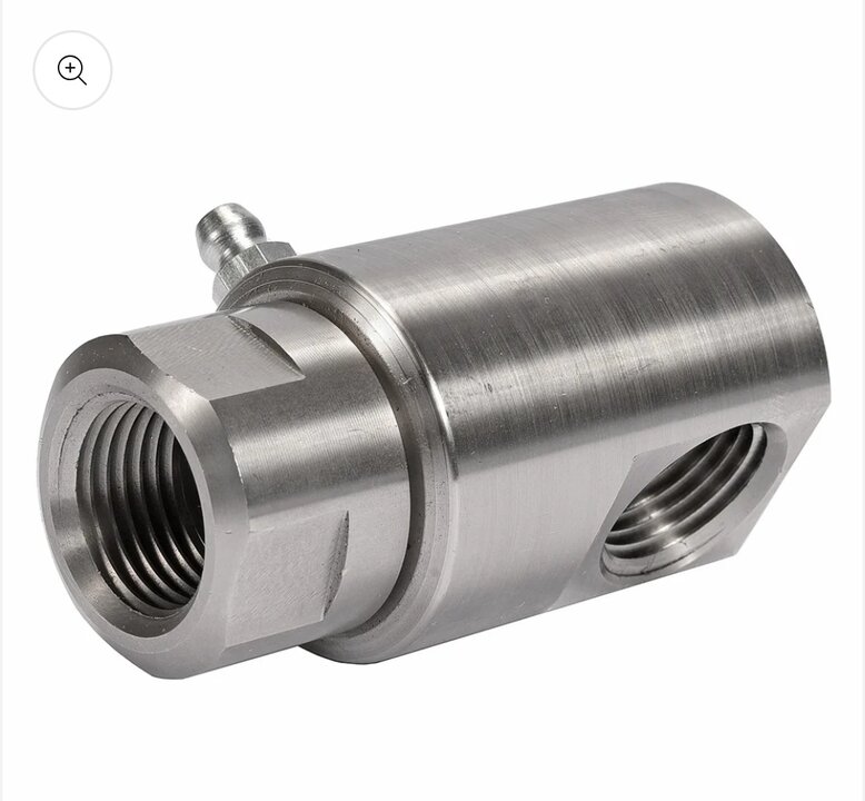

Dwain, I got a new live reel fitting for our garden hose. The old one was seized, the previous owner never greased it. $150 for the swivel fitting, man that's an expensive fitting. But it saves so much of a pain in the butt.

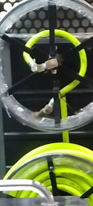

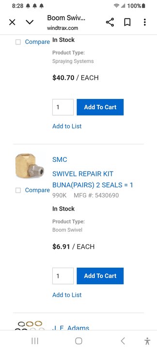

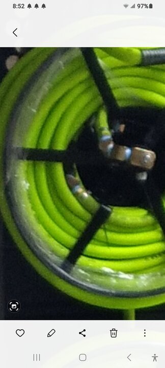

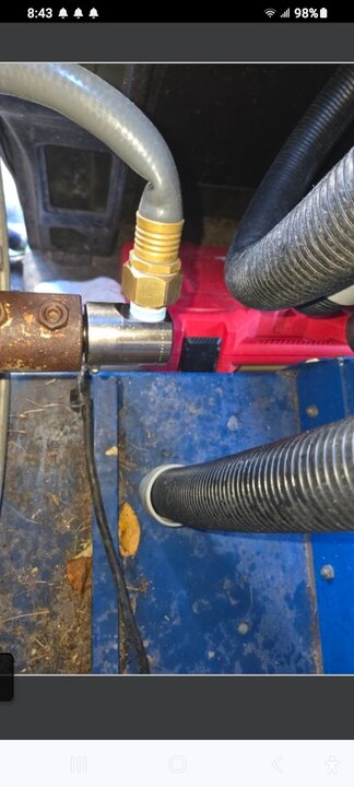

Thats real expensive for a live reel swivel. Thats about what i pay for a rx20 rotary swivel. These are what I've been useing on live reels for as long as i can remember. Every 2 or 3 years i put in a $7 seal kit. I just pop a spring clip off the end, pull the block off, remove & install 2 oring like seals a dab of parker lube oring stick it back on good for a couple more years. I get um from Windtrax car wash supply

You should maybe put a 45°or2 to stop this hose from pinching . I put 2 so as to angle it properly then a short leader hose to a 3/8 qc then my hose has a standard male garden hose fitting to male 3/8 qc. Sorry for the picture quality, I'd taken more and better photos if i knew i was going to use um this way. Instead of expanding and screen shooting parts of the 700+ photos i have of the frankinstien build

I did pay way too much for the swivel fitting. It was just readily available at my supplier when I was in his parking lot replacing a ton of lines and fittings on my machine. It is really nice though, and has a grease fitting on it. Hopefully it will last for many years.

I used my Blue Baron heat exchanger for the first time today. The thermal relief valve is shot and my waste tank kept filling up. I'll clamp the rubber hose shut or install a brass plug for now until the new one shows up.
The heat is great, it takes a long time to make its way to my wand though. The system heats quickly when I fire up the tm and open the valve to allow hot coolant to flow into my hx. There is just a lot of cool water in the 150+ feet of solution line that needs to get out of the way. I suppose I should blow off a lot of water through a tool before I go in and start cleaning so I can utilize heat on my first wand passes...
The heating capacity is deep though. Seems like the more I pull on it the hotter everything gets. There is 80 feet of tubing in the Blue Baron hx, and I added about 4 gallons of engine coolant to install it ✨
