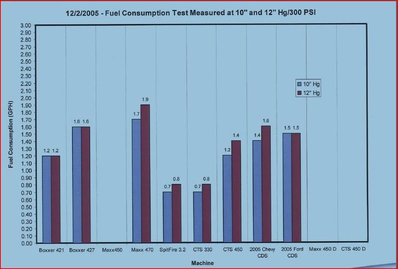

Put a #4 blower set at 14"hg running 2.5" vac hose against a #4 blower set at 17"hg and running 2" hose, and the lower lift, larger hose set up will dry better every single time, all the while conserving fuel and wear.
