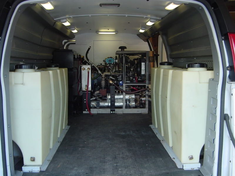

I have them installed in a Chevy 3500 extented. Dimension between tanks at the base(floor level) is 42". Half way up the tanks swell a little and that dimension between is 41".

I like how balanced the weight is with these tanks. The one thing to keep in mind though is you don't end up with much wall space to hang things. With a tall/narrow vac hose reel in the right rear I have just enough room to fit my Cimex(which I don't carry all the time) beside it on the left rear. The space above the tanks is used for chems, bucket, small snail fans, etc.

Wow Shane
I love the wall and ceiling panels along with the lighting. My hose reel is 18" wide (175' hose) and another 8" for solution reel. I think I'd have enough space between. I need to carry an 18" wide portable around from time to time.
