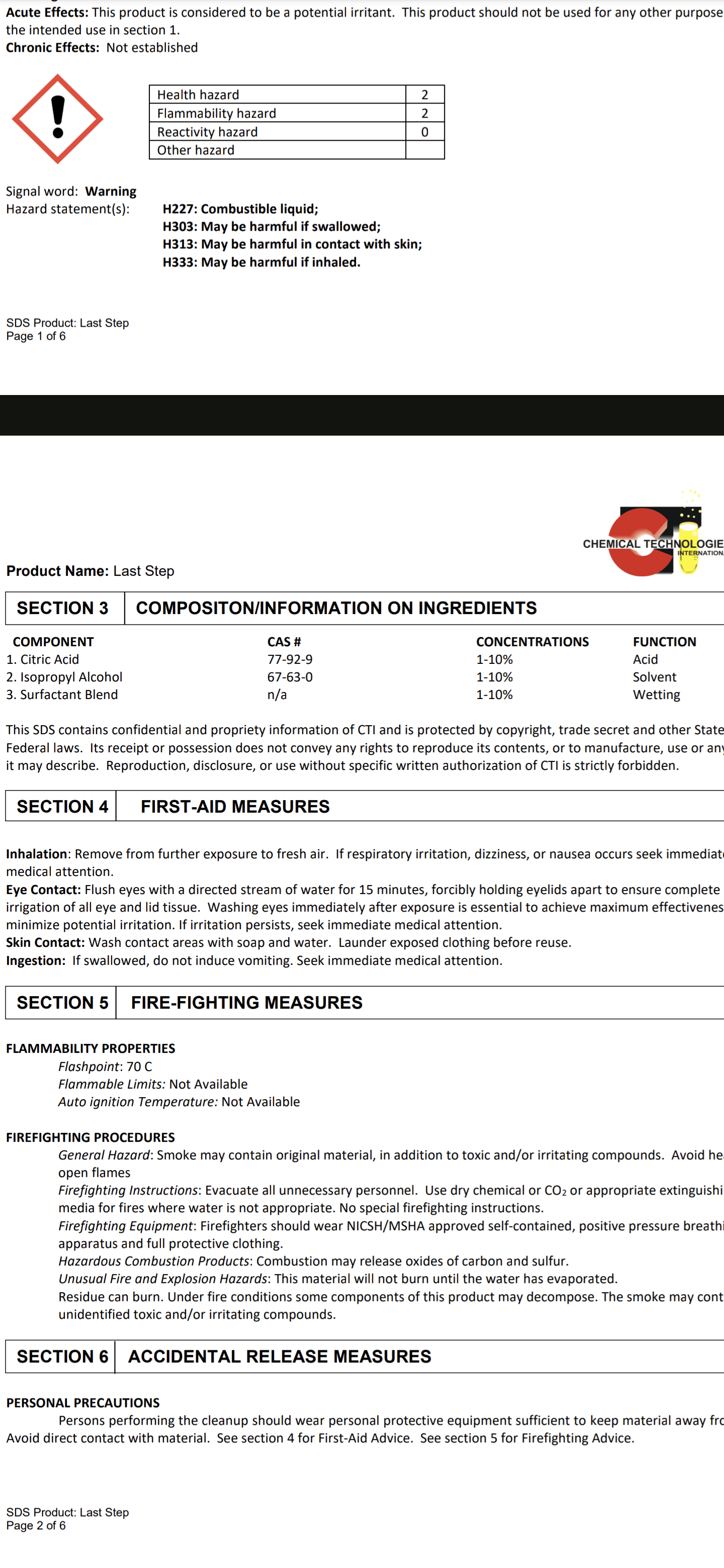

Lea put alcohol in 02 rinse CTI uses it in last step rinse. I believe prochem used it too.
Reactions: Condog

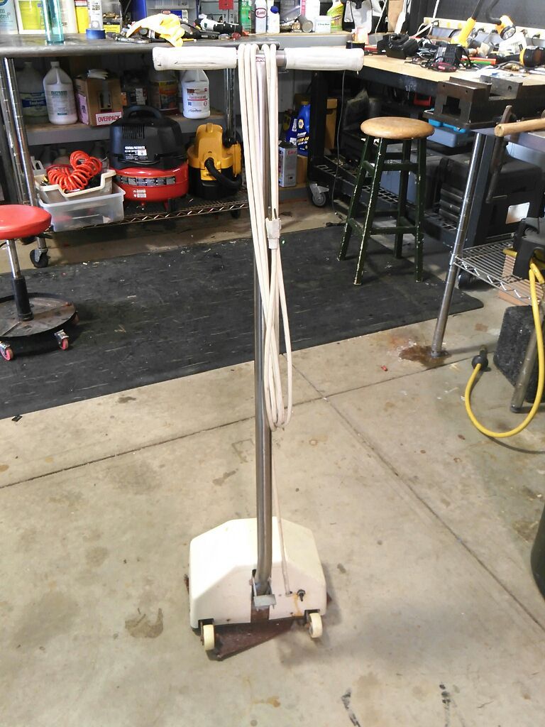

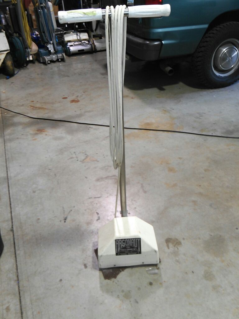

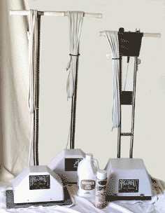

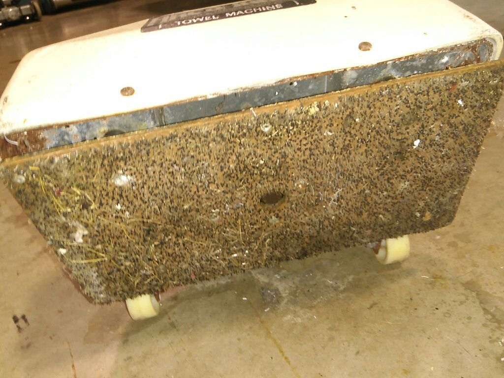

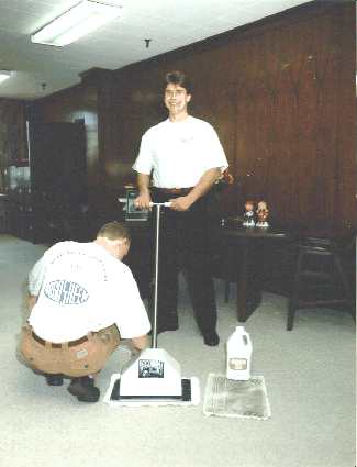

Didn't they have a square pad machine at one time?
Reactions: Jim Pemberton
Yes...argonaut
ARGONAUT PLUS TOWEL MACHINE
Reciprocating motion 16 1/4" x 10" stationary pad holder 15 pounds, 115 volt, 1/8 hp motor, 5 amp , 1700 rpm free. Use with ARGOSHEEN and all cotton pads for removal of soil. Also available with 220 volt motor for Europe.
ARGONAUT SUPER TOWEL MACHINE
Reciprocating motion 10" x 12" or 16 1/4" x 10" stationary pad holder, 35 pounds, 115 volt, 1/4 hp single phase motor, 5.6 amp , 1725 rpm. Use with ARGOSHEEN and all cotton pads for removal of soil. Also available with 220 volt motor for Europe.

He did well with Argosheen for awhile when he wanted to improve over shampoo and avoid “steam cleaning”.
Back then people thought if your stuff smelled like a toxic waste dump, it must be really good.

I watched a cleaning supply company video and they said drying time can be accelerated by adding up to a 1/4 cup to a cup of rubbing alcohol to cleaning solutions.
I read on a FB post that ReleaseIt had isopropyl alcohol as one of its main ingredients (I'm not saying it does, just that I read it does).
Does anyone have knowledge with experience doing this?
Releasit does contain Isopropyl Alcohol. But it's not a "main ingredient".
Reactions: Condog
