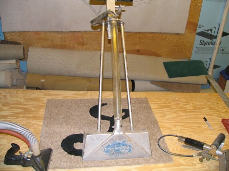

We have a 9 jet 24" that we use to clean new and event carpets. If your not dealing with a large soil load they work fine. One of our customers has about 20,000 sqft that we extract monthly it's never dirty and only takes 1 tech 4-5 hours since it's open space. On new construction the floor usually hasn't warped yet and cresting isn't a problem.

thanks for the explanation and the pic. never saw one like that before. i do have a power head that is 14inches wide that weighs like 50 pounds. i could see how it could wear ya out.

Basically got started with a Drag Wand and used them for everything. Used to take my truck mount off the truck and roll it into JC Penney Stores and Sears Stores and clean from 30-60,000 sf from Sat. night until early Monday mornings, all with Drag Wands.
Always used them in residential, Steam Genie's 16 inch and 24 inch. Always shampooed the carpets so all I needed to do wash flush out the suspended soil. Used the drag wand up until about 8 years ago when I started using portable equipment but even with this I use a form of drag wand process still.
This thread brought back a lot of memories.
Here is a picture of the one I still have left.
People love to see the dirt coming up the clear tube.
