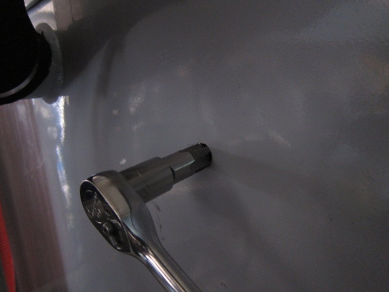

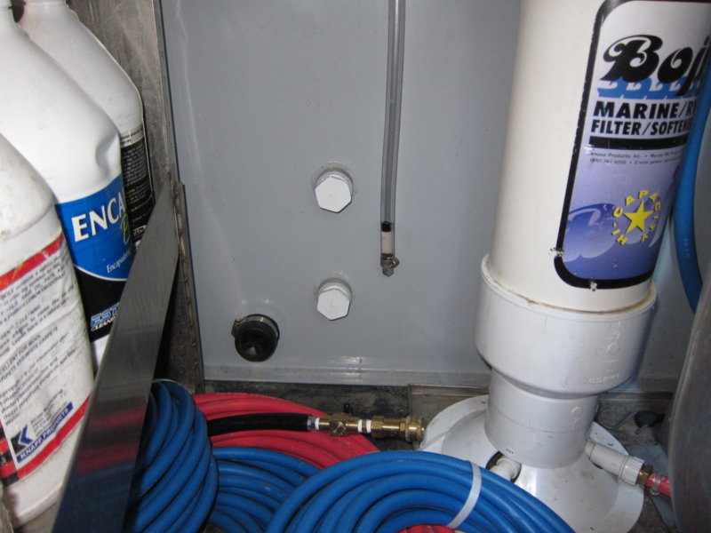

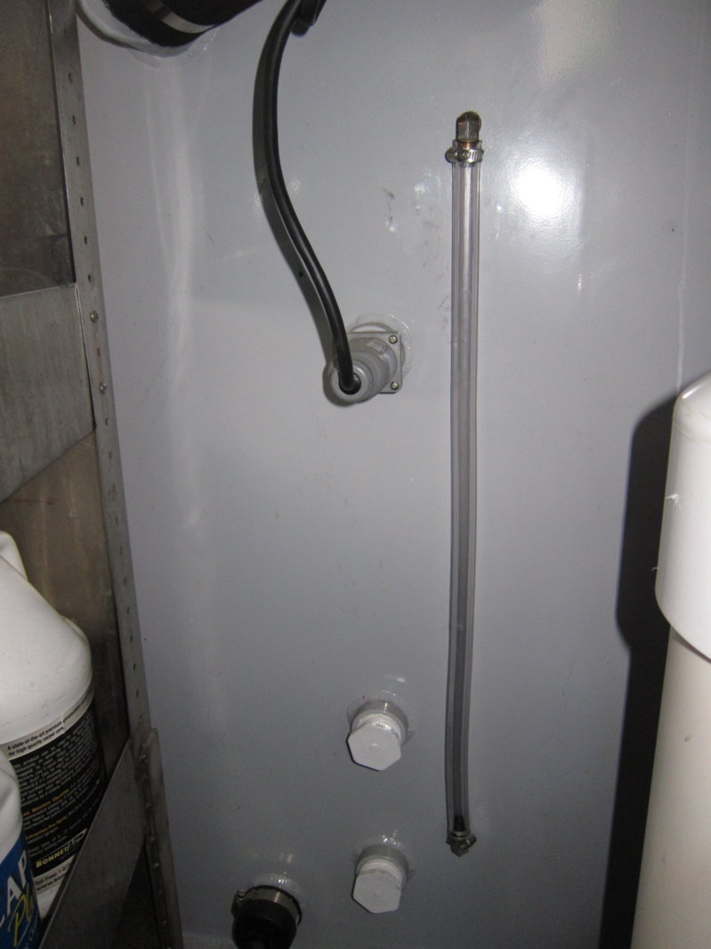

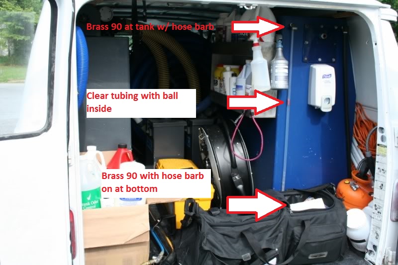

Empty tank, remove dump valve. After measuring, drill hole in top of pipe fitting valve screws into.
Drill similar hole in bottom of top fitting vacuum hose connects to. Insert matching barb fittings into each hole and attach clear tubing and float sight ball.
What do you use for a ball Lee? They are hard to find.
