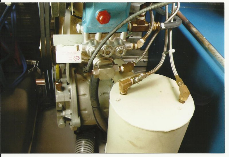

My tech that is in charge of maintenance had a quetion.
We had a RX-20 need some repairs.
During the repairs he was reading that there are regular and high speed units.
Any idea how you tell which is which?
The purpose was for checking / changing gear box oil.
They have different maintenance schedules.
How often do you seasoned guys handle this?

Some if the Hydramaster PDFs have maintenance instructions for both. I could see how that might mix you up. The old low speed units have a lower profile.

Totally different. Low speed is very old and gearbox is mounted sideways. Star heads are different. My buddy has a couple in boneyard.

thanks gentlemen. my tech ask me first thing this morning what the answer was.
thanks for the pictorial Art
