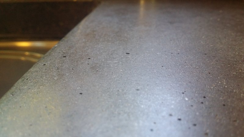

My poured/ upside down concrete countertops needed some etch removal and Monkey Padding.
The more I work them, the more the pours open up and the rougher the surface gets ( in high use areas)
Olsen's calcium remover did a lot of permanent damage, if you recall that gafaw.
While I can get some etching to go away, the 400 grit pad is not aggressive enough. I'm afraid any other method could just make it worse since they are upside down and were never shaken enough to get rid of air bubbles.
Ive heard of densifyers, but am not sure if this situation is what they are intended for...
Thoughts?

densifier will harden the concrete not fill the holes.
saying that i think WOC i did see a product that mixed with slurry to fill micro holes.

For small holes I would consider polyester- use whut and tint as needed- epoxies are going to yellow too much

Make a slurry that matches colors from the concrete and fill it. You can use a grout or an expoxy to fill just like holes in a saturnia. Make it match or make it show your choice. For a counter top I would use an epoxy.

it would look fine if you filled it with a matching grout. Wet it and fill it. Epoxy is a better choice and won't shrink but is harder to use. Match the color and fill it and it will look fine. You could make a slurry of concrete but it's more work and you need to know any colors that were added. Fill it and then sand it. Similar to filling pin holes on bondo.

Do not use grout to fill, use either a concrete patching material or just epoxy if it is too small for the patch.
The densifier is to make the surface harder so it will take a better polish. I have a gallon of SmartKrete densifier from stone pro

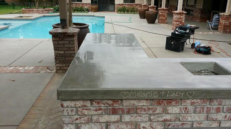

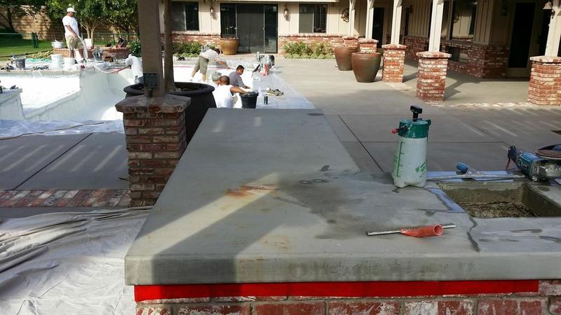

Use diamonds. We have some copper diamonds that you can follow up with resin that will make the concrete really nice.
This BBQ was over 20 years old, we did this in a day with just diamond pads.

we got the pads if you wanna do that. Monkey pads won't do it.
It will etch still, but other than that it's actually really durable

Excerpt from an article I wrote on densifiers. Basically they react with any unreacted calcium still present in the concrete. This fills micro holes and small capillaries making the surface smoother and harder. Densifying will not fill larger holes or voids.
